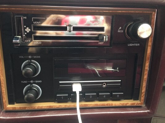

I've got an older Retrosound Newport in my Regal. I had no car audio/electrical experience at the time, so I did have a shop install it. From what I remember, there was very little difficulty with the install. I did buy the universal mounting kit, but I don't think much of it was used. I can dig the box out tomorrow if anybody cares enough. I won't be able to help with the wiring though, as I just realized today my dash speakers are not stock.
I had more pictures handy at one time, but I can't find them now. I can also rip the radio plate off and show the mounts and whatnot if anybody likes.
At the time, the Newport was their only 1.5 DIN, otherwise I would've gone with the New York for the chrome knob rings. Mine would be a "Motor 2B". The picture I've added is pretty old, so I've got an iphone 5C hooked up to it through the cable. I vaugely remember it being a little finicky when operating the phone through the radio. These days, I just use the bluetooth and youtube on my phone for music. I've got a thumb drive in the glove box that's hooked into the remote USB with an album or two on it. Mine has amber or green lighting, but I believe the new ones have more options.
Without a cord sticking out of it, it's very subtle. People who ride in it think it's stock, until I take a phone call through the radio.
I've had it installed since 2016, and it hasn't missed a beat. I run the car all year round as well, so it's also seen -38c and kept on ticking.
I can get better/more specific pictures if anyone likes. Just let me know
