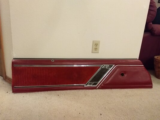

...Now plastic only almost all '78 up 2 door cars will fit. Pontiacs (Grand Prix, LeMans, Grand Am) can supply upper door panels too.
I grabbed a pair of uppers from a '78 Cutlass Salon Brougham (78-80) because they don't kick up at the front like the later versions do. I'm hoping I found the exception to the door panel rule.
