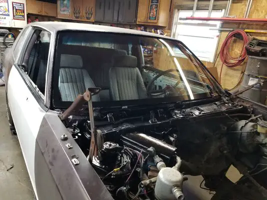

New Windshield is in. The Windshield was gone in this car when i got so i need to get clips for the chrome. This car had a few rusted out metal clips and broken plastic clips in the cowl. Does anyone know which spots get metal clips and which spots get plastic. The kits i found had 4 metal and 12 plastic.
I also got seats out of an ss that are faded but not to bad of shape. The floor was so bad that the nuts where rusted domes so i took a sawzall and cut the floor out to get the front seats. Brought it home and cut the floor off slowly to save the tracks. After some grease and working the tracks back and forth they freed up.. surprisingly the back came out no problem. The seat belt bolts buzzed right out. Going back soon to get the plastic trim and dash/cluster
