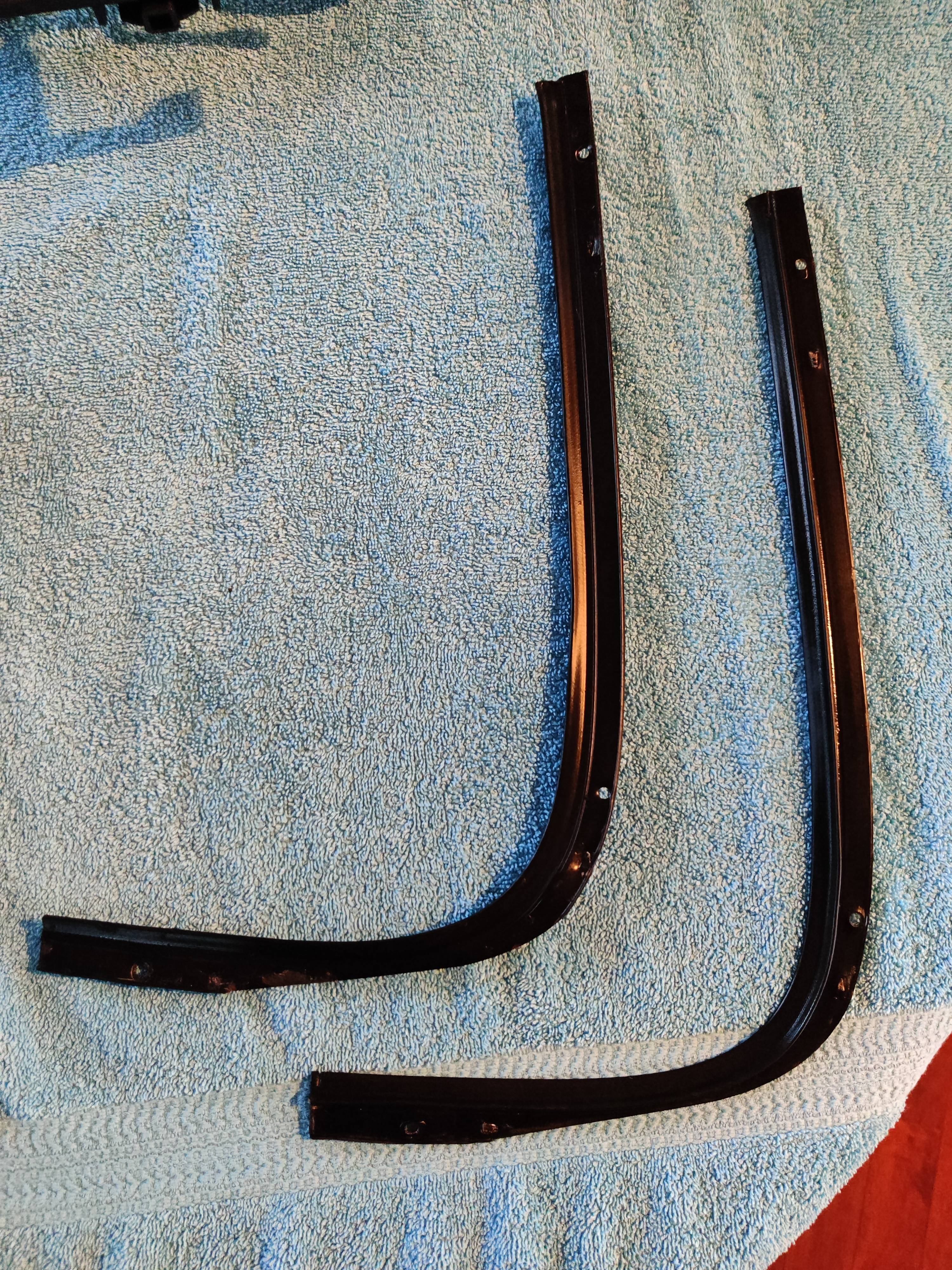

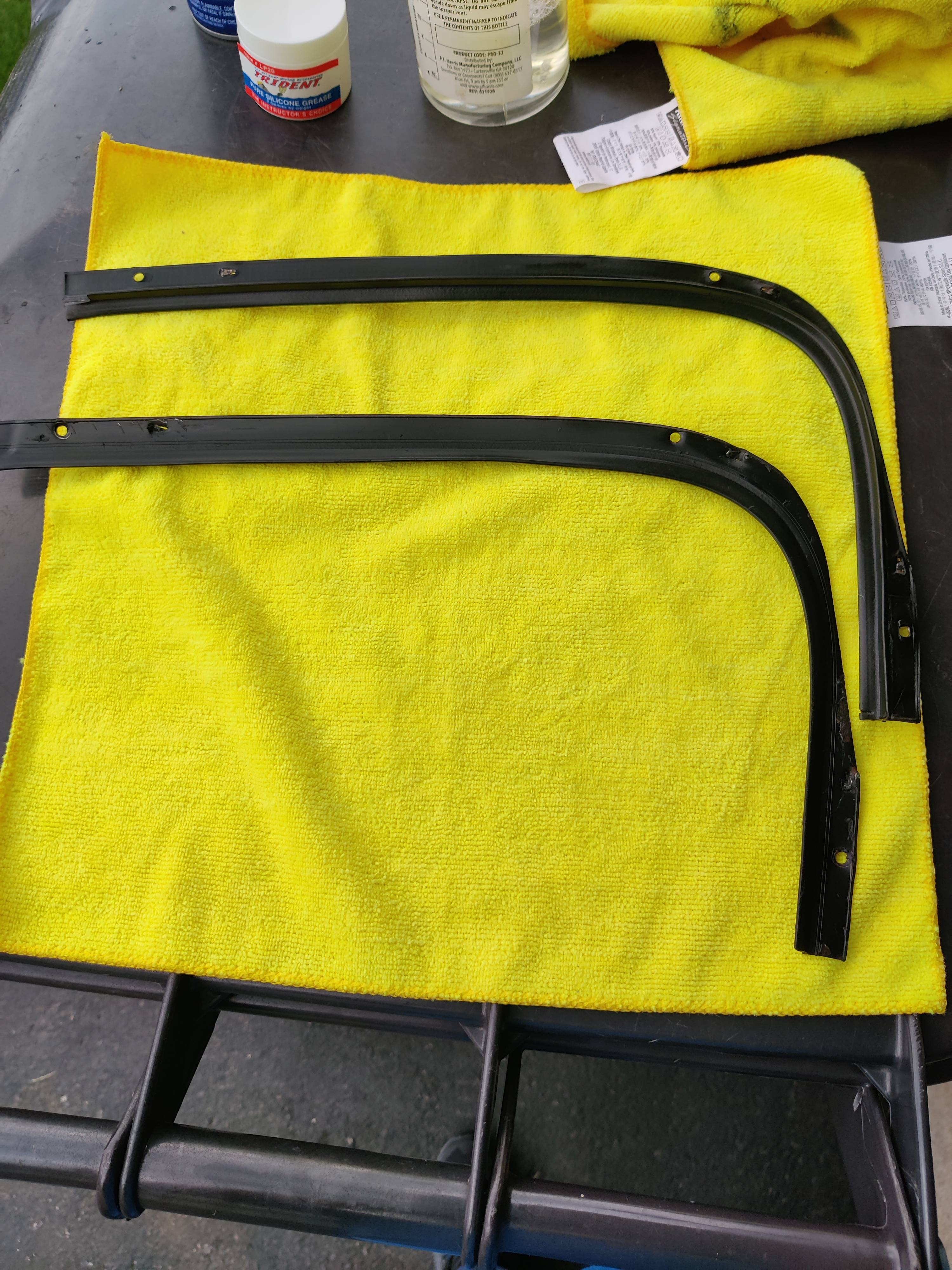

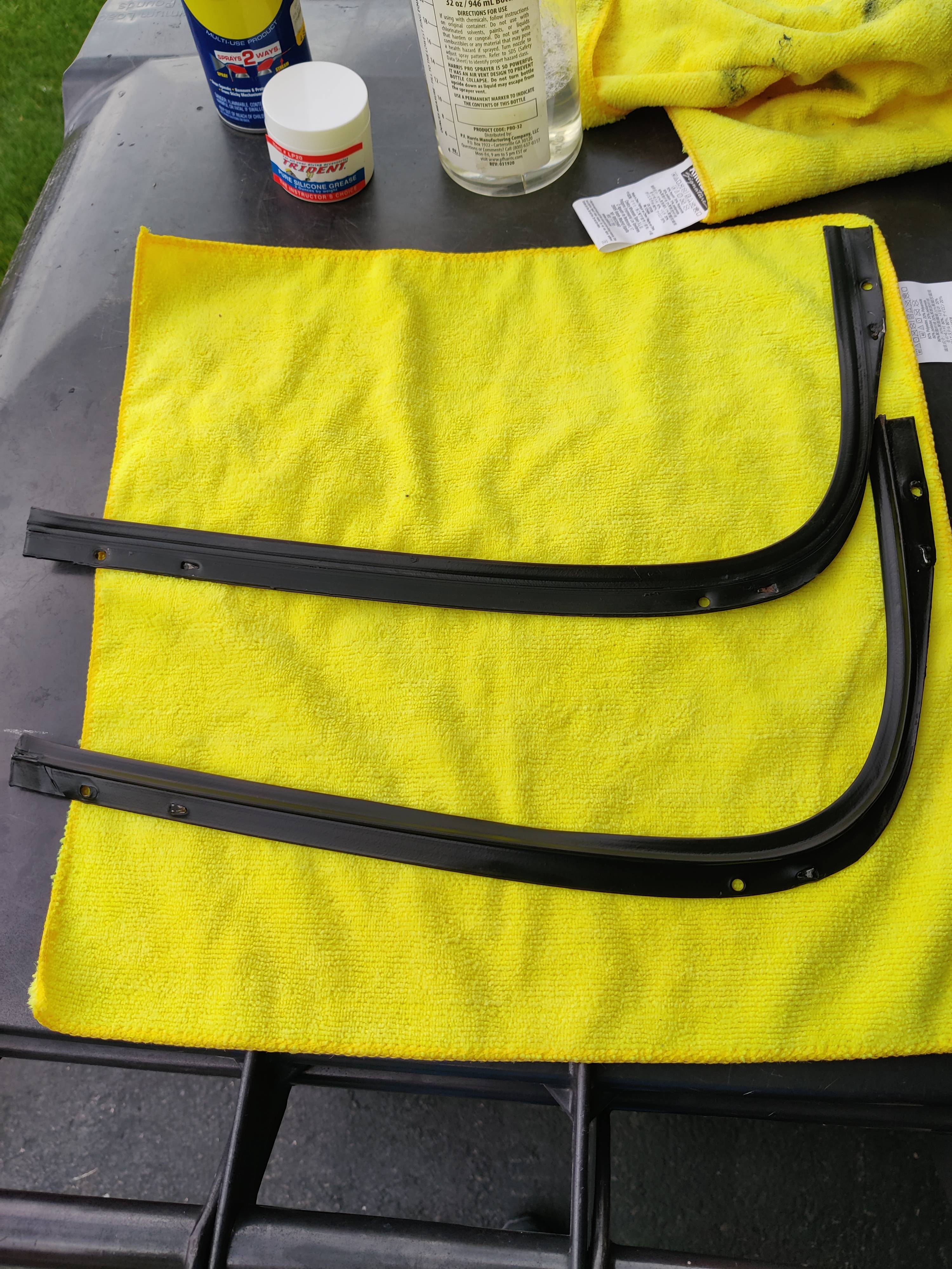

I am not giving up on the alternative options for finding a replacement part that will work but want to let you all know there are still some good OE moldings out there. See the attached pics of the ones I found. Light cleaning and a swipe of silicone brought them back to life. I did have to buy the complete quarter glass assemblies with trim and hardware in order to get them. Hope you all can find the same until alternatives are found. Thanks for all the input and advise. I will refer to this tutorial when I replace these on my car. Thanks again.

You’re very welcome. Glad to hear you found some good originals to work with, that’s what I was fortunate enough to have done as well. Hopefully the aftermarket will step up and start reproducing these soon.
