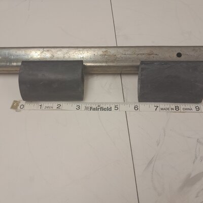

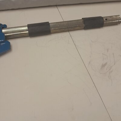

where does the lug wrench go
Taking from ELCAM picture of the "A Coupe & Sedan" the lug wrench is attached to the stalk of the bumper jack with two 3 inch long rubber sleeves. Number 5 in the illustration.
The material reminds me of a heavy duty bicycle inner tube which I have used to make them in the past.
