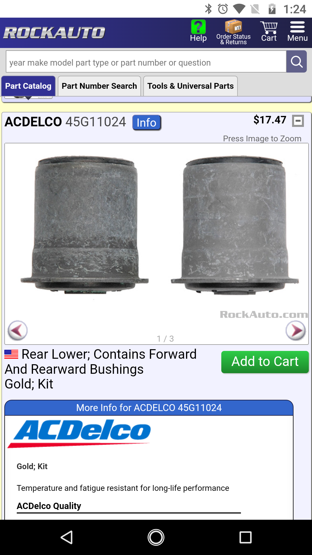

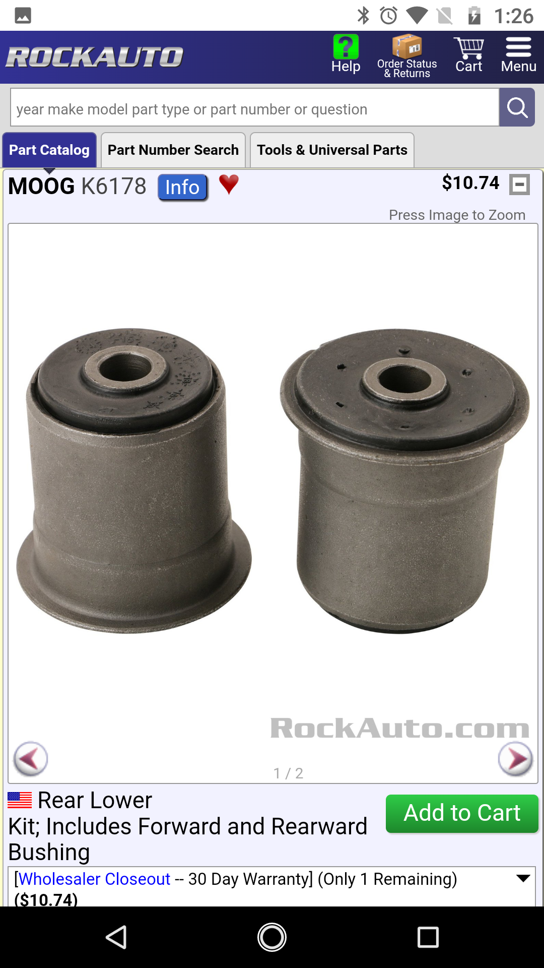

Rock Auto has your rear lower control arm bushings available from AC Delco and Moog. These are for a '94 Trans Am.

i'm checking out the boxed 1s without the bushings aparently they recomend moog "can be used with our polyurethane or stock bushings such as Moog K-6178" which im assuming acdelco 1s will work too. i agree with you out the polys for same reasons i constantly hear. now i dont blow doughnuts or take corners hard so i could maybe give up sway bar for awhile.
