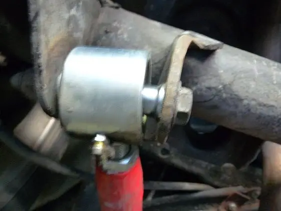

the lowers in your package will not fit the 64 to 67 A body rear

I have the 64 to 67 rear end which is 2.5" wider but the pick up point for the lowers is closer to the center of the rear end compared to a G body. The 68 to 72 rear is 4.5" wider and as far as I know the stock style lowers fit that rear end. The lowers in the 64 to 67 rear need a joint on the axle side to pick up the angle discrepancy. Here is a picture of the 1967 8.2" rear end in my GP with the UMI lower with the Roto joint that they added for my application.

In your ad your lowers come with poly bushing so it is impossible for those lowers to work on the 64 to 67 A body rear. When I was installing the rear I was in contact with another member here who had the 68 to 72, he had no issue with using the stock lowers. When I saw the issue with the stock lowers I contacted UMI who agreed to use tubular lowers and modified one end to fit a Roto joint. I noticed your ad doesn't include the 10 bolt of those years but the 10 bolt 8.2" rear end has the same width as the 12 bolt. I am speaking of personal experience but if you want to dismiss that as an effort to debate you or to cause internet confusion you are mistaken. I was trying to help you out but it appears you missed but I hope this helps others who are installing the 64 to 67, 12 or 10 bolt rear end. I'm curious however if you have personally tested those lowers to fit on the 64 to 67 rear end.
Our kit will fit all the A Body rears regardless of what the carrier size or number of bolts used (8.2", 8.5" 8.875"). We have built thousands of these kits over the years. The lower control arm mount angle on all these model rears are off by 7 degrees or so, even the 68-72. We deal with this issue by removing the factory lower brackets and provide a multi-hole version for adjustable and proper instant angle changes. So yes, our arms do fit this application. We will do a thorough write-up on this swap.
https://gbodyforum.com/threads/g-body-gm-10-12-bolt-swaps-by-southside-machine-performance.70779/
I believe that you might have missed the part that we do not use the factory lower control arm mounts. That might have been miscommunication on my end. We replace them with the proper angle for the G-Body .

you should fix your ad cause there is no mention of the bracket, it is an option to add to the kit with no explanation that I found...don't get me wrong, I like to see the products out there that help us and those brackets are a nice idea. Do you have any instructions on how to line the brackets up on the axle?
