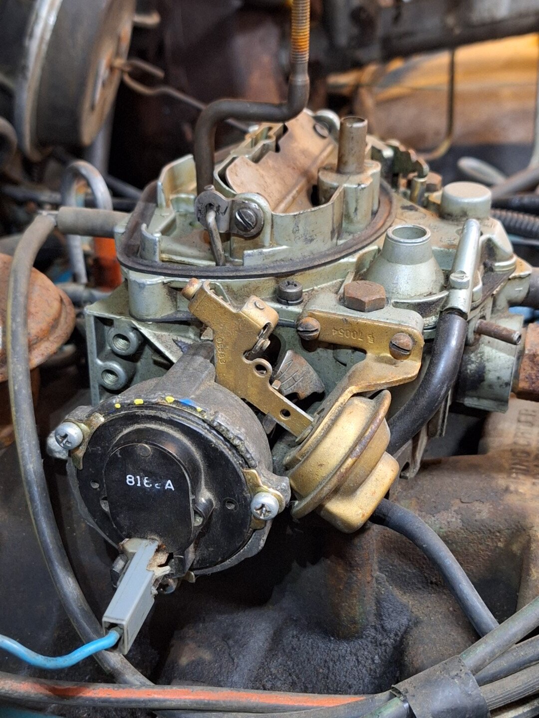

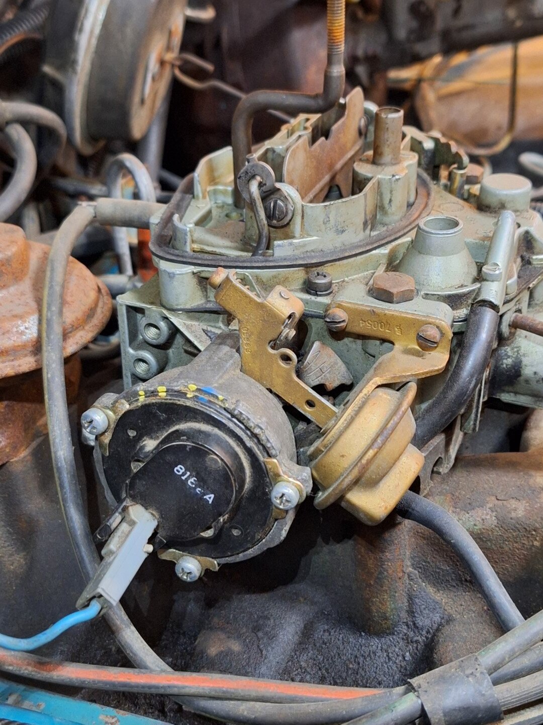

Only had about 15-20 minutes today to work on things. I put some markings on the choke before I adjusted it. I then rotated counter-clockwise and felt light spring tension. The choke's original position was basically at the end of the spring tension...so basically no tension. I did this while getting someone else to hold the throttle at around 50%. This was done with the vehicle off, ignition off, etc. You can see from the photos below that I moved it quite a bit. I tightened everything down and tried to start the vehicle. No change, same multiple-crank sequence needed to get the car running.
I then loosened the clutch while idling with no throttle engaged. Turned the choke back and forth to see if I could hear any difference in the idle, couldn't hear anything. So I rotated the choke back to its original position (left photo) and tightened everything back down.

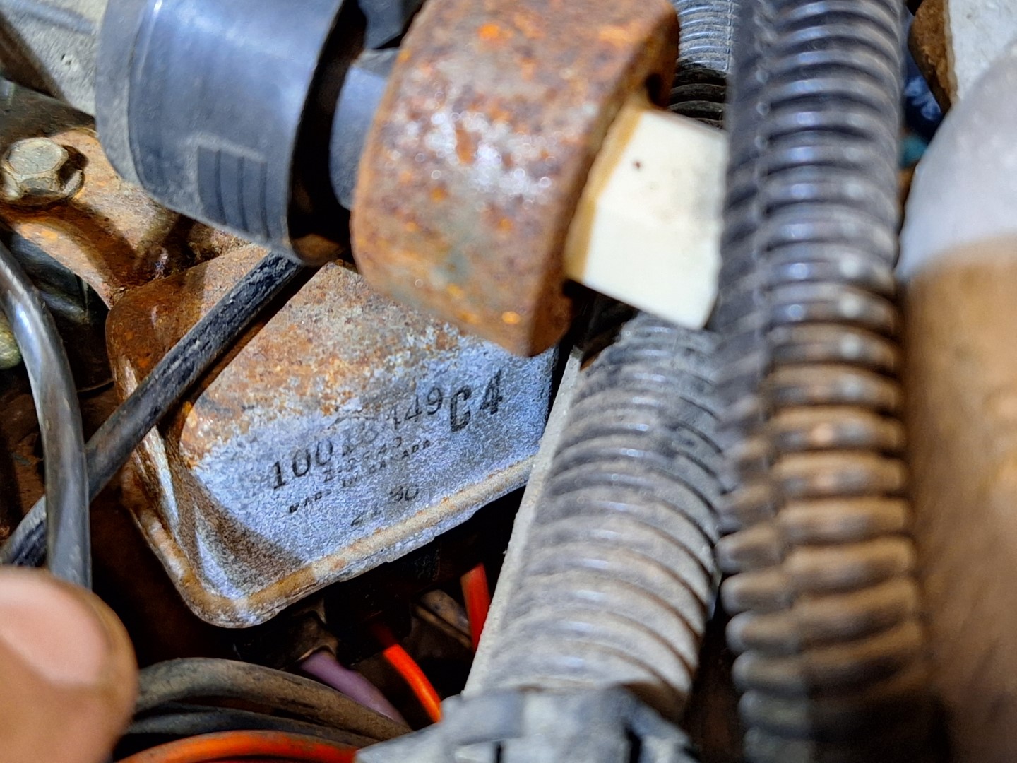

As a side note, the vehicle seems to have now developed a permanent charge/battery light. Never had this issue before. I keep the battery on a 0.5 amp trickle charger most of the time cause the vehicle isn't driven much right now. Don't think that'll cause any issues. The only other work I've done since the last time the vehicle was started is (1) replaced the blower motor, which now works without squealing, (2) remove, clean, and replaced the fan speed adjustment switch, and (3) giving a few hammer taps to the blower motor relay on the side of the airbox where the motor is. Was having an issue where specifically the high fan speed wouldn't work and figured out it was probably the relay in the picture below, so I unmounted it, left it plugged in, gave it a few taps with a small trim hammer, and ta-da, my high fan speed worked again.
The only other thing that's weird is that I started the vehicle today without the airbox, vent tubes, etc. But I'm hoping that doesn't affect my charging system in any way, or else I clearly don't know anything about these vehicles. I checked the voltage on the battery when it was running and it read 12.45v to 12.43v, it didn't seem to be consistently decreasing. I do not know what the output voltage of these alternators is supposed to be...I assume 13.6v to 14.2v or something like that? I tried back-probing the largest red-wired connector on the rear of the alternator, and the other side of the multimeter went on the (-) post of my battery, and it also read the same ~12.45v. I don't think my alternator welt from perfectly fine to dead overnight, not driving it. So I assume there's some sort of relay or connection that's a bit messed up and isn't allowing the vehicle to charge from the alternator? Does anyone know the specific criteria for the charge/battery light to be on? Is it as simple as "if voltage under X, turn on light", or is there more to it?

What temperature were you working in? If at room temperature the choke will barely come on, like you are saying. If near or below freezing, it should have pretty good tension. It needs to completely close tight, isn't in that picture. Your carb will have a very lean calibration. Sounds like it may be bleeding back to the tank and or the fuel pump is getting weak. It may be the well plugs or even the needle and seat as mentioned as well. Our Winter formula of gas is more volatile, changes in October to allow better starting and running in -40. It may very well evaporate easier as well. No your alternator isn't charging. Is there a dash light on? If that little bulb burns out, it stops charging, pretty stupid, I know.

Rotating the electric choke adjusts the length of time its applied. CCW keeps the choke on longer, CW shortens the time the choke is on. The choke should be set with the fast idle cam on its highest step.

In terms of the alternator issue, yeah I did some research and it seems these alternators are supposed to be over 14v when running, so mine is not currently charging. The "CHARGE" light with the battery symbol is on as soon as I turn the key to IGN, and then stays on when the vehicle is running. This might sound stupid to ask about a car designed almost 50 years ago, but is there any kind of sensing technology or voltage regulation where something is telling the alternator not to produce charge if the battery is already full? I am 98% sure there's nothing like that on these cars, but I would feel dumb if there was something and I didn't consider it. I have been working on the car recently (new headlight assemblies, new blower motor, cleaning the fan speed selector switch, tapping the blower relay with a hammer), but none of these should be things that affect the alternator output. As well, starting the vehicle without the air filter box shouldn't affect anything as there are no electrical connections anywhere on it. The last time I started the car before yesterday, Jan 3rd, would have been Dec 31st when I installed the new headlights and switchbacks, to test them. The CHARGE light did not turn on then, and there was nothing out of the ordinary. It seems weird to me that an alternator would go bad just sitting in a heated garage.

Rotating thevelectric choke adjusts the length of time its applied. CCW keeps the choke on longer, CW shortens the time the choke is on. The choke should be set with the faetbidle cam on its highest step.
Thank you for explaining this, I will have to adjust it the next time I actually have a cold temperature start, not just a "hasn't run in a few days" start.

Ok so I did some more testing on the new alternator issue. Fired the car up again, measured the voltage. Around 12.3 to 12.4v so that tells me the issue I had yesterday is repeatable, and the alternator isn't putting out. Decided to try something stupid and give the alternator the ol' Jeremy Clarkson 1-2-3 with a small hammer and boom...14.5v measured across the battery. Checked the charge/battery light, and it's turned off. Wait 7-10 seconds, voltage drops to 13.1 to 13.3v, and then slowly decreases from there down to 12.5v, where I stopped measuring. Checked the charge/battery light and it's back on now. Gave the alternator some more hammer taps, again measured 14.5v across the battery and the charge/battery light turns off. And again, 7-10 seconds later, voltage drops and continues down into the 12.Xv range, charge/battery light is now on again.
So this tells me my alternator is technically capable of proper output. Does anyone who knows the inner workings of these alternators have an ELI5 explanation of what component this could be? If it's as simple as taking the alternator apart and replacing a small part, I can do that. I do live in Canada though, so parts coming in from the US are often prohibitively expensive once you factor in shipping and taxes/duties (like $50 to replace a $10-15 part, but $100 to just replace the whole alternator). I have some options for alternator replacements:

Yeah, the inline pump on a toggle switch may fix the issue. You can just try and replace the voltage regulator in that alternator. The Remy reman are refurbished in Mexico. I got a 100 amp CS130 for my 88 Cutlass. It lasted a year, Canadian Tire couldn't find me replacement. They actually got me a 95 amp 12SI Wilson reman, it was POS, I should have taken it back. Wilson stuff used to be good. If you are planning any sort of stereo or other electrical upgrades, a 95 amp 12SI is a good idea. The 83 and up had the 12SI 95 amp as an option, will bolt right in place of your current alternator. You car probably has a 63 amp 10SI. They don't cool as well or last a long time when upgraded to higher amp output. Most aftermarket chrome alternators are based on the inferior 10SI case.
