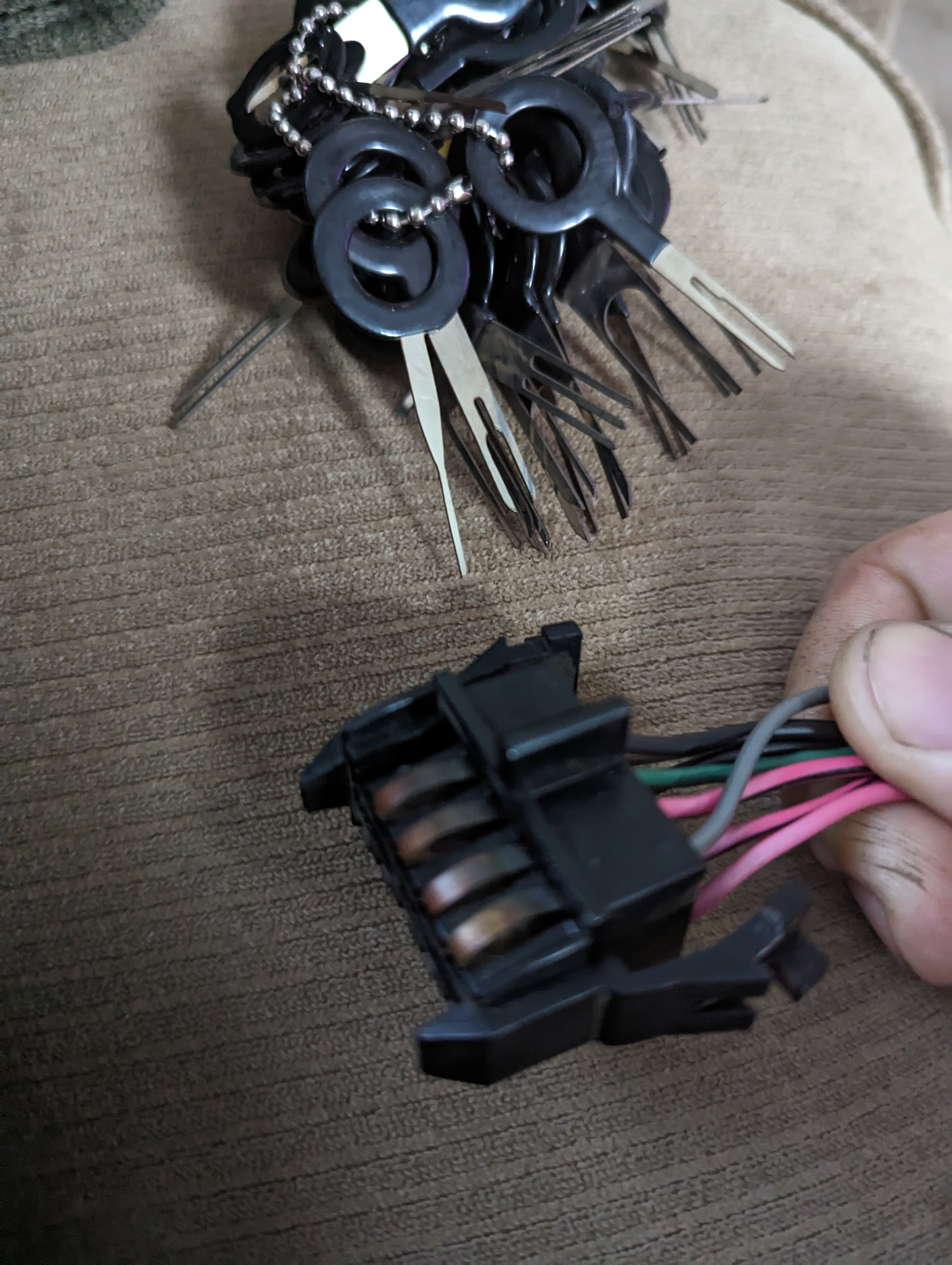

My depinning set showed up today. Who has depinned the gauge cluster connectors? I'm 15 minutes in & not having any luck. Before I break something...

Gently just push down the middle between the connectors center wall & the terminal until you fill the lock tang. Slowly add pressure to disengage/flatten the tang. You might have to move the wire slightly to allow the tang to be disengaged.

It took ten seconds once I knew what I was doing. Thanks all..
