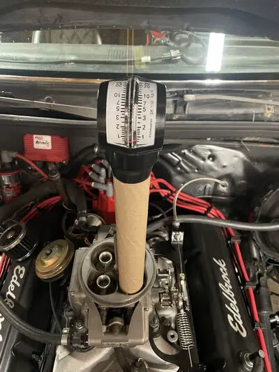

Don't mind my sweet paper towel tube adapter, the atomic has the venturies up higher than most EFI set ups so I had to notch the cardboard to make it seal properly.

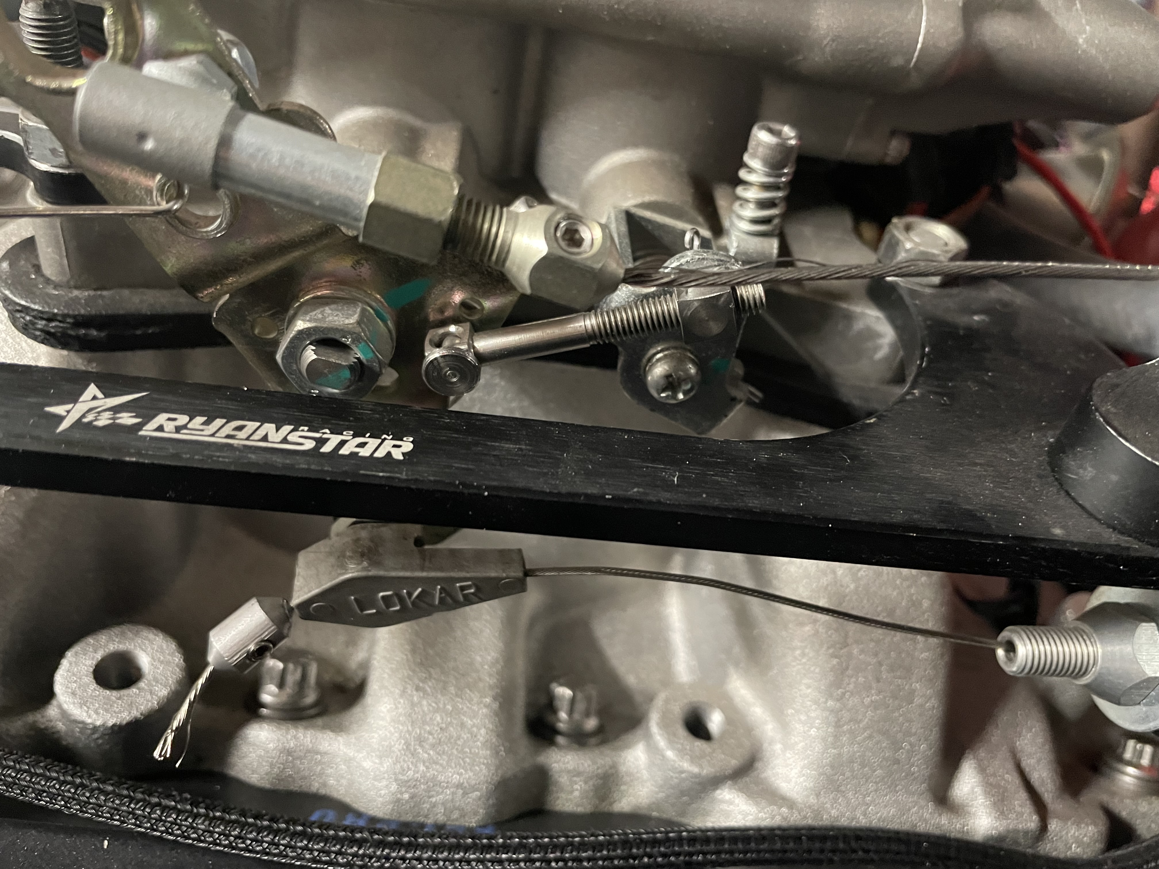

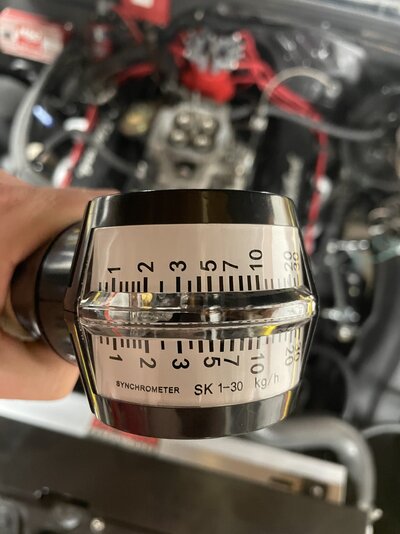

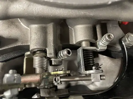

First up we disconnected the linkage between the two blades and got the car running and ideling as close to our idle rpm goal as possible. Then we started measuring front and rear flow with the gauge to get them both to have the same flow reading. Once they were synched we adjusted the linkage to slip in and called it a day.
If you are have one of these efi set ups I would highly encourage you to spend the $40 on a simple tool. Both of our cars have a much more stable idle and IAC values. Tip in on the throttle had a noticeable difference taking off from a stop
