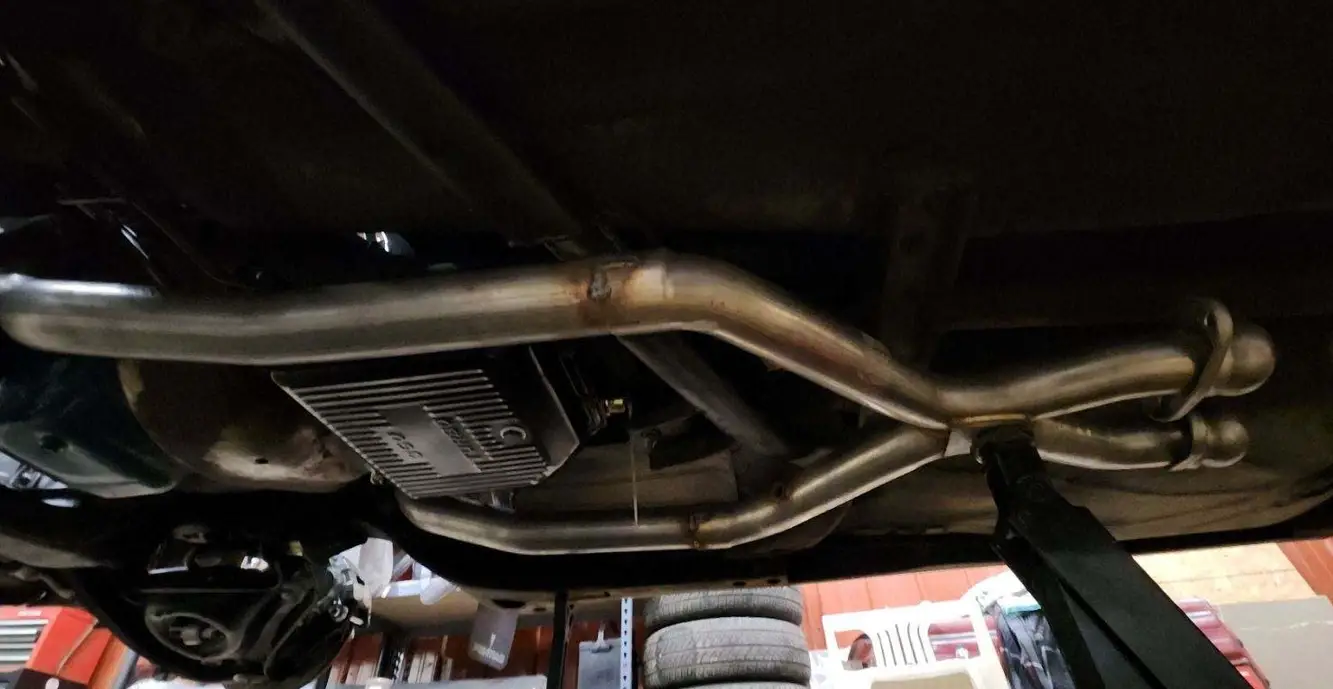

I used factory manifolds & TA downpipes & it worked out perfectly. Tailpipes from Mandrel Bending Solutions, Thrush welded mufflers & my buddy's Pypes x-pipe. The exhaust will be done this weekend.
Thanks MrSony for the advice & answers to my questions along the way.

I've got hooker headers, and 2.5 duals with thrush welded and MBS tails too. I've got a TA_310 cam so it's quite choppy. Excited to hear yours.

Those are nice looking down pipes, what diameter? I am also for any different motor swaps in cars. Haven't had much to do with the small bore Buick and Pontiac 350's. I have only driven one Buick 350 car, a Lesabre from 1980, the last year offered. I remember my old boss saying they were shitty engines when it came in the shop. My other boss had issues with his rebuilt Buick 455 and low oil pressure. Pretty sure a new TA front cover and oil pump would have fixed it.
