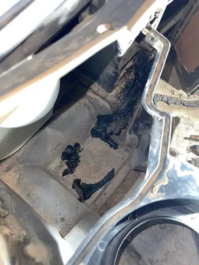

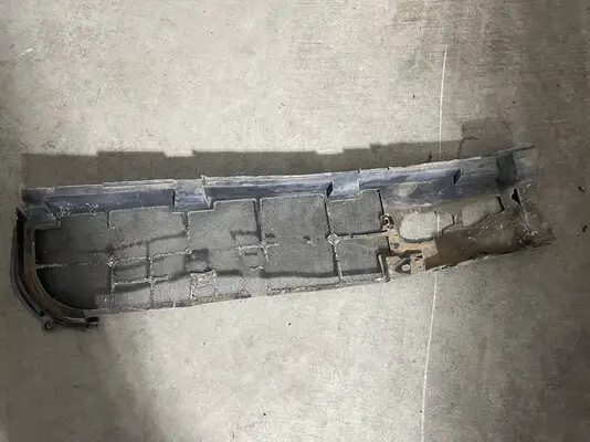

what is the name to this screen that goes on the passenger side where the wiper is at top of heater core. I want to replace it with a new the sun ate this all up . 87 Buick regal

Use a shop vac and clean out any leaves and crap that's fallen in there too. Make sure the drain isn't clogged either.

I vac out all the dust and debris but didn’t know there a drain I must go back and go through it again
It's a little flap. Make sure it opens and closes. If not eventually youe floor qill.get wet and fool you into thinking it's a heater core or windshield problem.
more than that. if your hands are small enough, reach down in there and wipe out the nasty mulch-like residue from all the decomposed leaves, etc, using paper towels. mine had about 0.5"-1" deep yuck

Use 3m strip caulk. Rtv or butyl is too sticky and messy.
