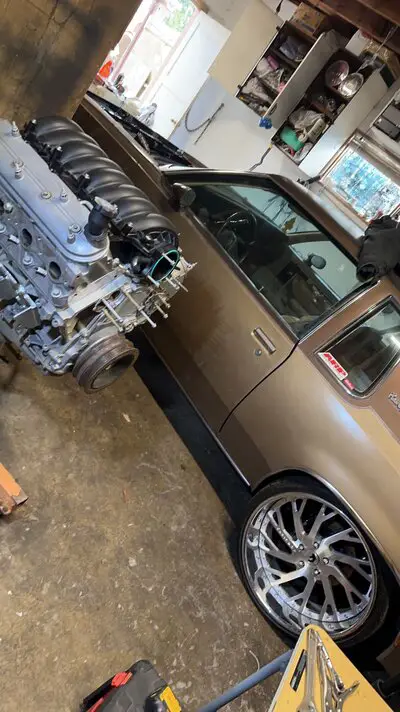

Been working on swapping this 6.0 in my 81 Cutlass. Finally got to the point for me to shop around for headers. Originally was going with Holley blackheart long tubes but turns out they are discontinued and can’t find any.
Any alternatives? I know speed engineering makes a set. Still want to go long tubes.

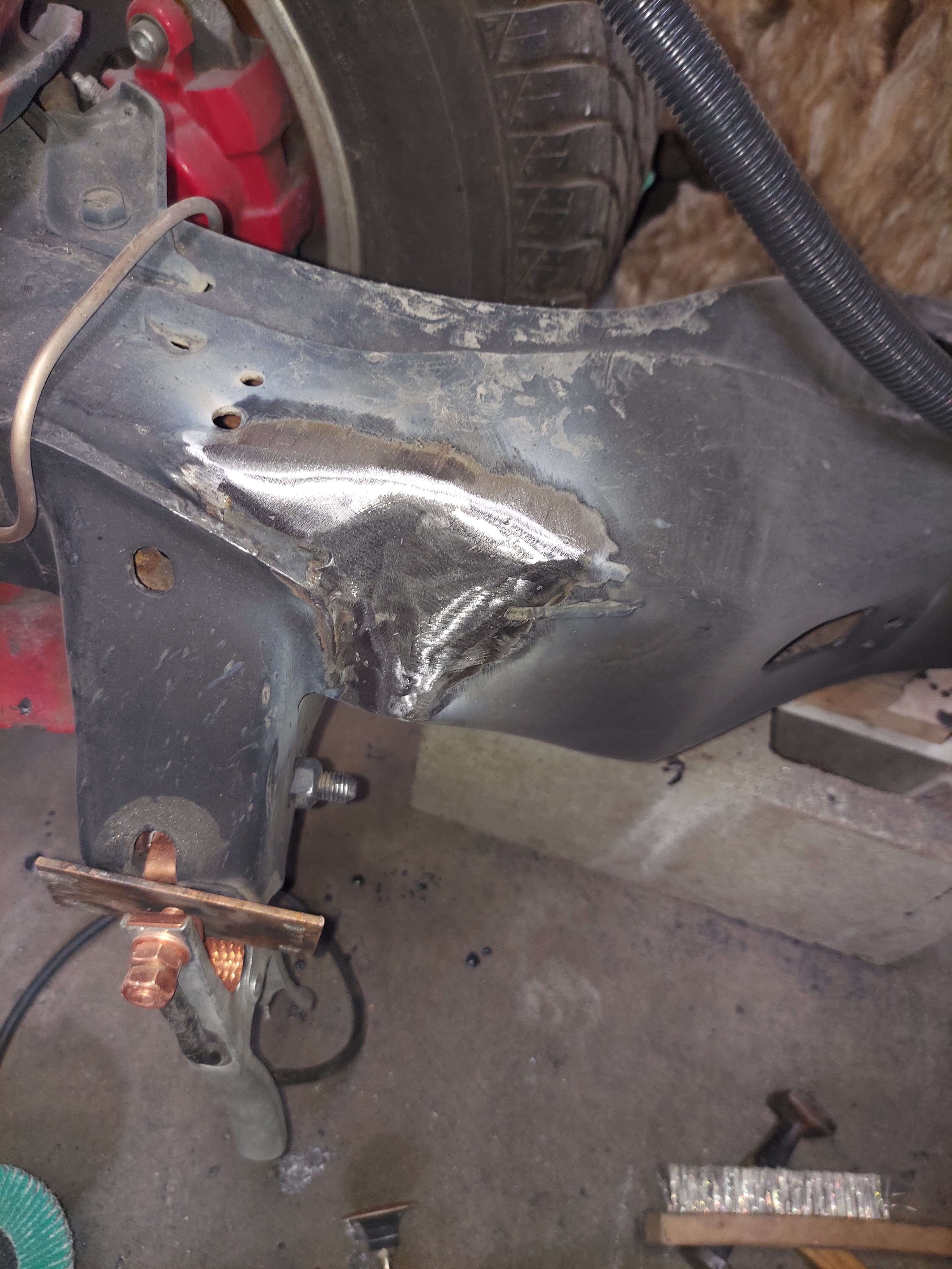

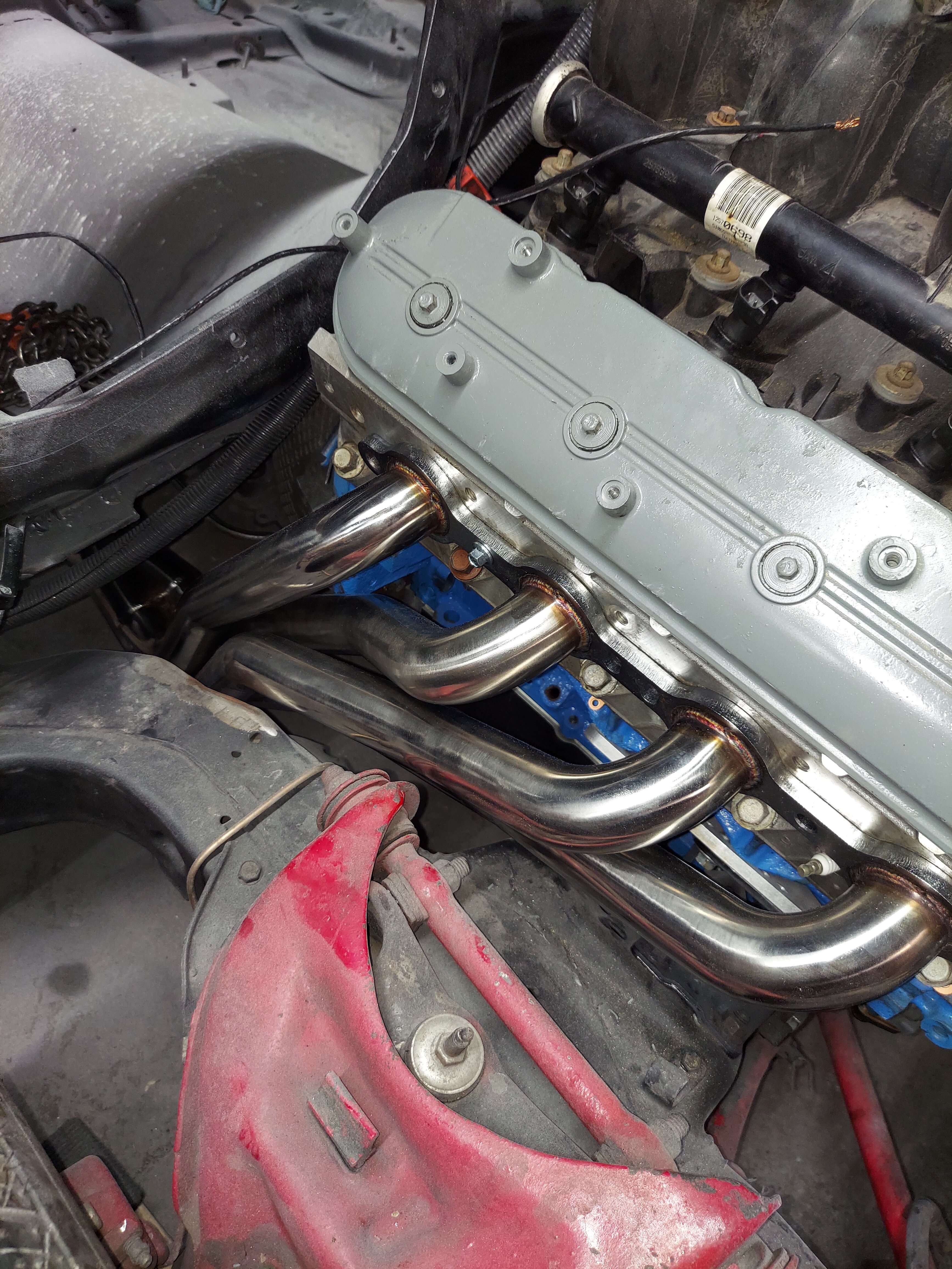

The speed engineering LT headers fit with minor modifications and seem to be high quality. Hard to beat stainless LTs for 400 bucks.
That's basically your only option, except fbody pacesetter headers(which also require similar mods).

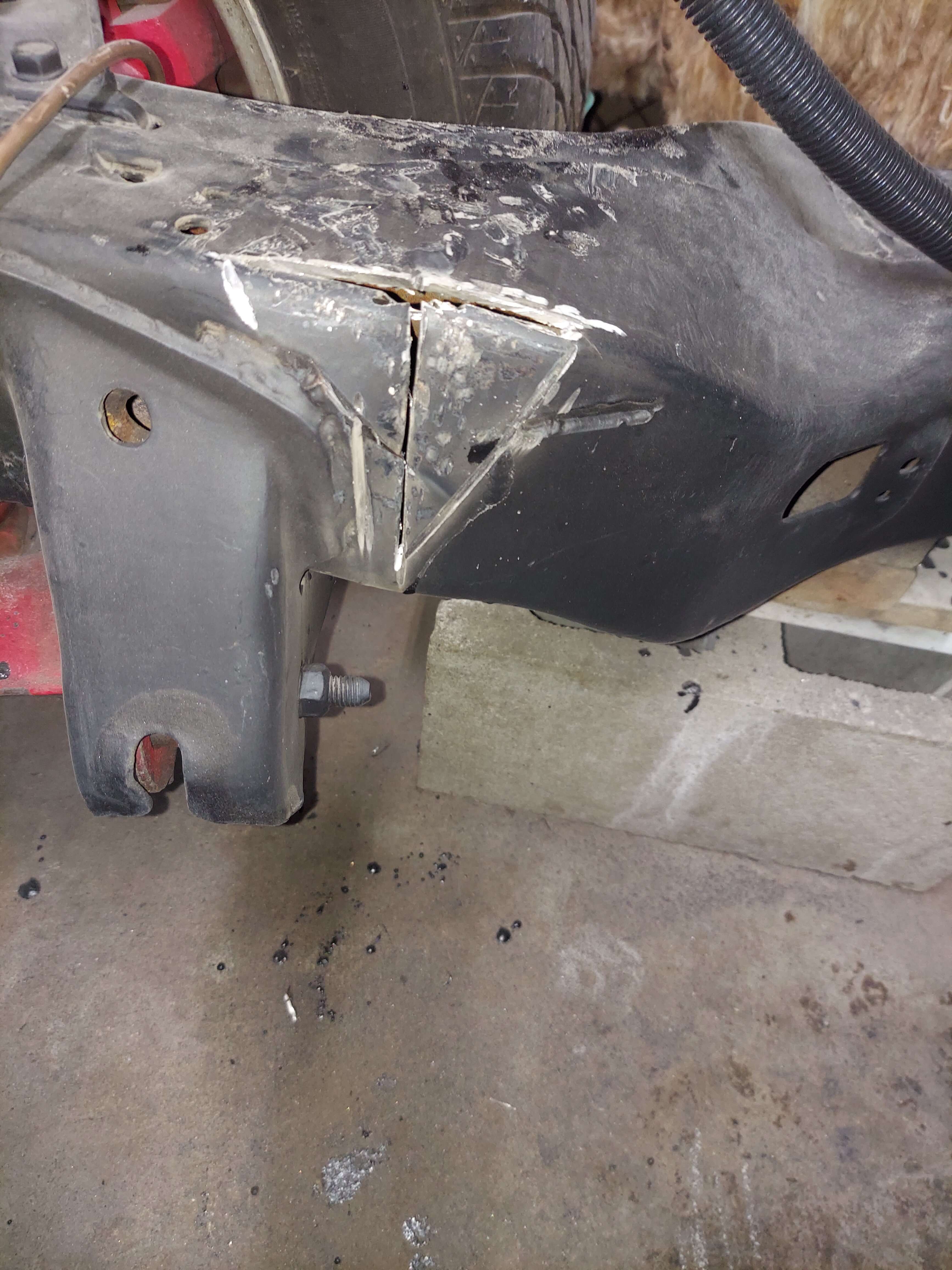

The driver side lower control arm mount needs trimmed up, and the pass side frame rail needs some cut out.
I used ict swap plates. I almost think the spohn/fbody mount setup would clear the passenger side without modifications but im not sure.
If you buy them I'd do the passenger side modification when u pull the old engine out. I clearanced about 3/4"-1" out of the top and beat the sides in. Then I clearanced the driver when everything was installed.
