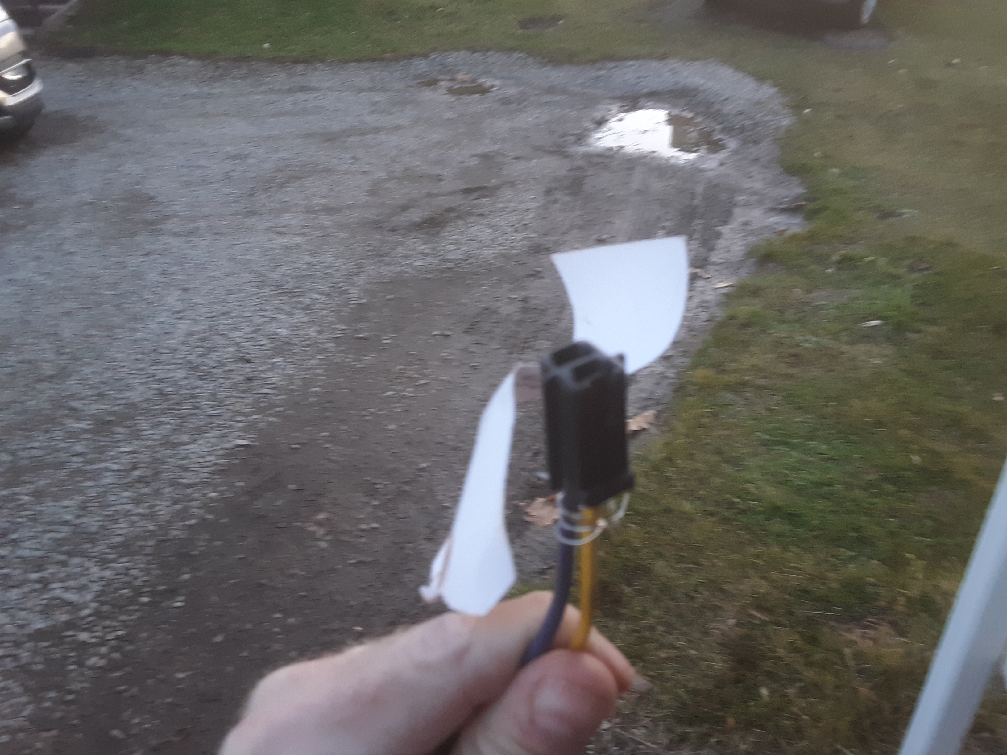

Is anyone with a factory manual trans car able to provide a picture of the wire connector/plug that attaches to the clutch safety switch?

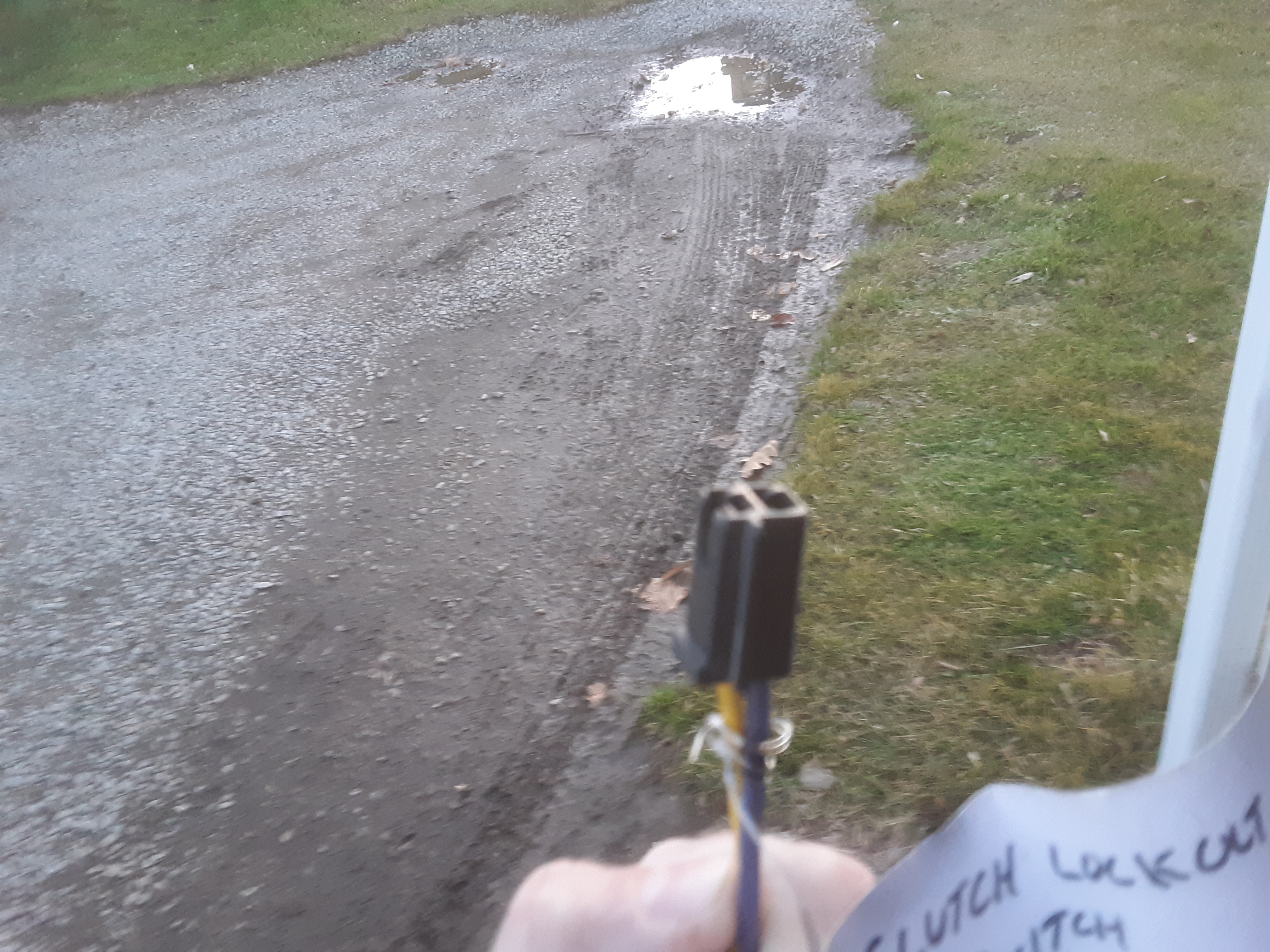

Thanks! According to 1978 Buick Chassis Service Manual the p/n for the plug is 8911921. Now I just need to find one….Not the best here's the one in my harness
View attachment 231454View attachment 231455View attachment 231456
That might work for him but the p/n I have is 8911921 (discontinued in '90 but some how listed in my search for early OBS trucks up to '94 but that could be wrong info) but about all GM's with a clutch up to the '80's should have it at what ever yard has vintage iron, Certain early Monte/Malibu/El Camino A/G's with automatic & gauges has this connector with a pressed in bus bar completing the circuit. That's what donated the one for Jr.'s planned clutch conversion in the '79.This might be what you are looking for.
