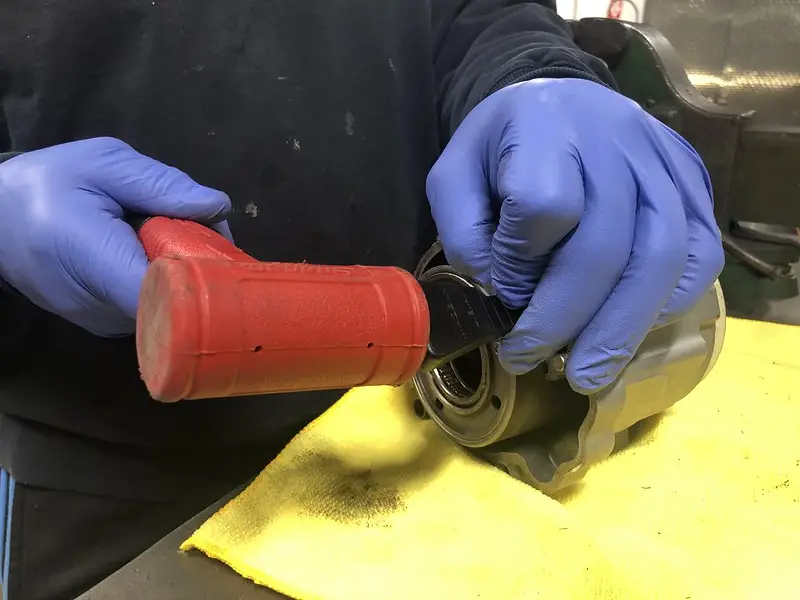

Here's the guy tapping off the fan using the plastic trim removal tool in that slot. Pretty good idea actually.

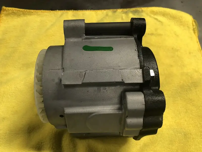

Back at it again on this smog pump. If you look online, typical prices are generally anywhere from 100-200 used, and 200-400 new, depending on make and model.
By cleaning, lubing, assessing, and careful reassembly, the pump rotates nicely with no scraping or chirping. Just as I had hoped. I did NOT have anything to go by as far as torque values for the end cap retainer bolts. Because you're not supposed to disassemble the thing. So I just used the engineering standards for a grade 5 bolt, zinc plated. Landed with 17 lb-ft. clean, no lube. Seems adequate.
During cleaning, I ran the 5/16"-18 thread chaser bit into the rear of the casing, used the bolt thread chaser on the bolts. The front pulley bolts are 6mm fine, and chased those as well. The control valve that bolts to the back has 8mm threads, in case anyone decides they want to tackle this.
Here's the cleaning in progress. Using a soft, rather fine brass brush wheel to knock the oxide off the outside. Didn't want to polish it. But it did need cleaning.
Now, I had to figure out how best to replicate the "FP" stamp and the yellow QC marking splashed on the side of the pump casing. Not 100% sure of the method that the factory used, but whatever it was, it seemed rather random as far as how it looked. Here's 2 examples of OEM smog pumps in place with the FP stamps and yellow splotches.
Took some VHT engine black satin paint, along with some alumablast and satin clear and decided this would be sufficient to give it more of a new look.
Interesting note I found out more about the pumps. The A155 in the rectangle below is the date code for the END PLATE only, not the casing. The build date correlates much like the radiator hoses. A for January, 15 for day of month, and 5 for end digit of the year. So the cap was made January 15, 1985. Which would made the casing stamping of Jan 23, 1985 in that wheelhouse.
NOS GM gasket ready for the control valve.
Nothing like getting a rubber stamp made along with using some "StazOn" ink. This stuff is very good at staying where you stamp it. Waterproof and is good for metal, wood, paper, etc.
Perfect? Nah. Never will be. But I think it's worthy of re-installing on the car.
