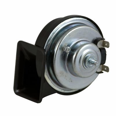

Do I really need a relay for a after market horn and horn button?
Or can I just slice a fuse into the positive wire going to the battery to the horn button?
I got the horn connected with no fuse or relay
Can I just leave it like that or will it catch something on fire lol
Factory horns had relays....
I don't have the factory horn I bought it from autozone
There is already a relay, it should be next to the fuse box. What was wrong with your current horn?
I broke the clip inside the steering wheel where the horn button pin twist
When I change my steering wheel .
So I was thinking about using this method
You could just wire a fuse inline from the battery to the horn if you haven't.
