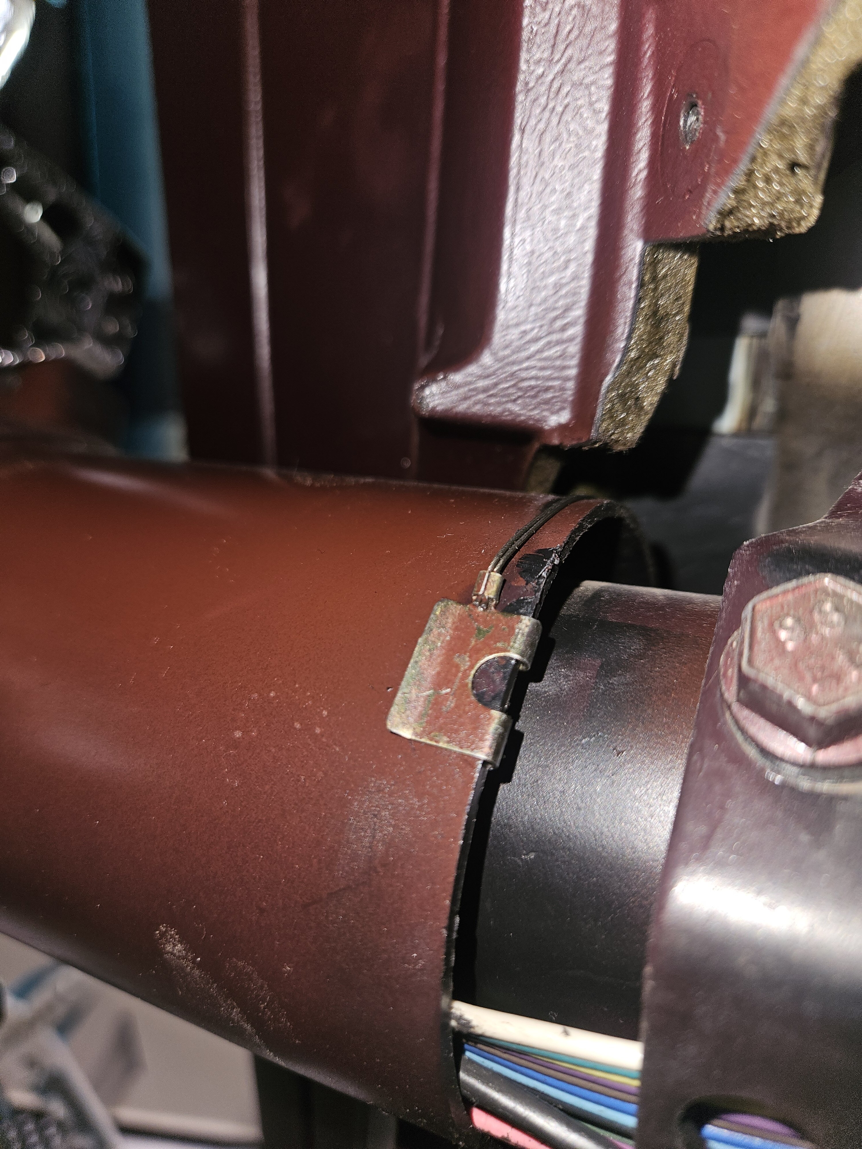

Small things to be grateful for: A manual A/G body means never having to adjust the gear indicator cable clip when you fix the steering column...
