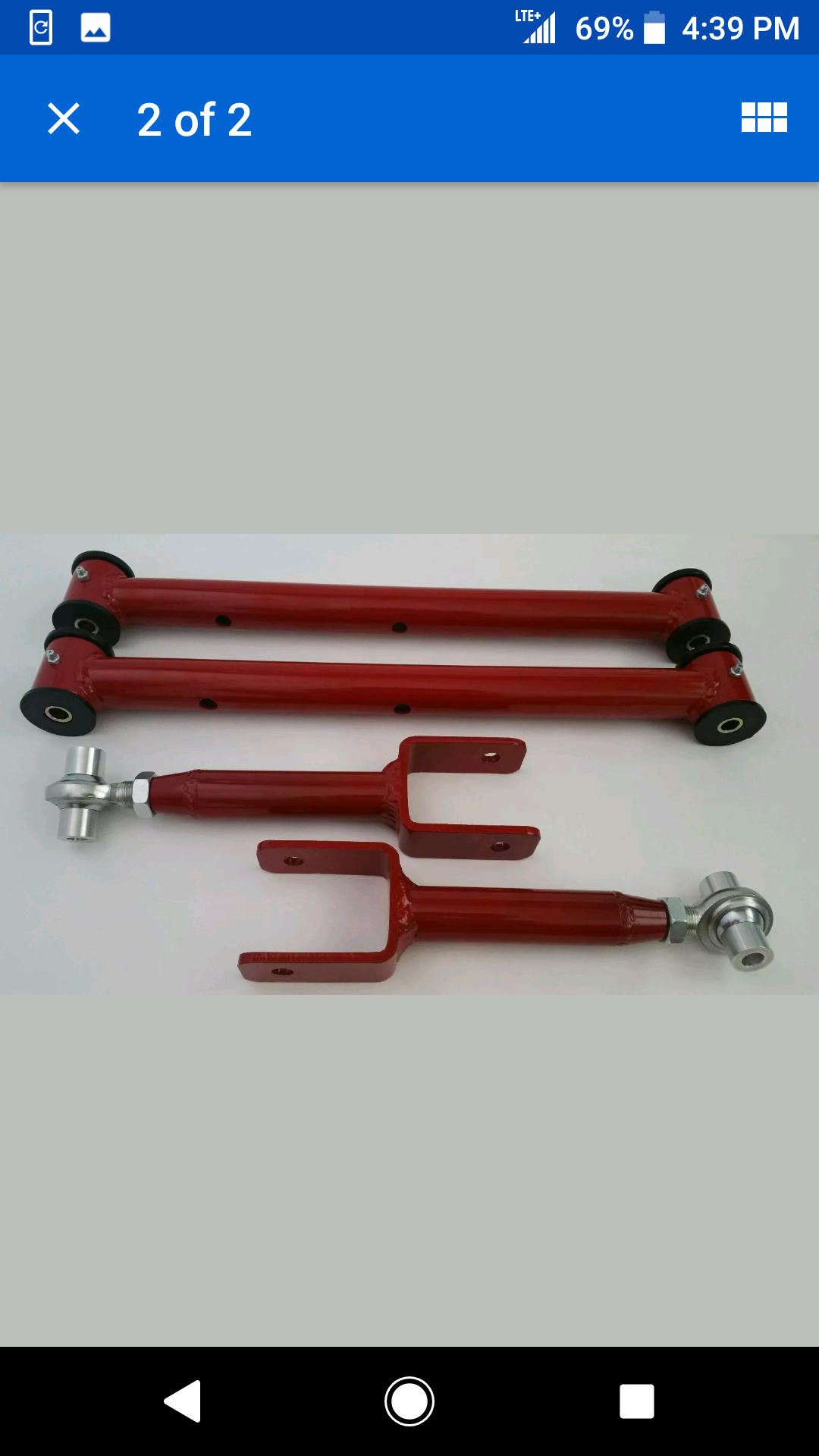

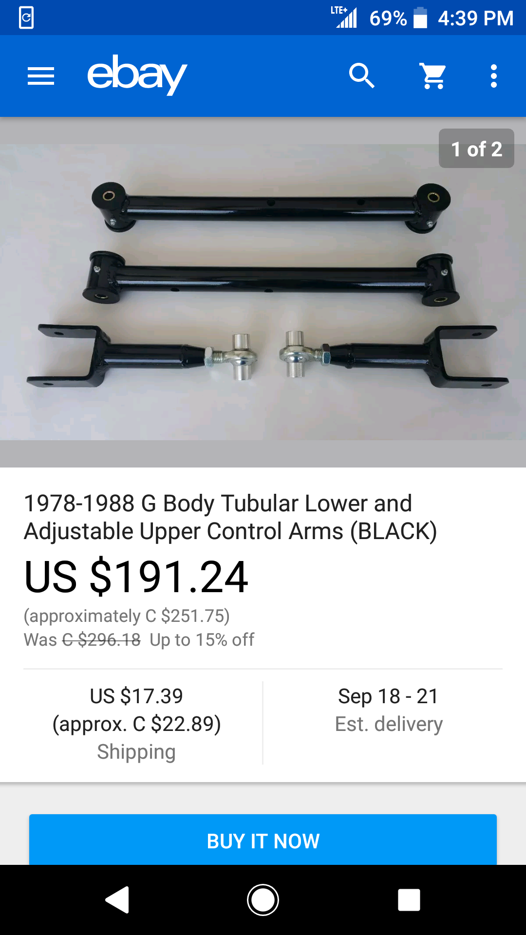

View attachment 95553View attachment 95554
Well for the price they seem ok, Alittle on the weak side if you got some torque.
Sold 45 sets an feedback is 99.4%
I checked out the eBay link. Here is the equivalent item from UMI.
UMI 301517

How much power are you planning on? Boxing yours will help, if your not running a sway bar make provisions before welding. Carefull boxing the uppers so it doesn't interfer with movement. Great time for new bushings.
