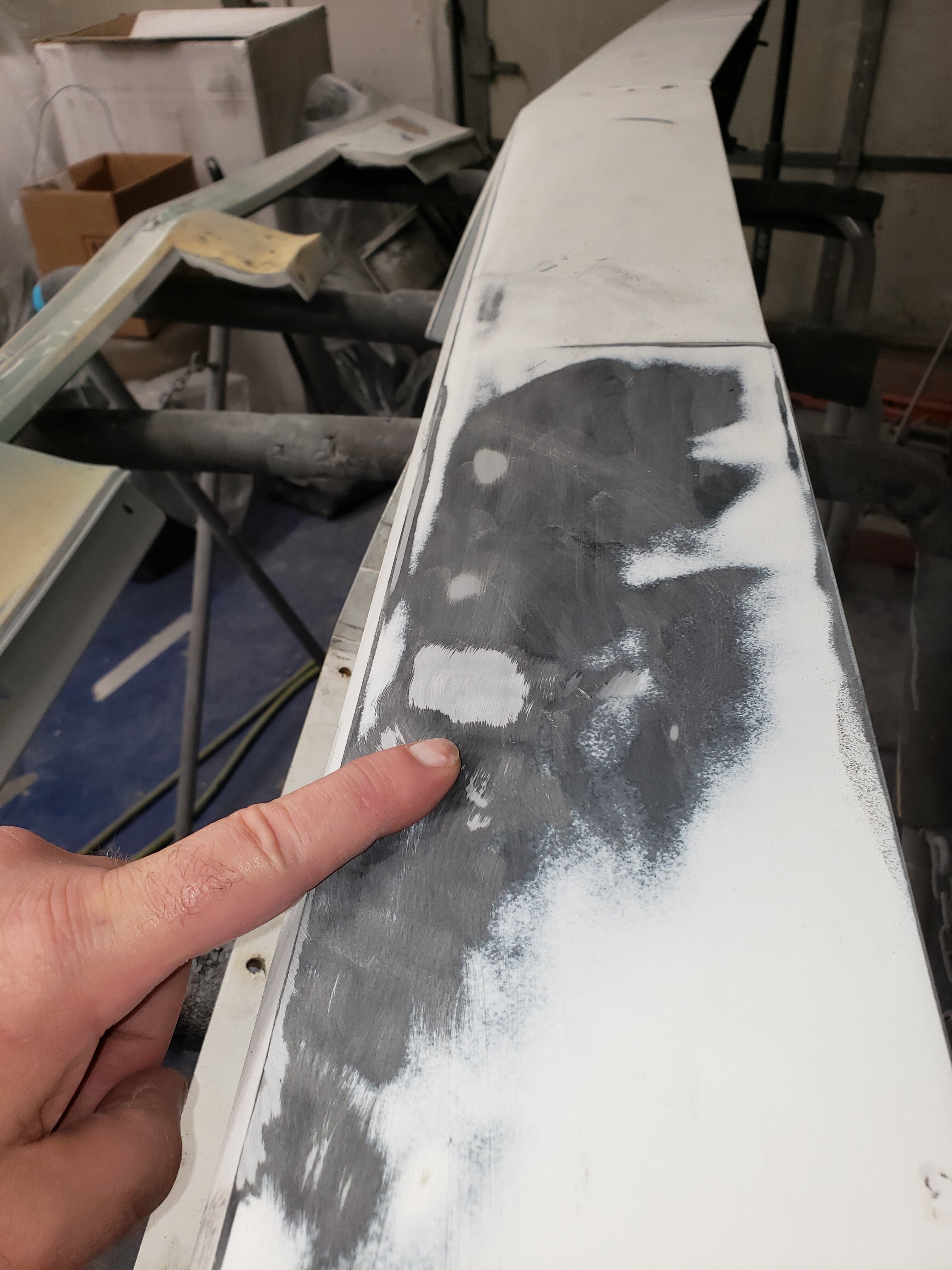

Donovan. The upper plastic around the headlights etc is a much harder plastic. The lower is the flexible stuff. Looking at pictures and I created a small divot in hard plastic. Not huge as I'm pointing to it but definitely feel it. My mistake. So now I'm trying to figure out what I can fill it with. I'm searching but not coming up with definite answers.

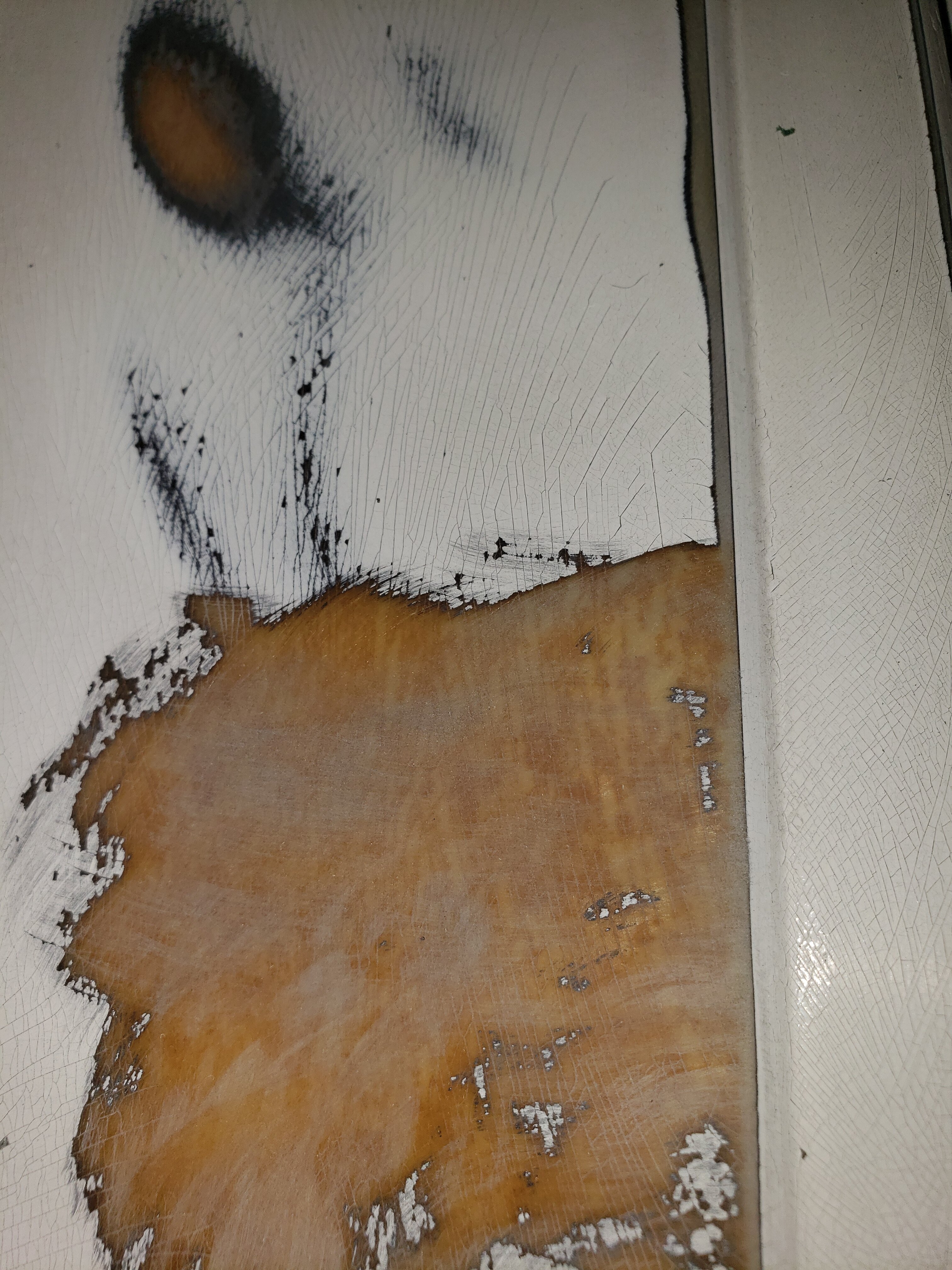

Also if you look where the cracking was after I removed paint you can still see cracks in bare plastic. Is there something I can use for both as filler? I have 2 part 3m glaze but it doesn'tspecifyuse on plastic View attachment 229189 View attachment 229190 View attachment 229191

The guys above have it right, all their suggestions and comments are spot on. To answer your specific question about your plastic repair, you’re going to have to try and determine what type of plastic it is if you can. As noted above, Lord, Fusor and 3M all make plastic repair compounds, and each manufacturer will have different compounds for different applications. As I’ve mentioned before, I’m a 3M fan, so the 2 I currently have on hand are these:
The one on the right is compatible with SMC (sheet molded composite) that the header panels on our cars is made with, and the one on the left is supposedly compatible with almost all plastics. I’ve used both successfully in different applications. The one real disadvantage to the universal repair compound on the left is the EXTREMELY short work time. Only 20 seconds. 😮 Others may be different.
That being said, it’s worked well on ABS and other plastics I’ve used it on.
pagrunt ’s description of why the crack outlines are still visible even after the paint has been removed is bang on. I couldn’t have described it better myself. My reasoning for stripping off all the old paint is as he outlined, because of compatibility issues with the base paint which is most likely lacquer. The high solvent content of the new paints will eat into the lacquer paint (which isn’t catalyized by the way) causing reactivity issues if it’s not completely removed first, or insulated with epoxy primer.
