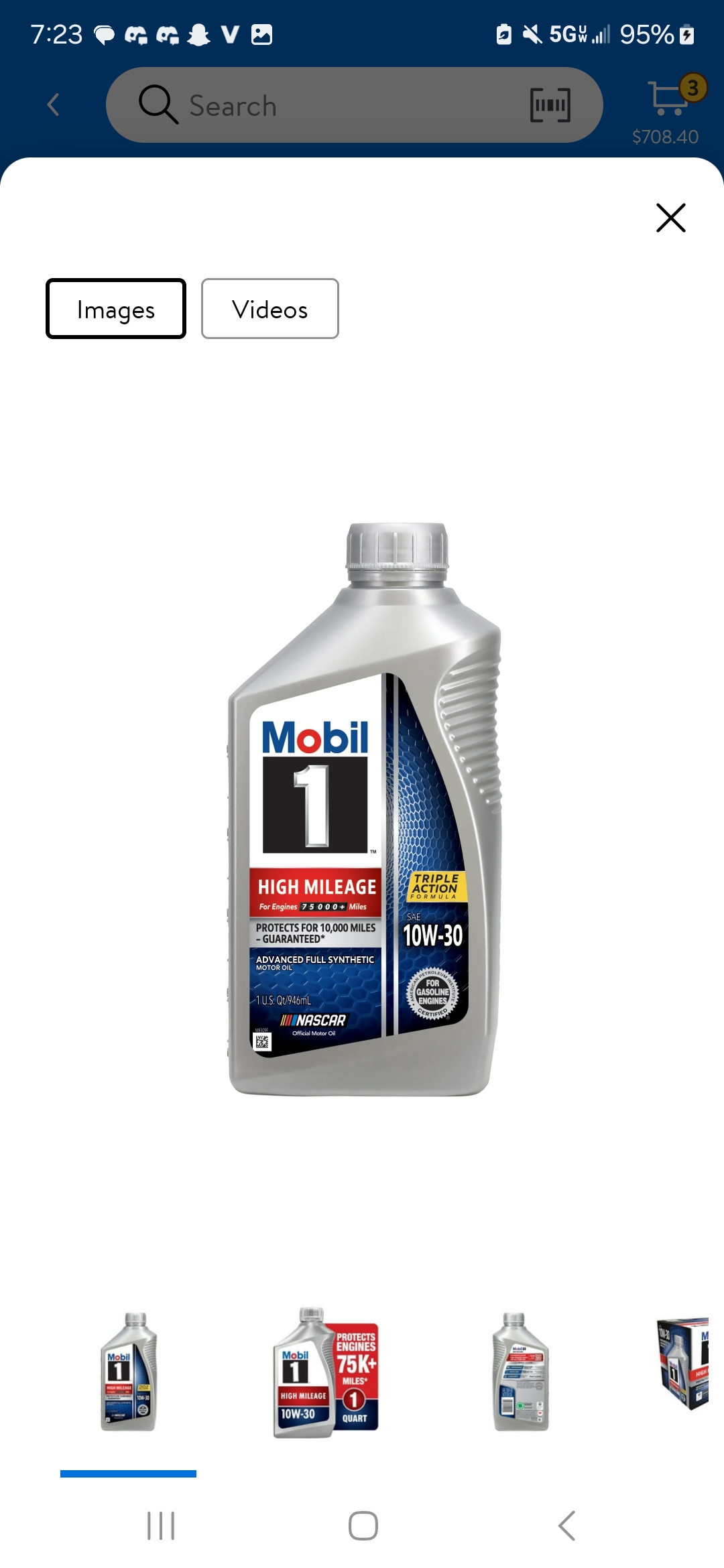

Maybe a hi-mileage oil would be a good suggestion. As for conventional oils made today they are not like what was out there in the '80's. They don't have the needed zinc in them so a zinc additive would be needed regardless unless it's something like Valvoline's racing oil line or vintage car blends.

On the oils back at that time frame and when I was building engines, I only used Quaker State 1040, and of course this was about the time where Amsoil and Mobil 1 were becoming a big thing on the market. There is nothing wrong with running either one of them.
Depending on your temperature in the summer it is where you would worry about it as far as the difference between 30 weight and 40 weight. Because I was in the Chicago area at that time as a mechanic at a Pontiac dealership and then doing my own thing plus the turbo charging I always used 10-40. That's not to say that you have to.
