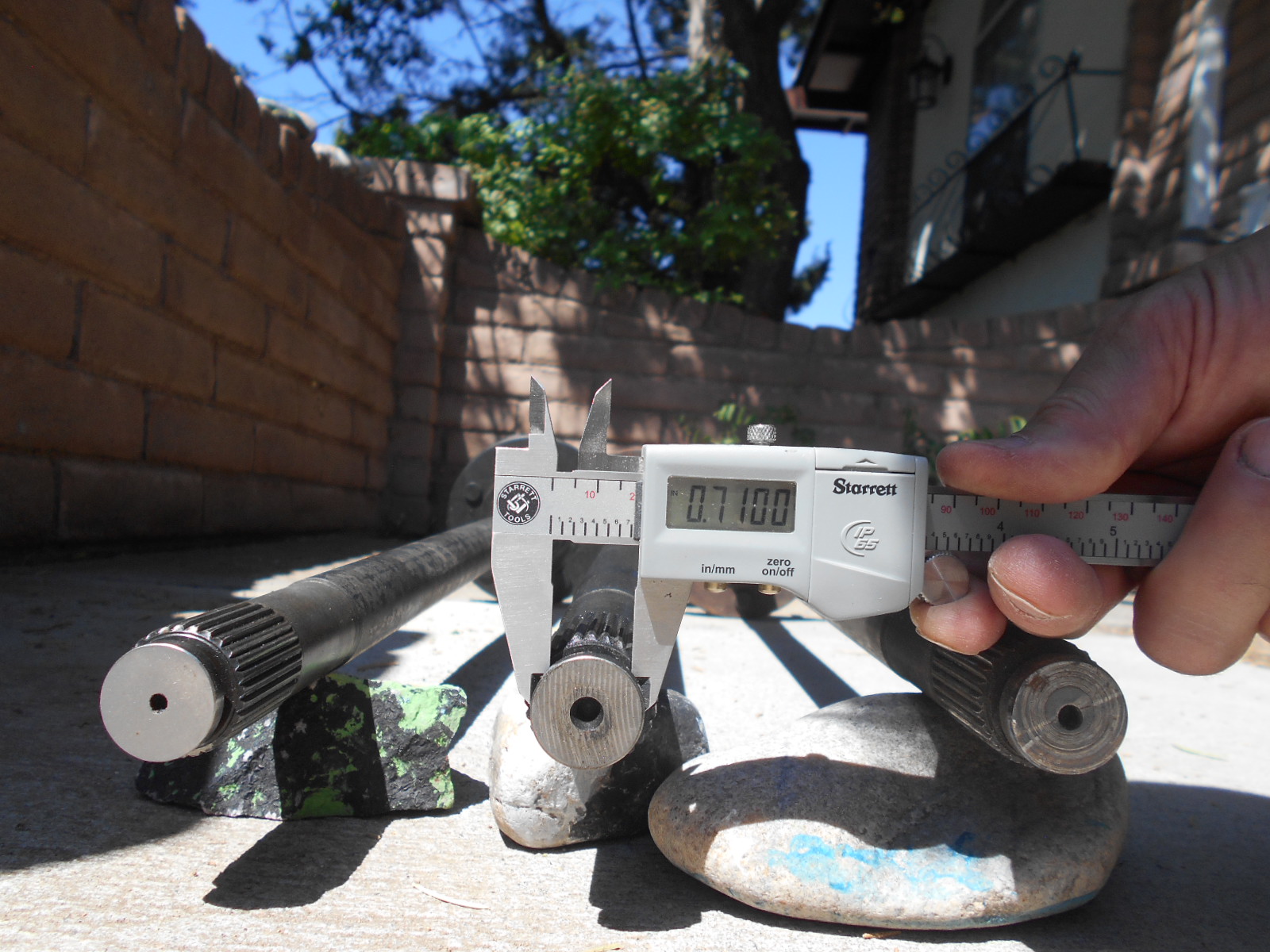

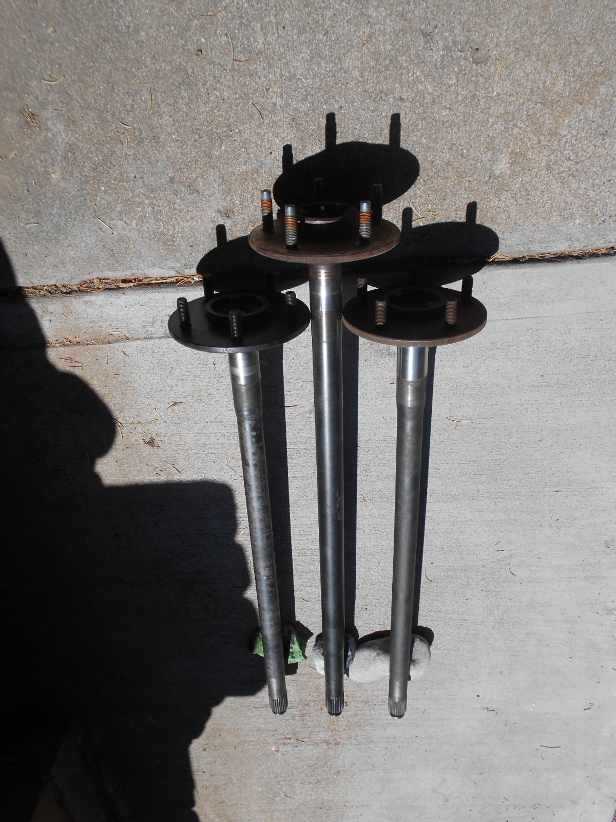

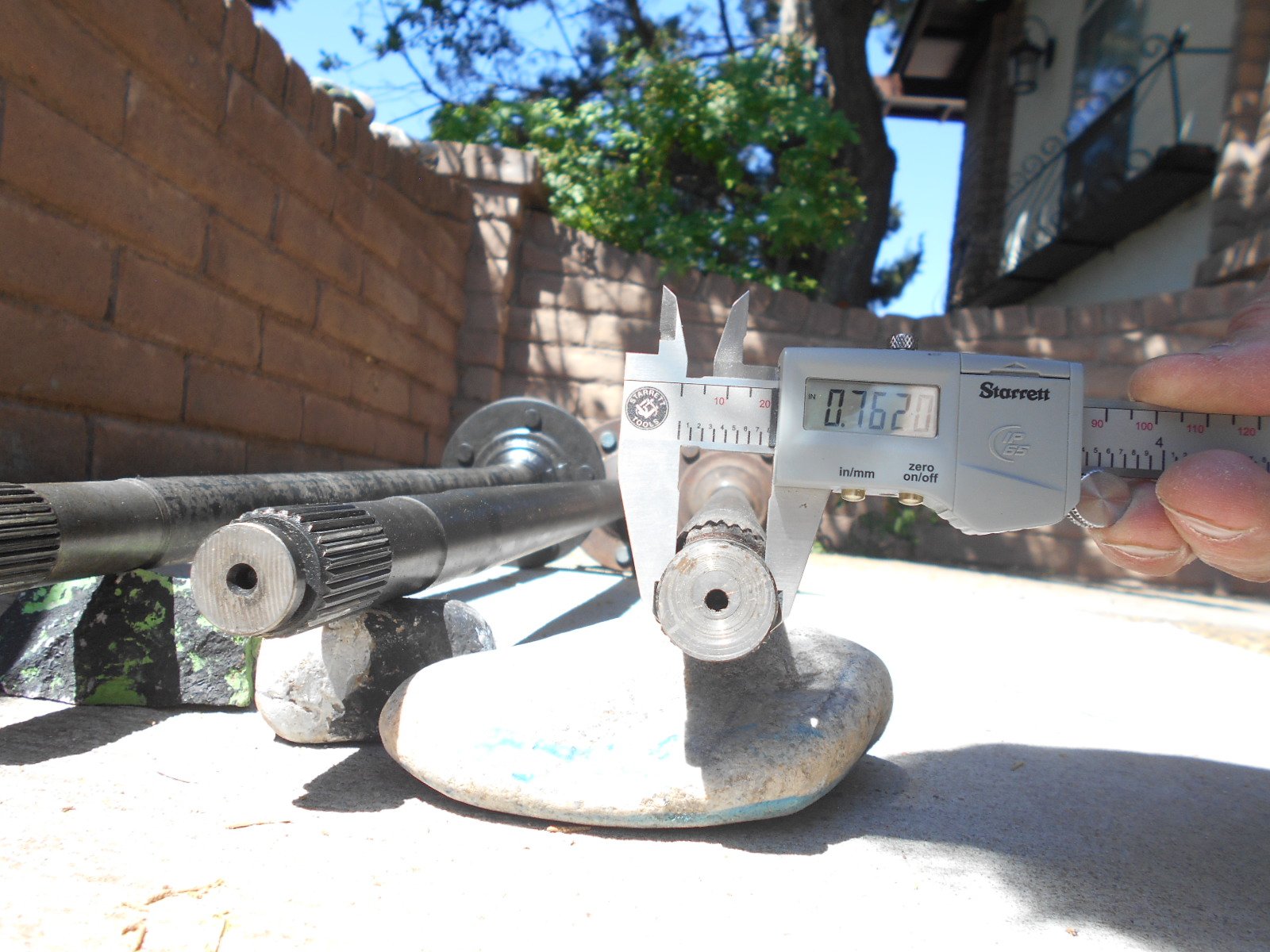

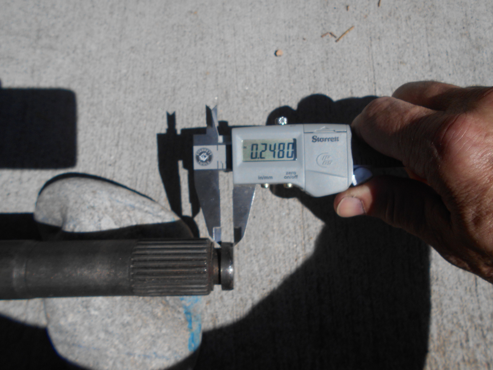

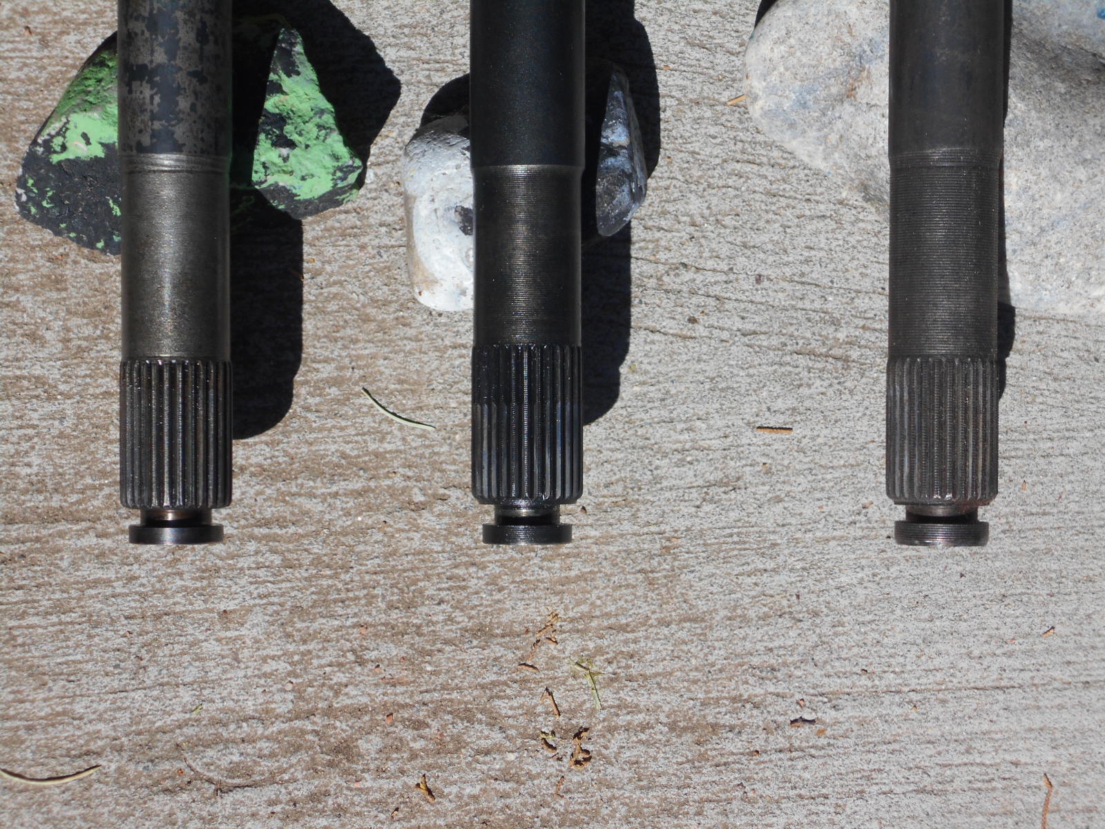

As I mentioned before, two mods are required. The thickness of the end button on the GN axles needs to be machined or ground down from 0.250 in to 0.200 in. The C-clip groove on the GN axle is the 8.5 size, 0.765 in; the C-clip groove on the F-body and G-body axles are 0.710 in.
In the pictures above and below, the modified GN axle is on the left, the F-body axle in the middle and the raw GN axle on the right. Note the hub is deeper on the F-body axle, but it's the same diameter as the GN axle/Gbody. Note the smaller C-clip diameter on the F-body axle.
Below, the raw GN axle on the left, F-body in the middle, and modified GN on the right.
