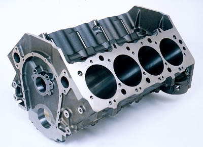

The tall deck blocks (10.2" deck height vs 9.8" deck height) will require either a set of intake spacers or a special intake designed for the extra width the heads set out. This will cause fitment problems with the heater box if you plan to keep it and possibly the master cylinder/brake booster. Also, headers will sit approx .400" higher, also. Can cause firment problems there, too.
As was mentioned, the tall deck can hold a bigger stroker crank due to the extra length of the cylinder bore. The block can be identified by extra material (.400") above the water pump mounting.
http://photos-a.ak.fbcdn.net/photos-ak- ... 79000_4535.
Notice the distance from the upper water pump mounting hole and the deck in this block. It's a standard 9.8" deck.
http://static.summitracing.com/global/i ... 0850_w.jpg
Here's a pic of the tall deck block. Notice the extra material above the water pump bolt.
http://static.summitracing.com/global/i ... 3344_w.jpg
