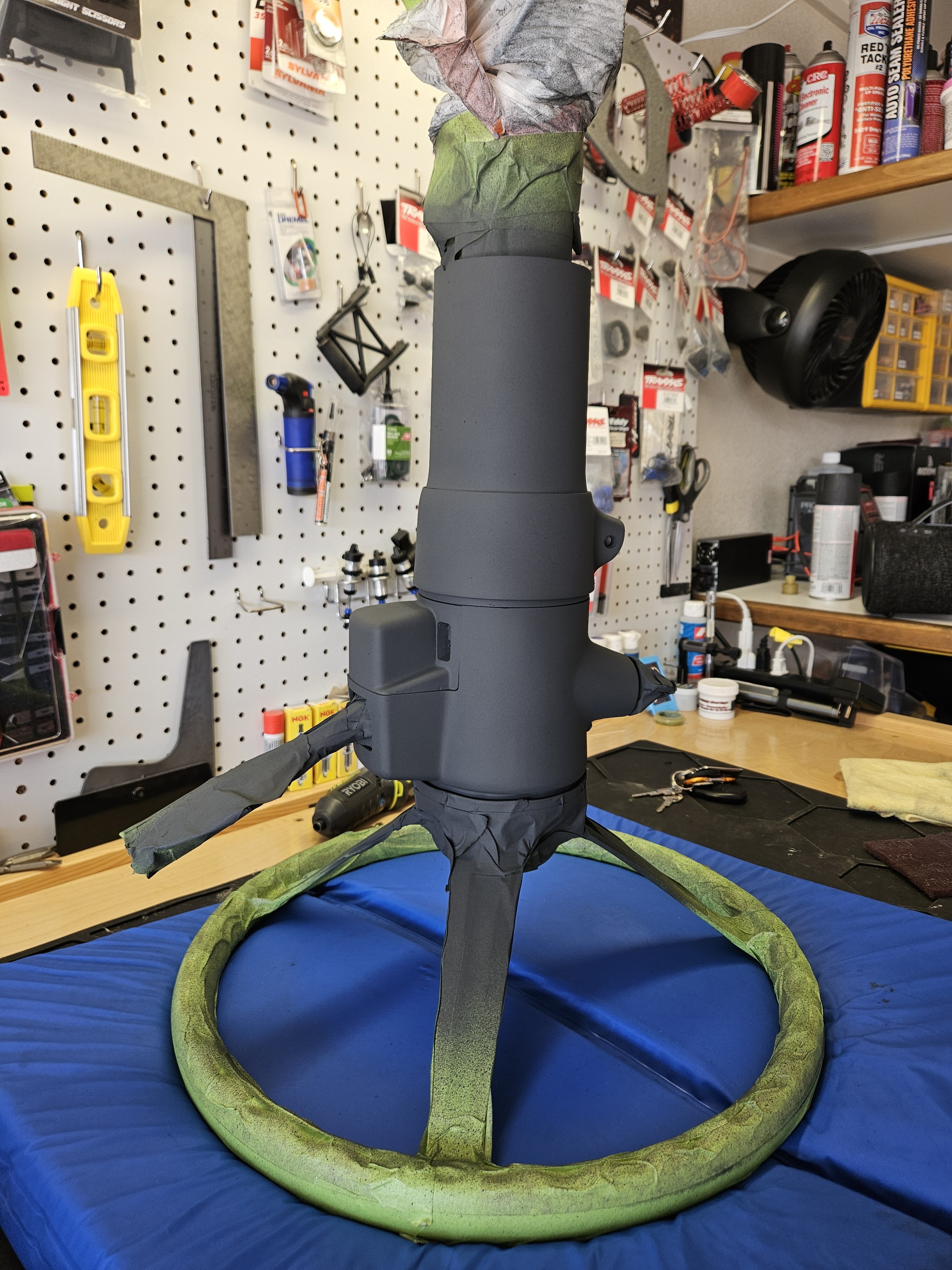

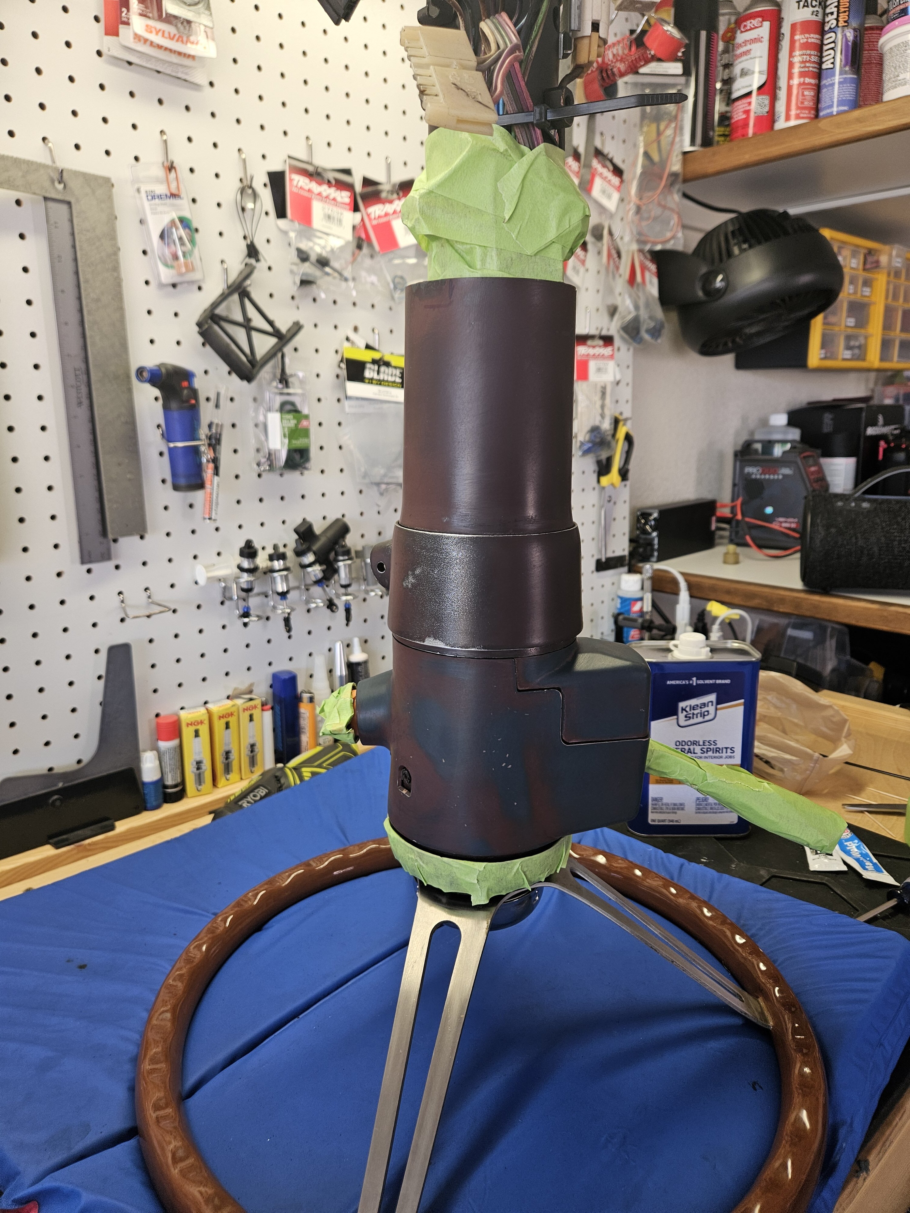

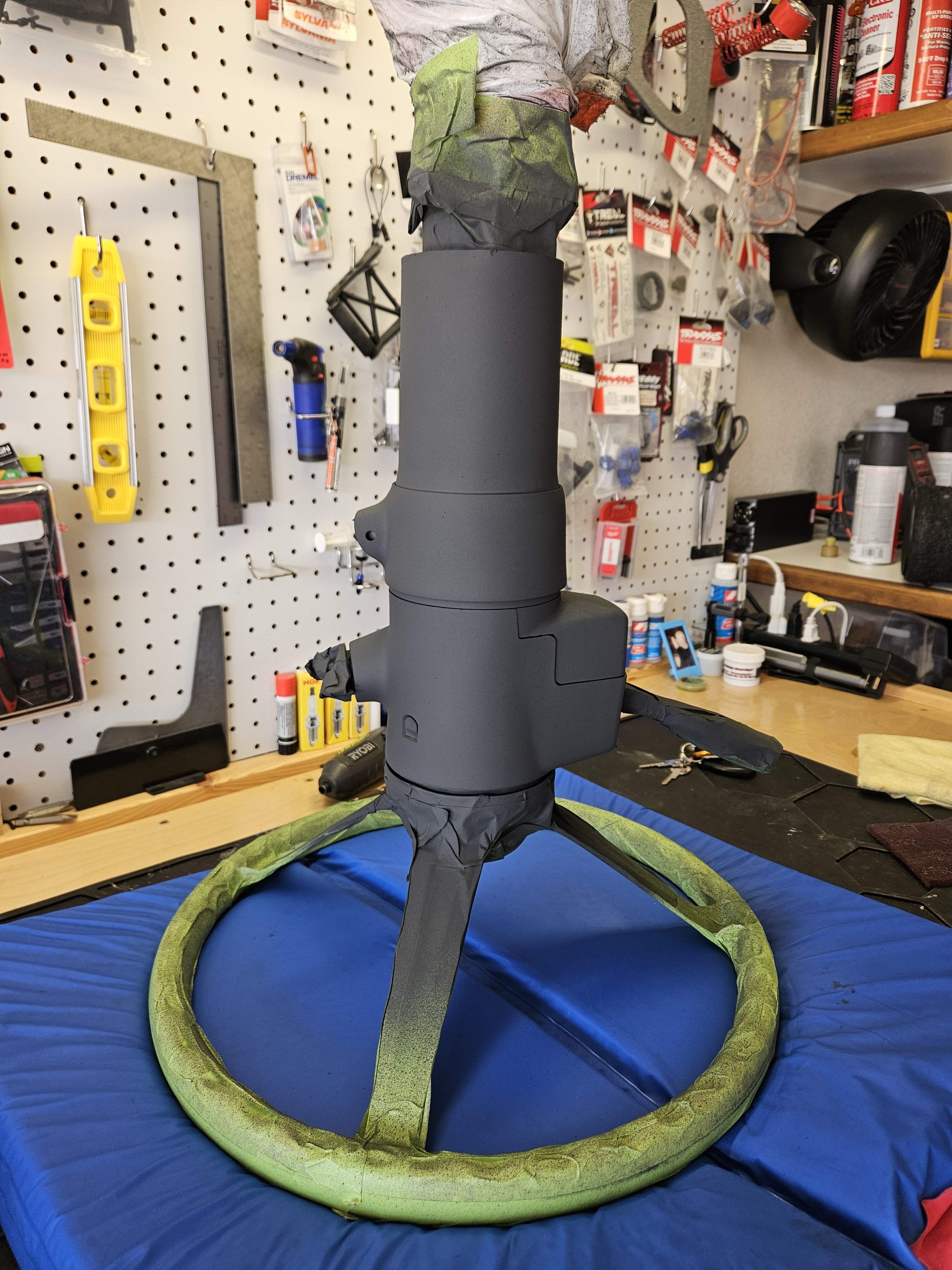

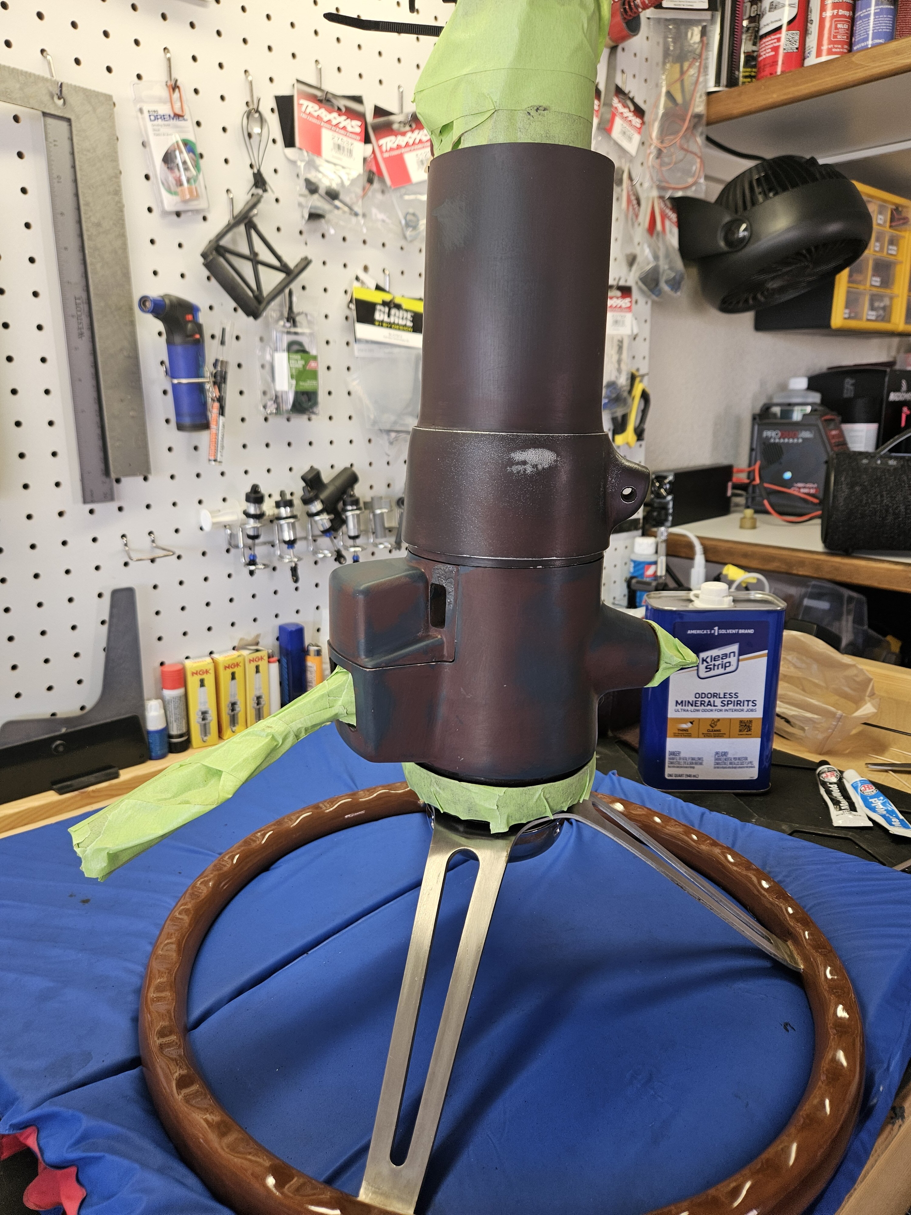

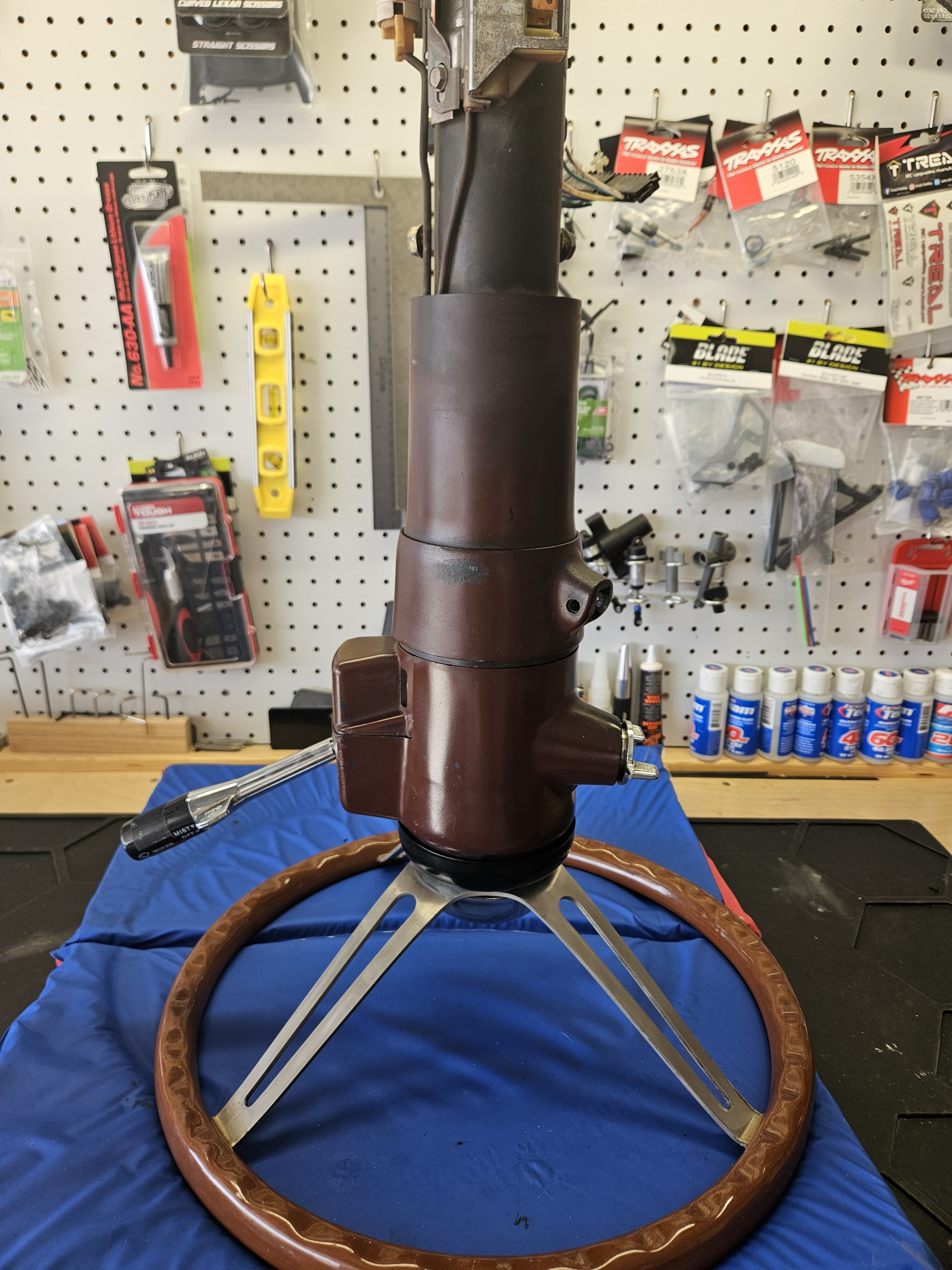

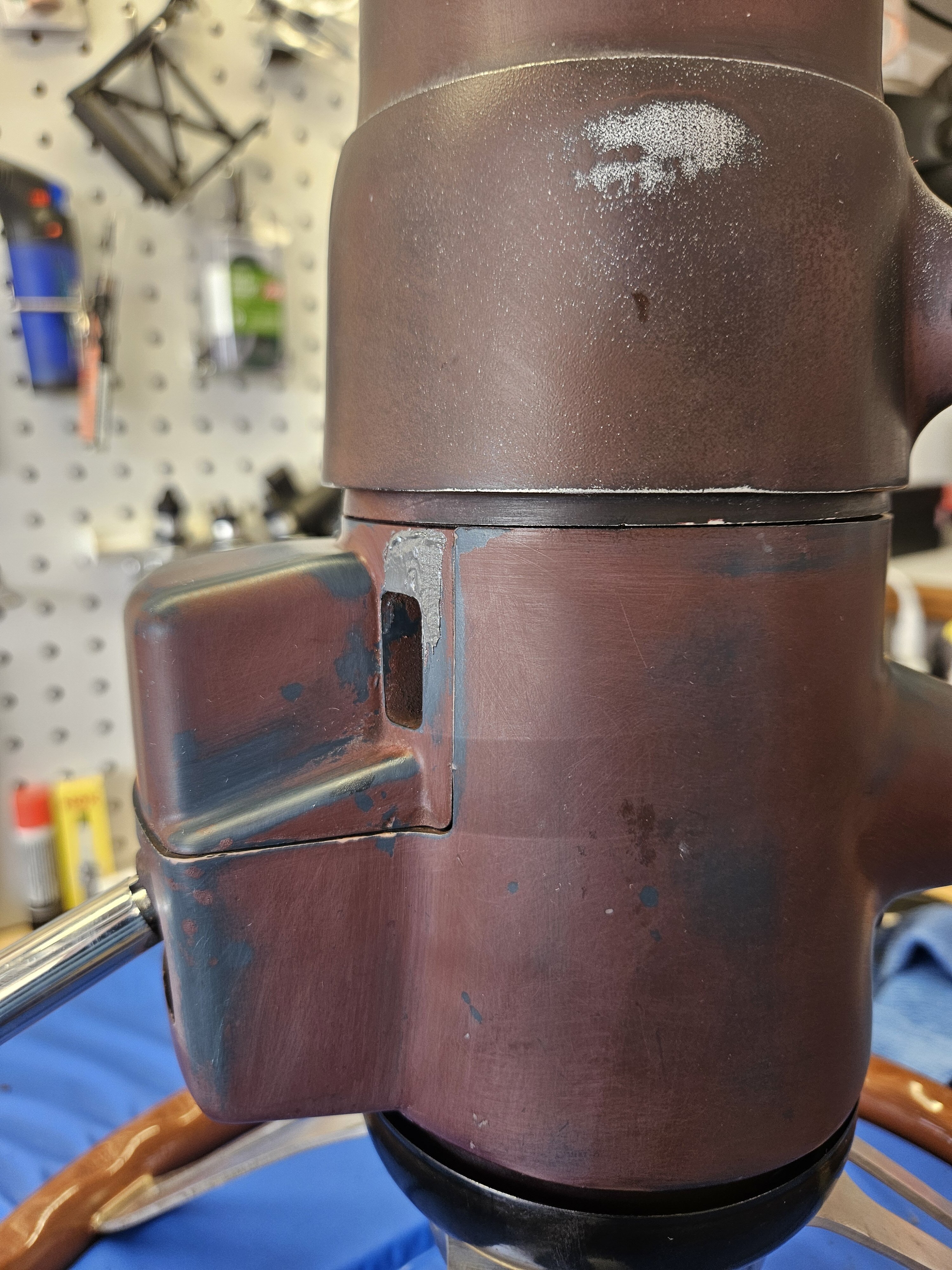

Ok so today finally got down to prepping the column.
Before I started prepping, I degreased the whole area I was going to be scuffing with mineral spirits as to not scuff in anything on the surface. Then got down with a red scotch brite pad and scuffed for like 2 hours lol. Found a small crack in the cover. I cleaned it up real good then used some Marine Epoxy on it.
Will let that cure until tomorrow then will knock it down and blend that spot. Started masking and will finish that up tomorrow but here is where it sits today.
If weather cooperates...as it is gonna be far to windy tomorrow...will shoot sandable primer Monday morning before work.

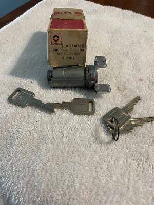

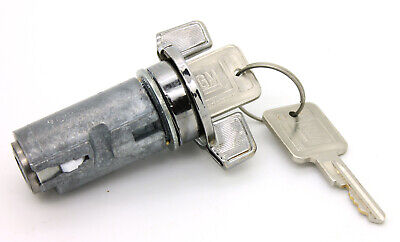

One question I do have...I never noticed this before...but I obviously used my key to "unlock my column" so I could easily turn the wheel and such while prepping...but I was able to with no effort remove my key from the ignition with the column unlocked...pretty sure the key should be locked in no?
Your key cuts are the type that even when new, probably hang on to the key just a bit. Which is fine, but they wear over time, along with the tumblers (as previously mentioned). The tumbler cut pattern "locks" the key in place and the key cuts won't let the key slide over the tumblers. So in any position besides off, the lock is keeping the key because of the side bar locking the tumblers in place. But yours is worn so much, it won't work, so you can take the key out any time you wish. I'm betting your ignition key looks about worn slap out. If you have a weird key cut code, it can lend itself to a much easier removal when worn.
You have an '85, which calls for an "A" ignition key. However, if you don't care about key slots, you can use nearly any ignition key lock with any key slot code. This is because the ignition lock is the only lock on the car the "A" key goes to. Your doors, trunk, and glovebox use a "B" key slot.
Brand new, Strattec (supplied GM under the Briggs & Stratton/Strattec nameplate) for around $30 shipped with taxes:
It's an "E" key, but again, the only lock that key goes to anyway.

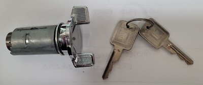

Another one, same thing.
If you just HAVE to have an "A" key slot, but a bit pricier:
