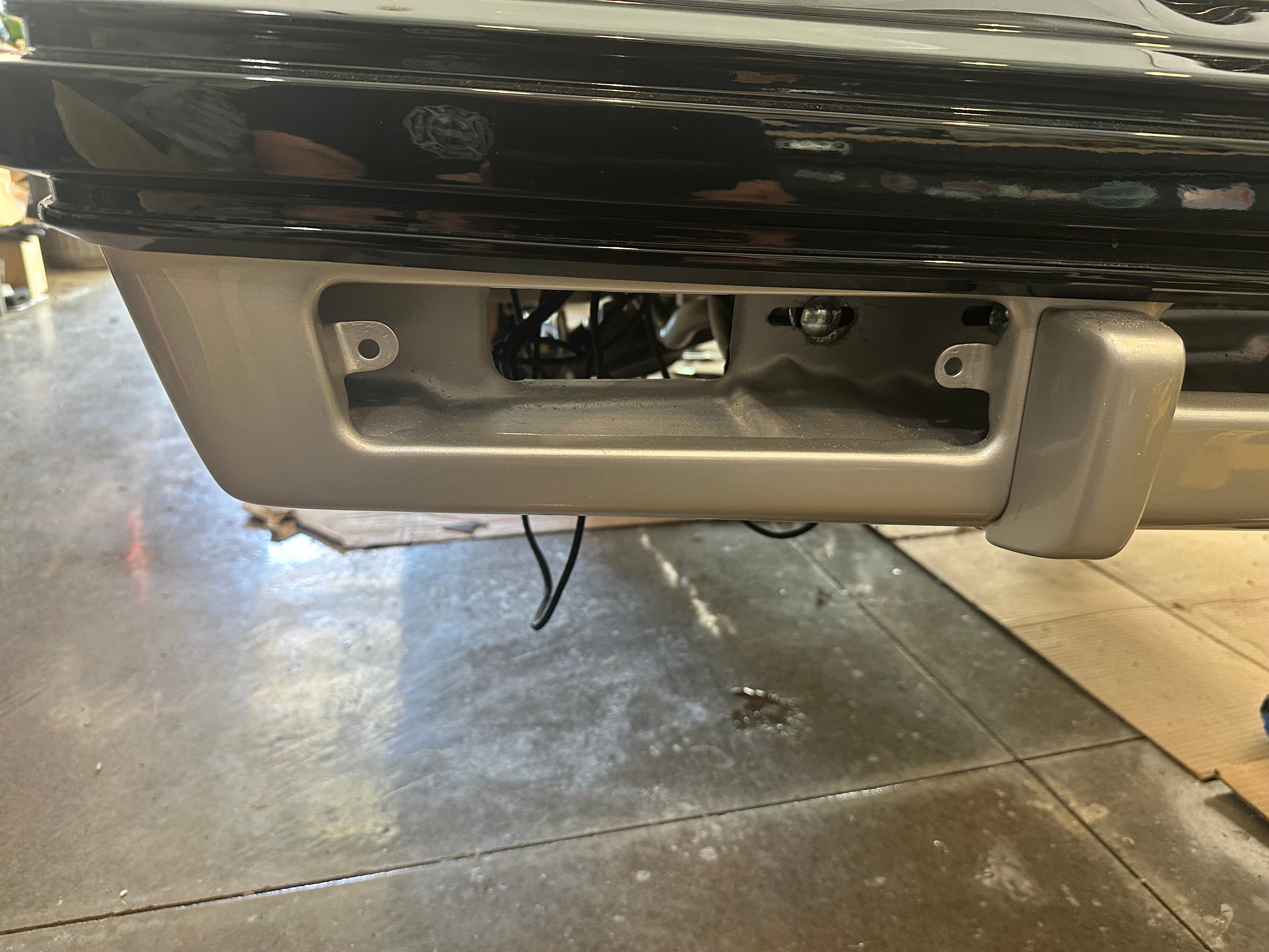

Ok so I’m looking all around for how this front lens screw attaches to the front bumper on my 87 442. Now I didn’t take it apart so I am not sure if it’s. Body connector clip or what and I’m having a hard time finding anything on this.
Here’s a picture of what I’m saying.
I have the new lens and screws but not sure what clips on those ears. Any help is appreciated.

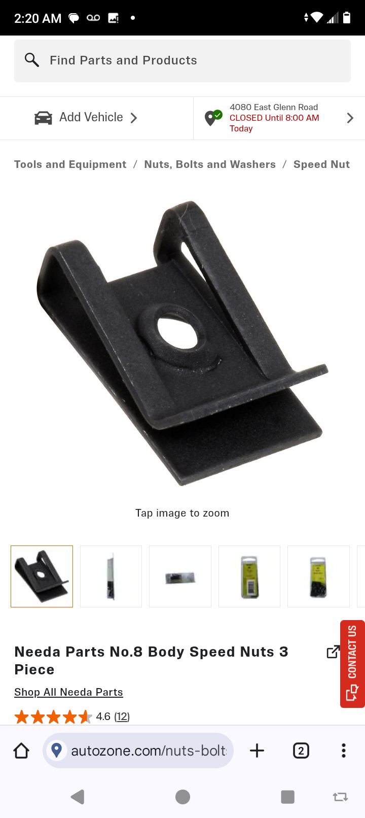

There are also two rubber insulators per light that are attached to the bumper bar, not the actual chrome bumper, the bar behind it. I'm not sure why they are there, maybe to prevent the light from moving and breaking the ears off of the light or to prevent a noise if the light is touching the bar. If you don't have them, you could use a 2" piece of 5/16 or 3/8 fuel hose or vacuum line. Just split lengthwise and use weatherstrip adhesive to attach it to the sides of the bumper bar. Sorry that I don't have a picture, but that the best way that I can explain it. Maybe someone else has pictures or can explain it better.
