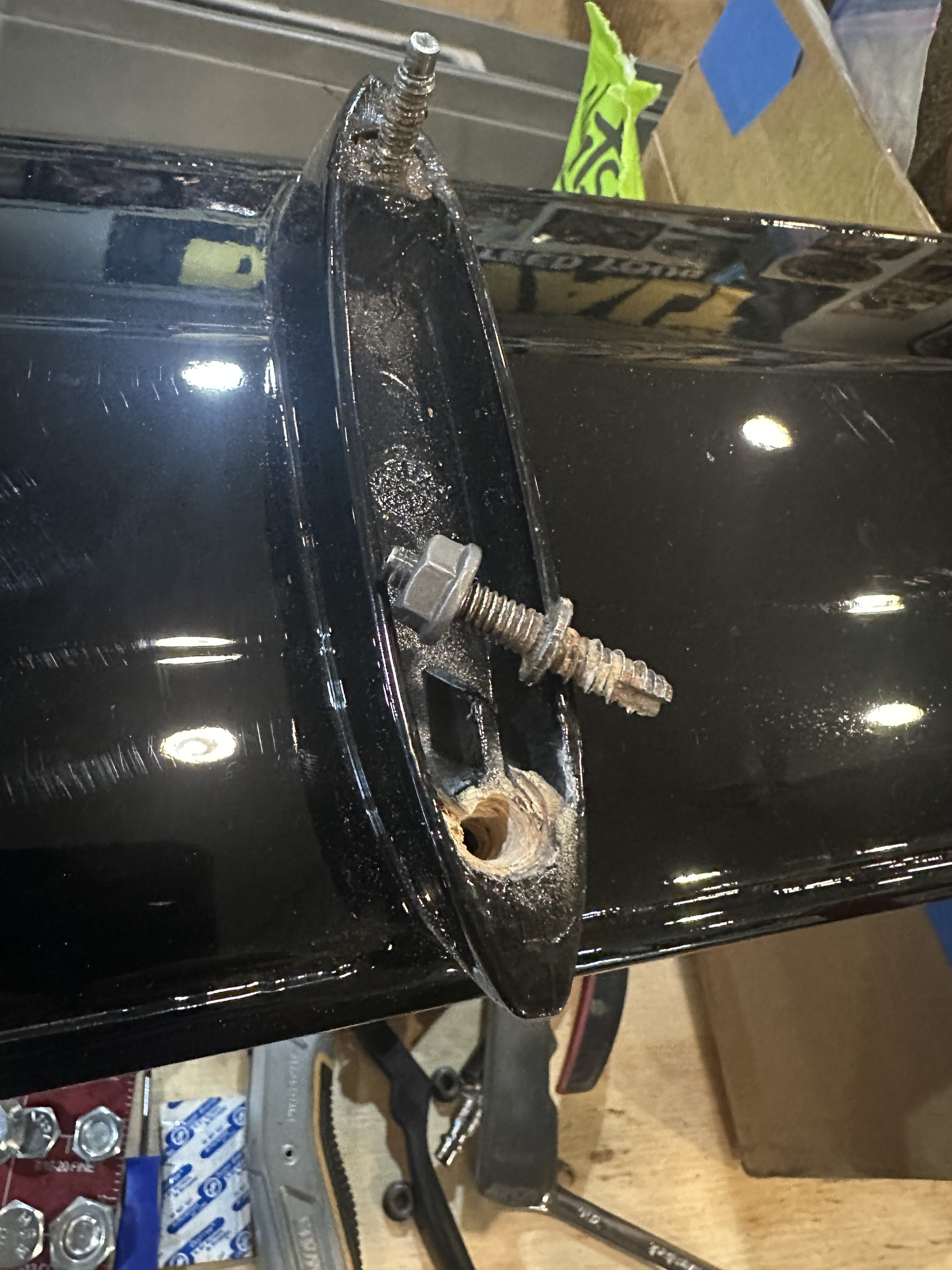

Ok group, I’m trying to clean up the threads of my h/o rear spoiler so I can get it installed.
The body guy didn’t take the time to tape the threads before painting ( a nice job) .
So I’m wire brushing and using a bolt to work on and off to chase the threads but it spun this one and now what should I use an epoxy to set it in place and let it cure or what?
Ideas welcome please and thanks

I bought the gun and used the 3M which works very well, once you use panel bond you find many other uses for it that you maybe didn't think of before.
I used it on my Regal for bonding my GNX wheel flares to the body and also used it to bond aluminum strips to the interior roof to add support when I installed my power sunroof and to reinforce my front spoiler with aluminum to add strength.
