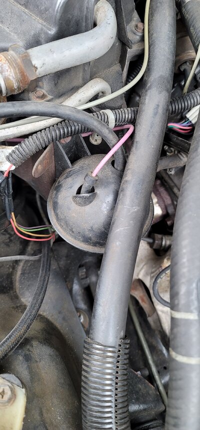

Attached is a picture i think i should feed with vacuum from the intake to get the levers inside working again for the heat and AC ? also i noticed now my heater fan isn't working I'm wondering if i left something out or i pulled a wire apart inside somehow.

On my El Camino the ball is on the driver side front. I’ve fed vacuum to it from the manifold, but I think it’s too much. It’s making a lot louder noise under the dash than I recall from the 305. I’m not sure where else I can connect it to in order to reduce the vacuum draw.
I'm going to give it a shot and see if that makes the levers work again

i did a LS swap on my 83 cutlass and connected vacuum to the purple hose/tube shown in my picture everything works like it used to again. very simple fix to get it all working
