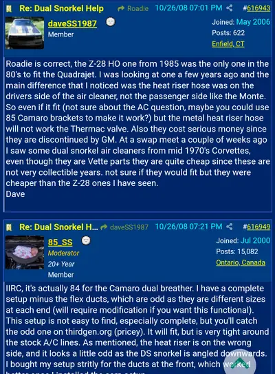

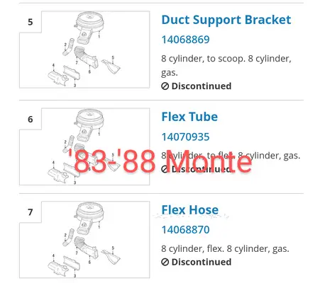

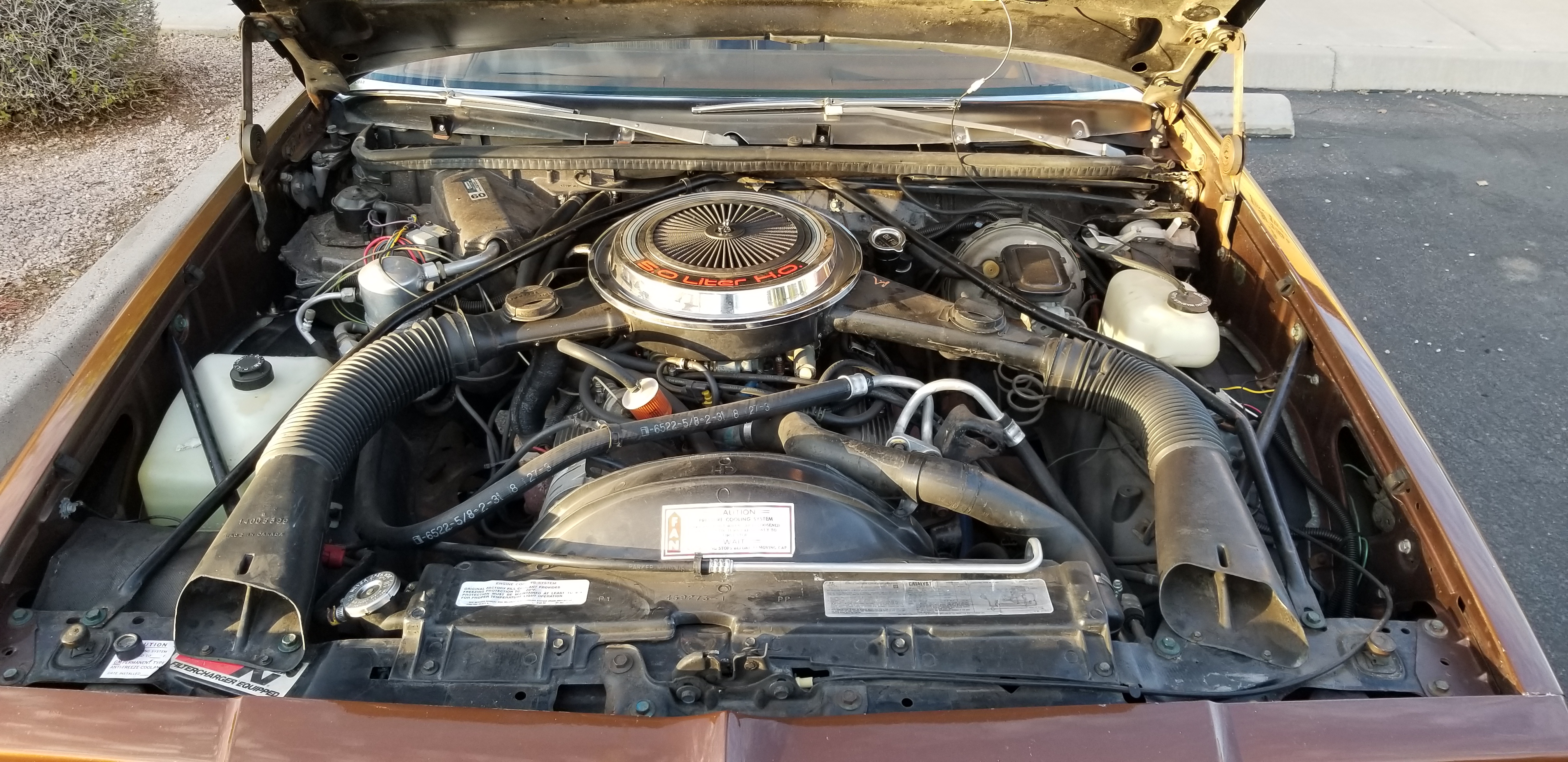

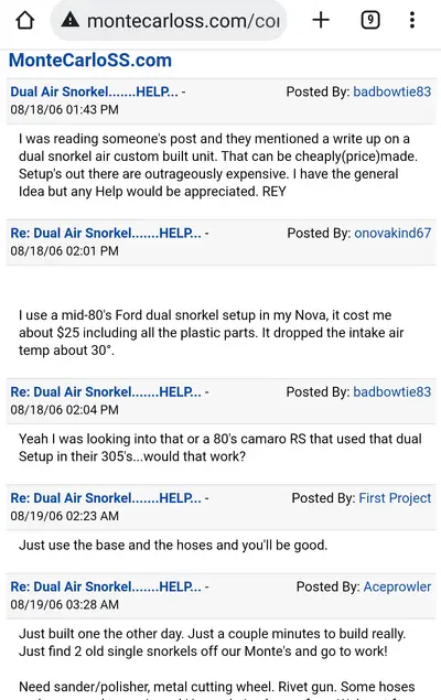

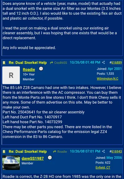

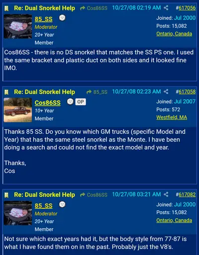

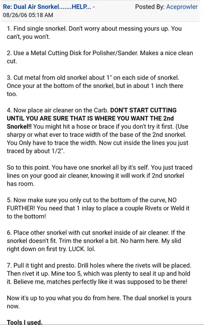

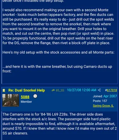

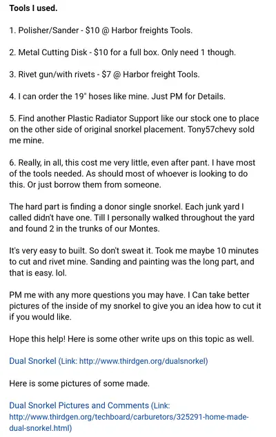

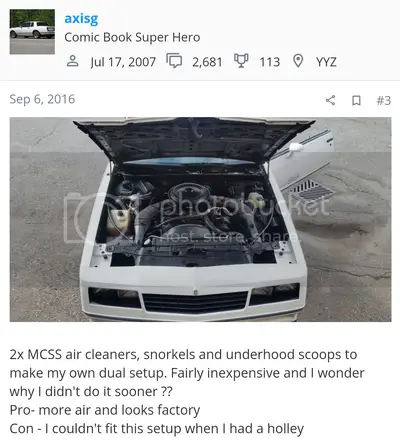

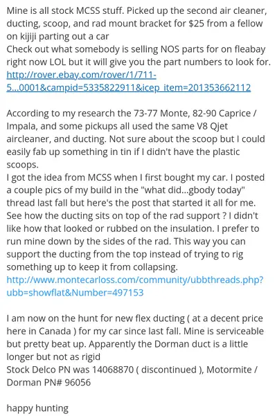

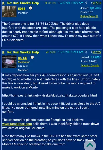

I didn't write any of this- it's stuff I put together from this forum & others, etc. and includes part numbers and information related to making a dual snorkel air cleaner setup with stock parts. I gathered this information to make my own but it's definitely something others are interested in and I hope it's helpful in some way. It seems as though the MC setup is more prevalent, however, I see no reason that the Olds version wouldn't work just as well.
It's my understanding that the Olds air inlets that bolt to the core support will fit all years, and that both types fit all G Body core supports, but that info needs verified by someone smarter than me.
Screenshot_20221211-022447~2.pngScreenshot_20221211-022500~2.pngScreenshot_20221211-022506~2.pngScreenshot_20221211-022525~2.pngScreenshot_20221211-022540~2.png
Screenshot_20221211-022631~2.pngScreenshot_20221211-023537~2.pngScreenshot_20221211-023549~2.png

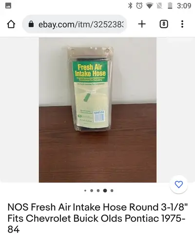

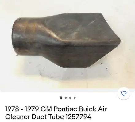

Now that's an interesting one... What car did the inlets come from?
