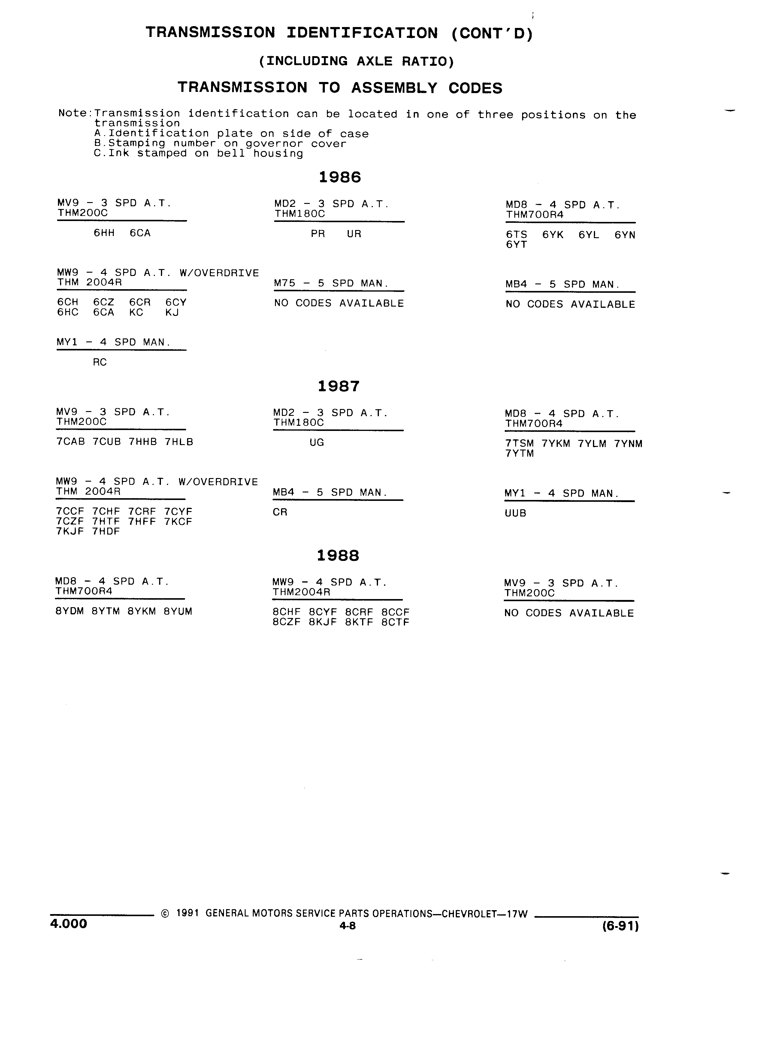

I think I have found one of the Holy Grail 200-4r's. It's supposed to be from an '86 '87 Monte Carlo SS. I'm going to go look at it tomorrow and it would be nice if I had some kind of numbers to match to this transmission. Any help would be greatly appreciated, thanks to all for this great forum.

The second letter is what matters. The CA for 1986 is the lowest performance, soft shifts at low RPM, the CZ is the highest performance, hard shifts at the highest RPM. The letters in the middle are somewhere in between.

Hey thanks guys so if I'm reading this right I'm looking for six CZ or 7 CZ or eight CZ depending on year on the identification tag if it has one lol. Thanks again for the help guys hopefully I'll be going to look at it sometime today.
