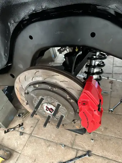

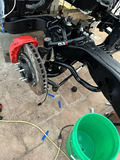

Yea ordered my cam already from smallwood. im going to go with a pair of s369 or anything in that range. Finally the actual car is looking like a car again. slowly but surely.
