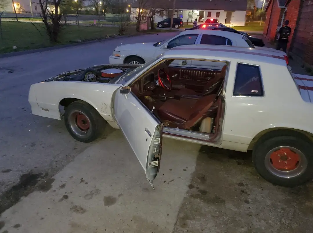

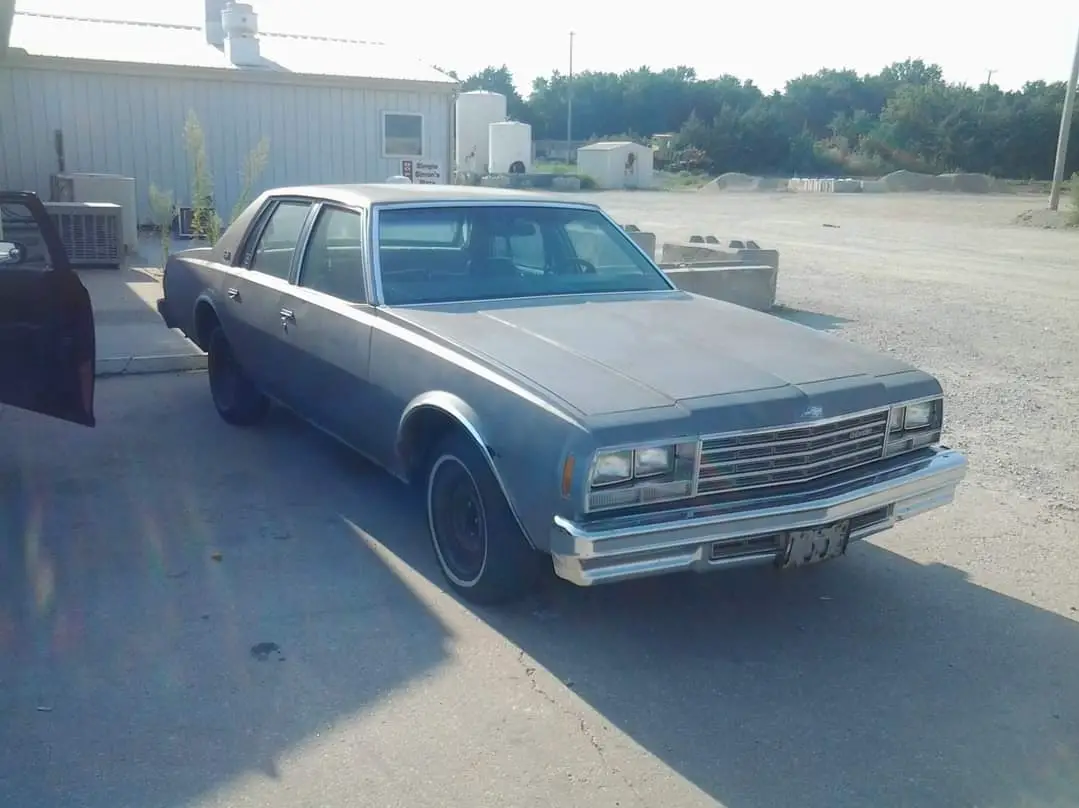

Also, this Monte isn't my first old school chevy, or Gbody for that matter...

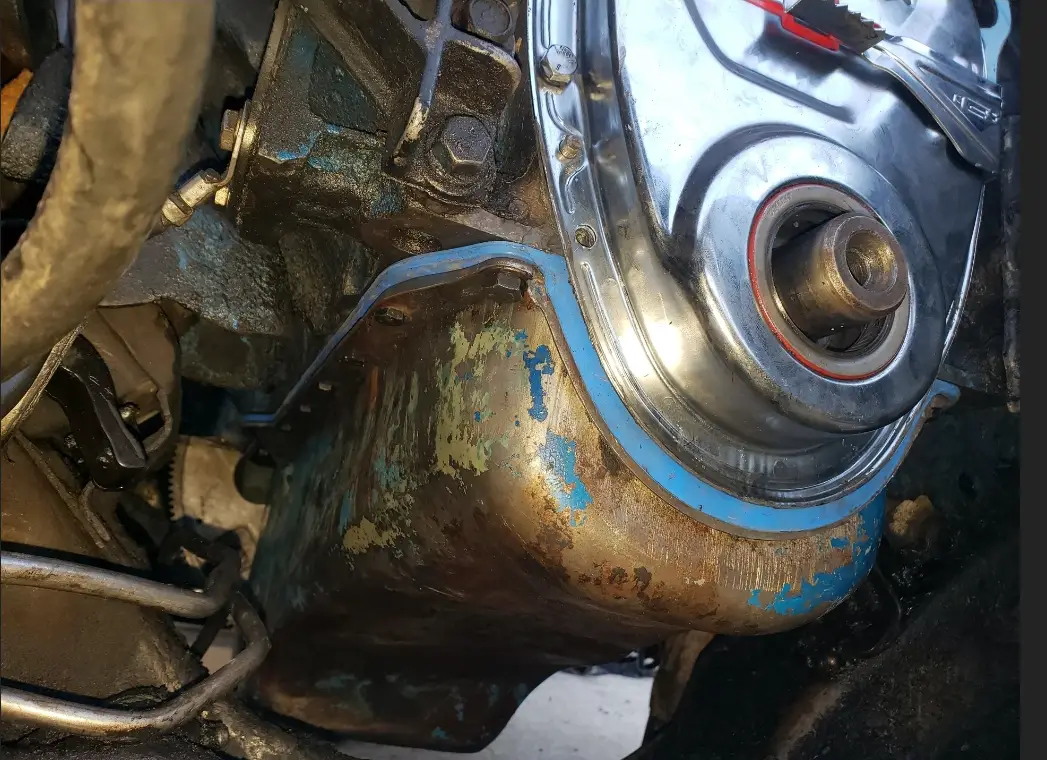

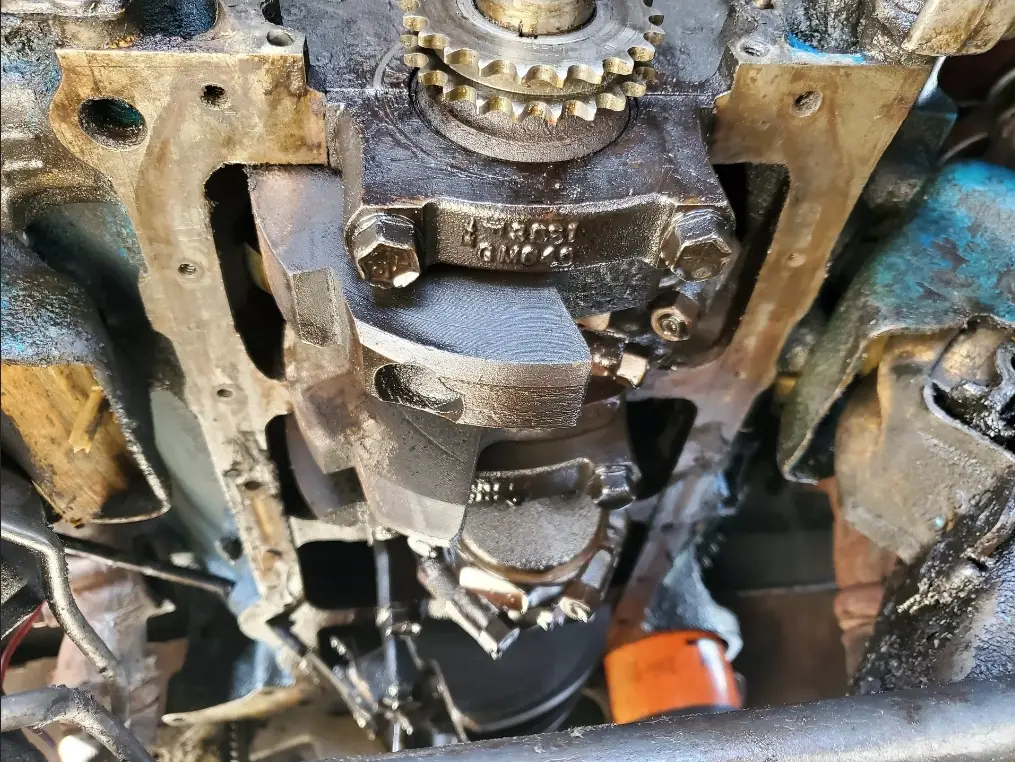

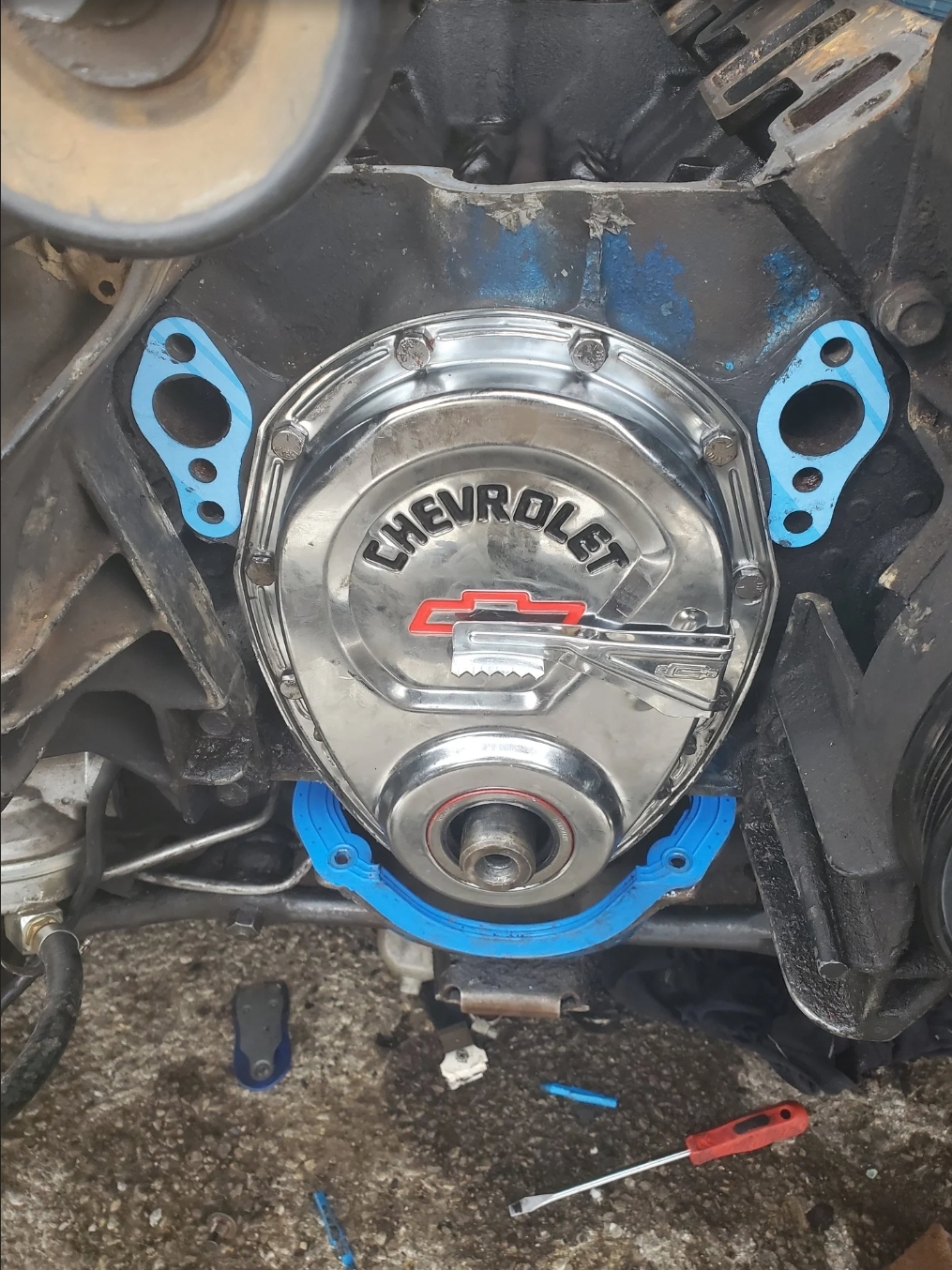

Went ahead and raised the motor up enough to pull the oil pan, inspect the crankshaft, and replace the gasket while I was at it.

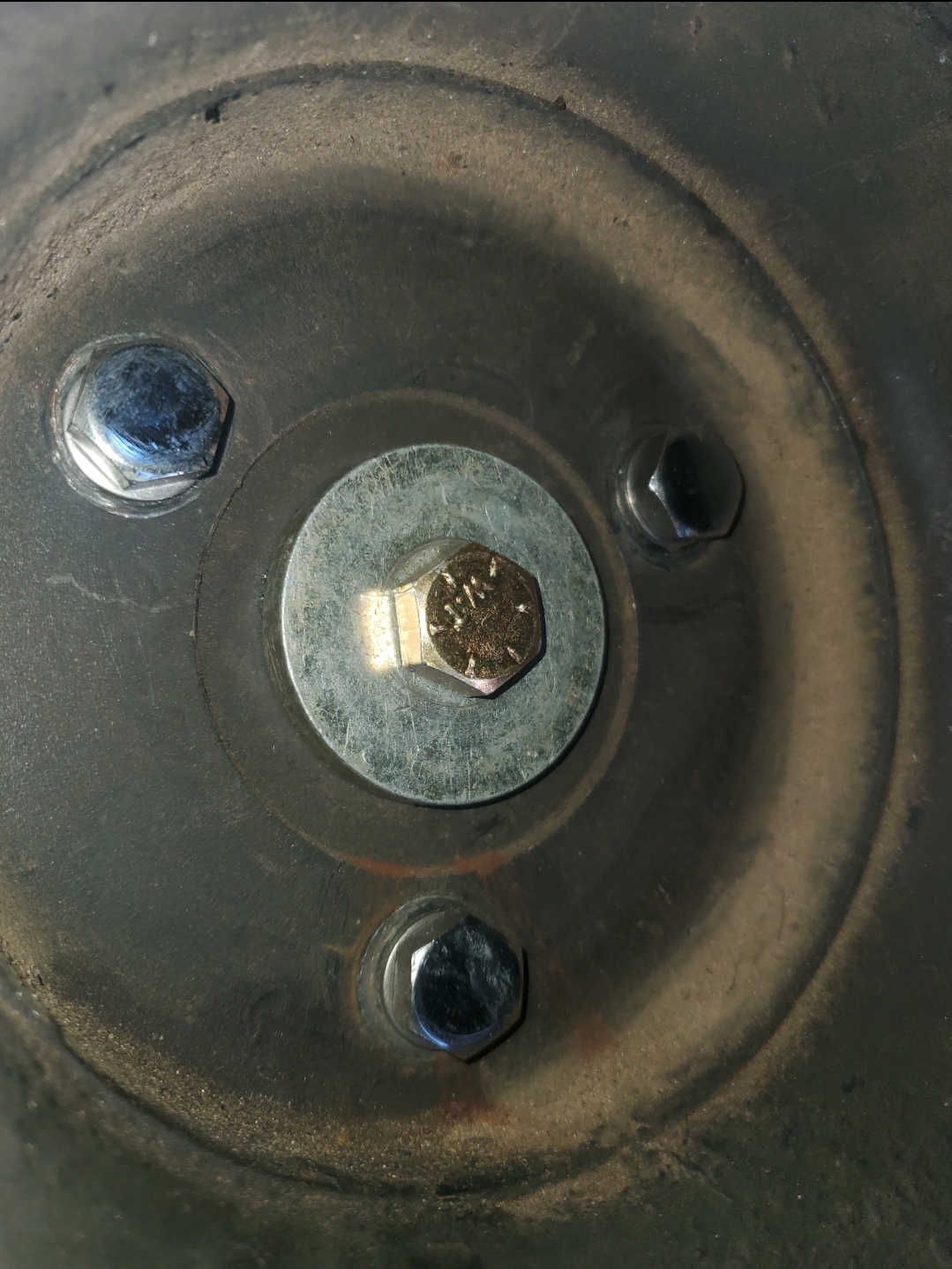

Managed to get a balancer bolt in my crankshaft snout...

Also, this Monte isn't my first old school chevy, or Gbody for that matter... View attachment 228667 View attachment 228668 View attachment 228669 View attachment 228670 View attachment 228671 View attachment 228672

Went ahead and raised the motor up enough to pull the oil pan, inspect the crankshaft, and replace the gasket while I was at it. View attachment 228675 View attachment 228676 View attachment 228677

Managed to get a balancer bolt in my crankshaft snout... View attachment 228678

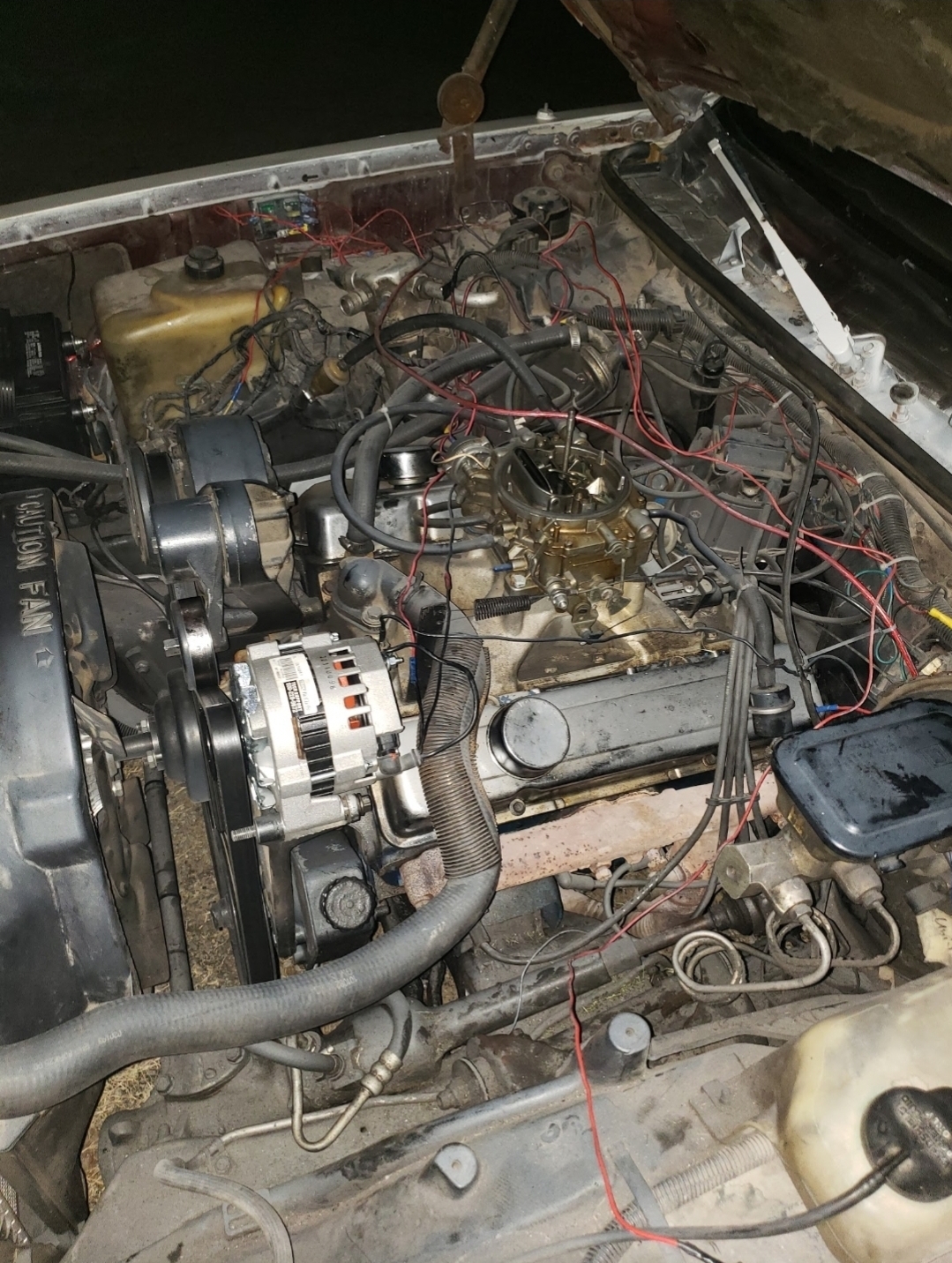

And hours of timing, valve adjustments, Holley carburetor tuning and maintenance, compression testing, vacuum watching, recurving the distributor...anything else I might have missed.
I've been doing it all successfully...with good apple and sound advice.
