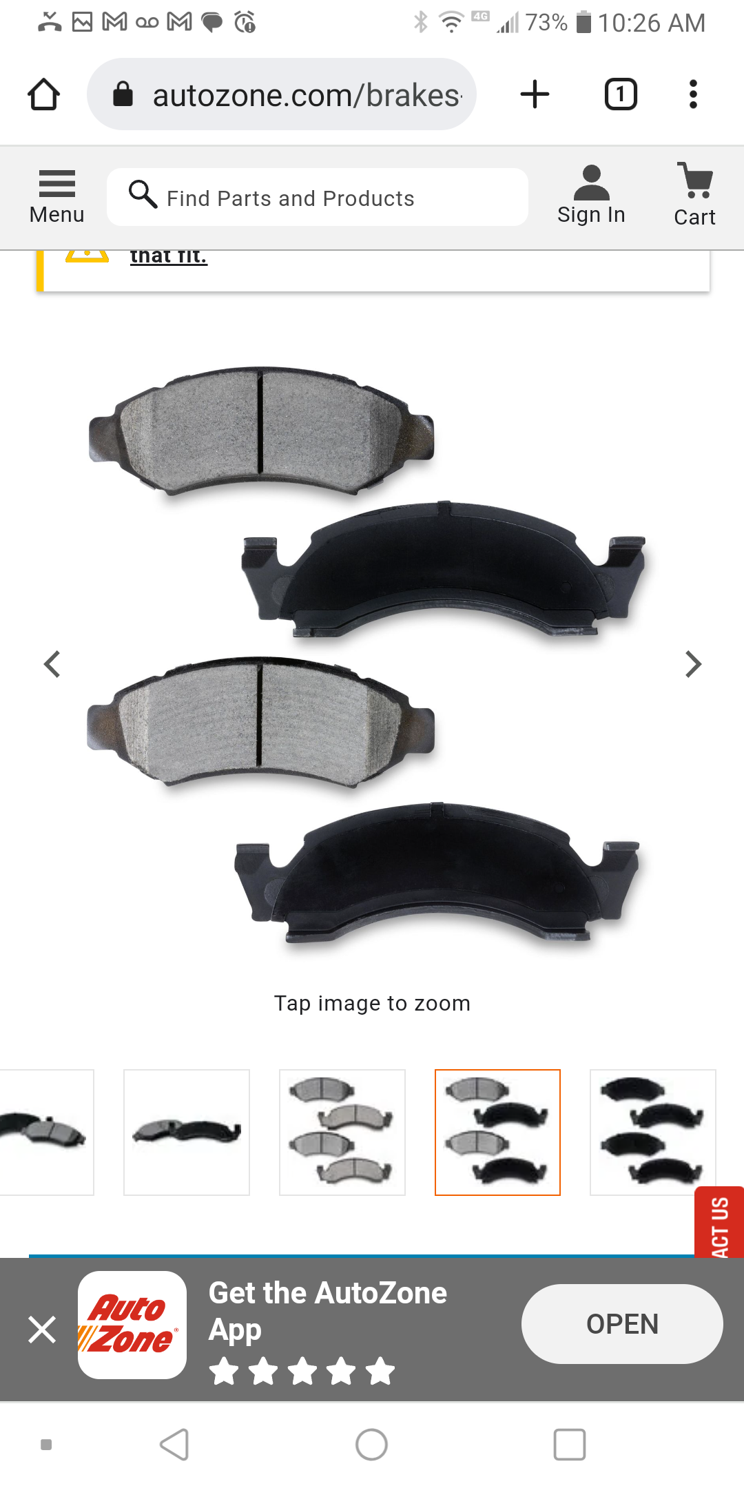

Two small tabs at top of the outer pad. The large one at bottom leave alone. When bent down slightly they will fit snug on the caliper. Keeps them from rattling.

Pic from AutoZone...
The two tabs on the outer pads,
Just bend down slightly with pliers/vice grips, or tap slightly with small hammer. It's all trial and error... Just make snug enough so they are tight in the caliper. You put the tabs in first then clip on the bottom of the pad. It should take slight force and with a noticable click when seated properly.
The inner pads... You see the "ears" sticking out? They fit in the grove of the caliper and they have to move to make contact and retract properly. The grove they go into has to free of rust and dirt. Use a small flat or "rat-tail" file, just small amount of high temp grease in the grove, once it's clean.
Also on the pads. If they have a straight cut 90 degree edge... You can take a flat file to the edge at a 45 degree. Not much, just a little, and this will help reduce chatter (noise) when applying brakes. You can do the same for any brake shoe for drum brakes. But don't on the small e-brake shoes.

Thanks for the help. Everything you said was very helpful and stuff that is easy to over look. I went with a set of Reysbestos pads as I have good luck with them on my truck. They have an integrated shim which the offending pads do not. Anyways I went for a decent little cruise and no noise whatsoever. I will continue to keep an eye on things but thinking it was just a crappy set of pads causing all the grief.
