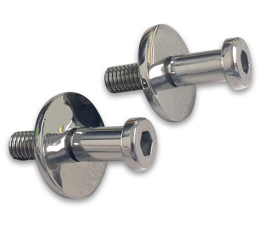

Back onto the strikers. I do wonder like you Sweet_Johnny about the strikers that don't have the spinning collar...how that will impact.

I don’t think having the roller collar on it is as big a deal as the material that one is made of:
Aluminum, especially in that application will wear extremely quickly. I have all stainless steel ones on The Juggernaut, and have had zero issues with wear in the 10+ years they’ve been on there.
I sourced mine locally a long time ago so I can’t be of much help there, but the application was for a first gen Camaro/Firebird and the thread pitch was exactly the same so you should have no issues either.
Copy that. I'll look for stainless.

These appear to be stainless striker post and washer. They show as 7/16" -14. Which I believe is the same as the Cutlass. Just doesn't specify striker post length.
Wonder if they will work? 🤷‍♂️

Thanks for all the insight guys. I went with the stainless ones from Eddie Motorsports. I'll let ya know how they work out once I get them. I'll probably grab a couple chrome washers for behind it, as my current set up has 2 washers behind each of them. 👍👍
Got this wrapped up today so figured would share. Went with the stainless strikers from Eddie Motorsports. Got here super fast and look great. Seem to be exact same size as my stock ones. I was gonna find two chrome or stainless spacer washers..but was unsuccessful and didn't want to send 4 washers to chrome. So I cleaned up the old washers and painted them. Looks about 100 times better lol.
