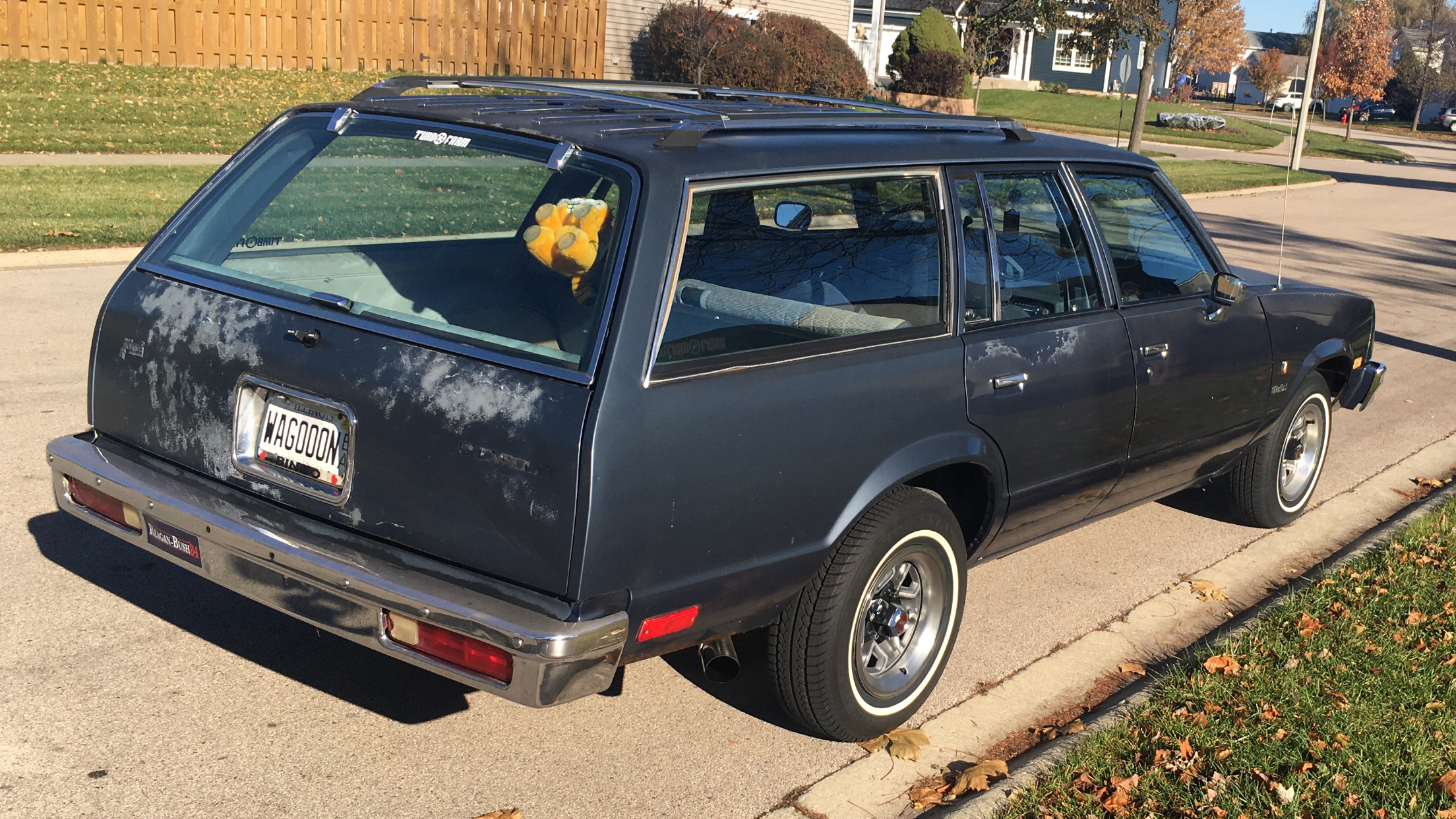

Newbie Post. 83 Malibu Wagon

The nitty gritty….
109 block 30 over, stock crank rods caps, wiseco pistons. 8445 heads econo-ported, stainless valves, roller rockers, 210/215 roller cam & Johnson lifters. TA perf front cover and IWIS timing set. Hellcat pump in the tank on an astrovan hanger with racetronix wiring inside & out. -6 fuel lines, flex sensor, 120lb injectors and ECUGN engine controller. 200R4 trans & 8.8 rear axle with 3.55’s. 6266 precision turbo and precision intercooler. At 23psi the Gooon put down 532WWHP (whitewall horsepower)
Reagan Busch ‘84 bumper sticker, Garfield window toy, and BINGO license
500+ hp in an 80s wagon with a Garfield window toy.... I love this build!!
