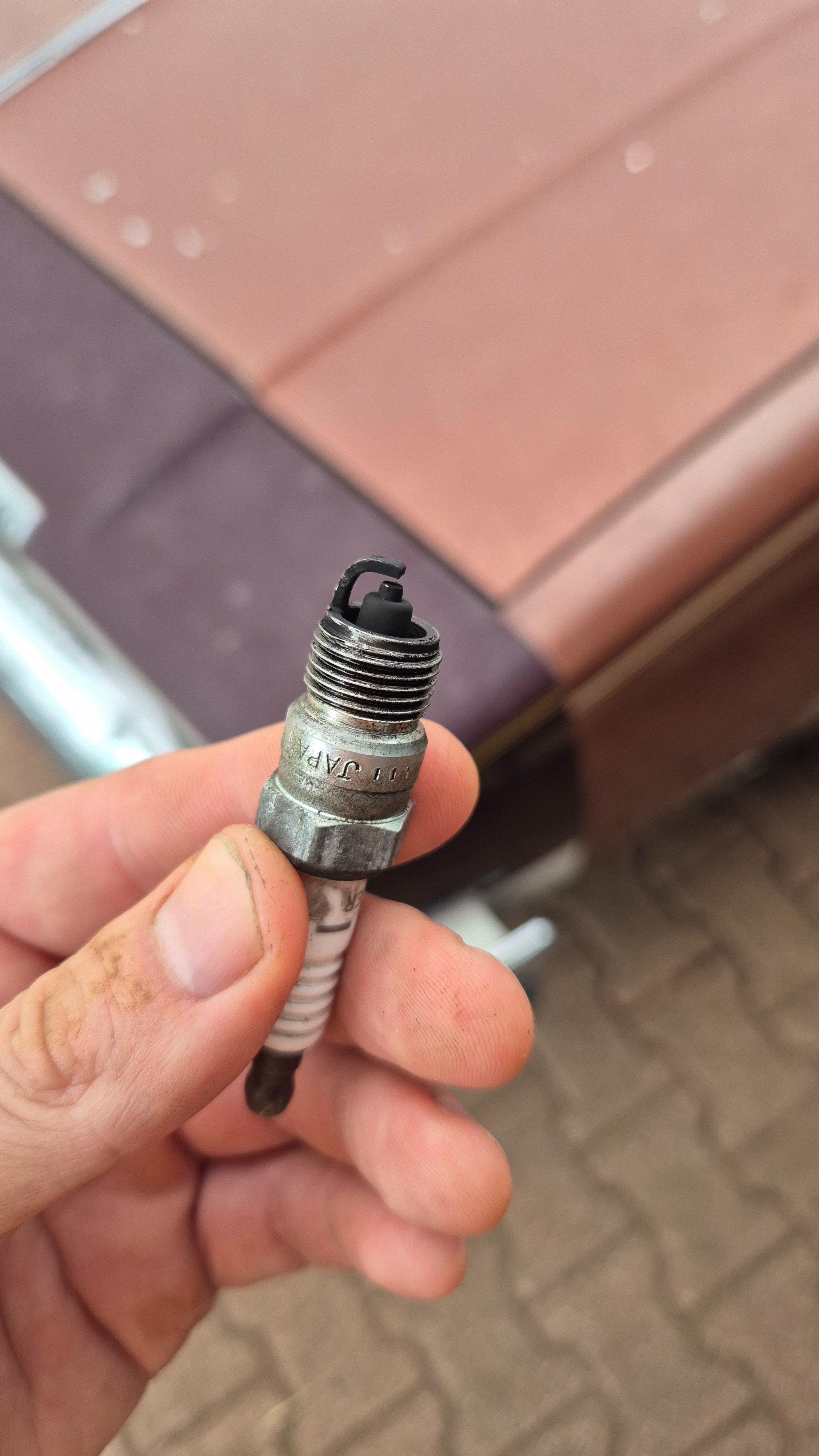

I changed the spark plugs, I had ngk ur5 which were black (see the photo) I replaced by ngk ur4ix (irridium and a bit hotter). I Started again but the problem is the same as before.

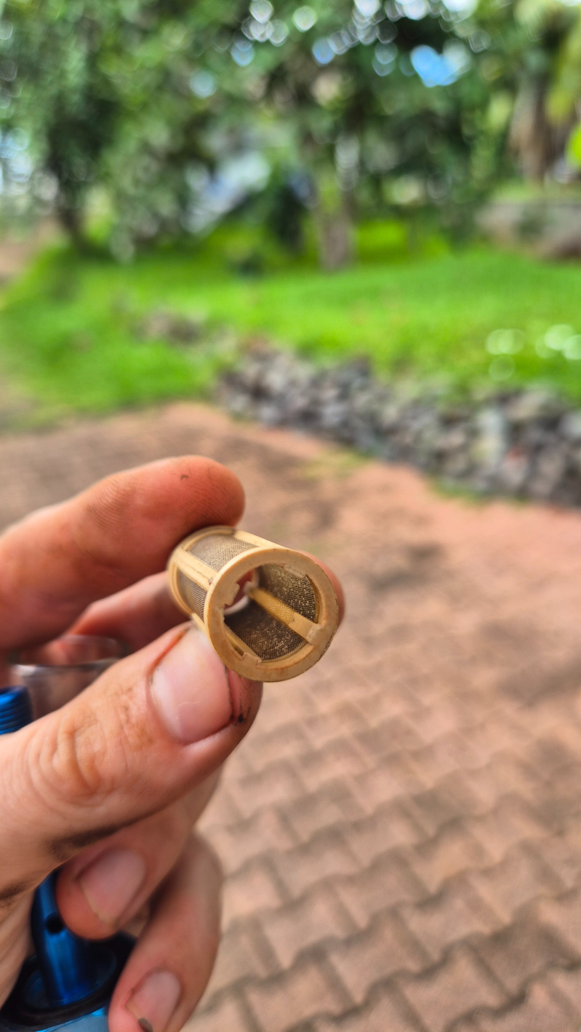

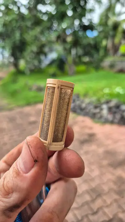

I cleaned the little gas filter.

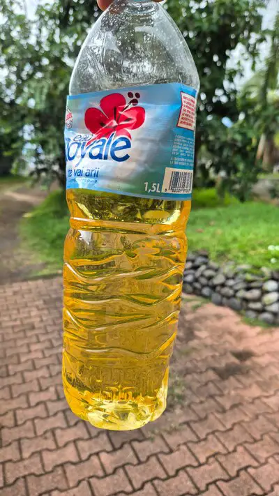

and here is a bottle of my gasoline coming from before filter, it seems perfectly clear.
