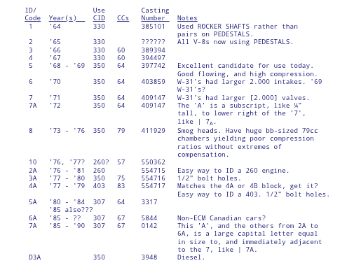

If I had a nickel for every pre-1977 350 Oldsmobile that ended up being a 1977-1984 260, 307, or 403…Better start by running your casting numbers so you know what you actually have.
From Olds Junction
Castings numbers on the block :
395558 2
On google it says 68-76 350 oldsmobile 😁
If the Casting number is 395558 then Google is wrong again. It’s a 1968-1970 350 block. I’ll go out on a limb and say it’s a 1969 since the first digit 3=Oldsmobile Division and the second = Year manufactured (9-1969, 0-1970, 1-1971, etc)
