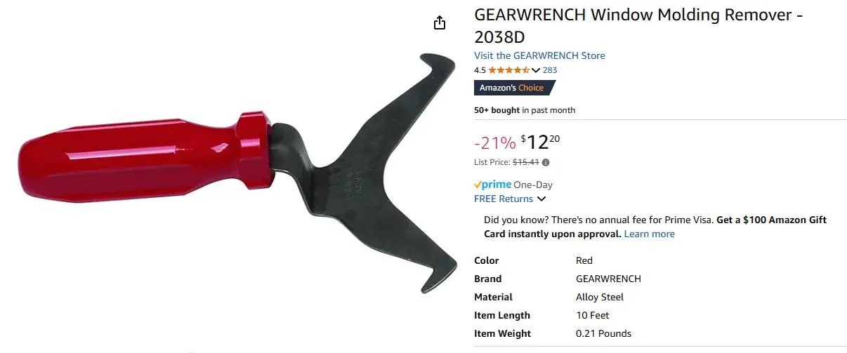

Thanks. Is this the tool? If I am going to break clips, and the paint that is on the car isn't the greatest, I may mask up around all the trim and paint it on the car. I will be doing that for the rear 1/4 windows.

Yes. If they painted the trim on the car the same color as the car, it may be difficult to remove without damaging the paint.
