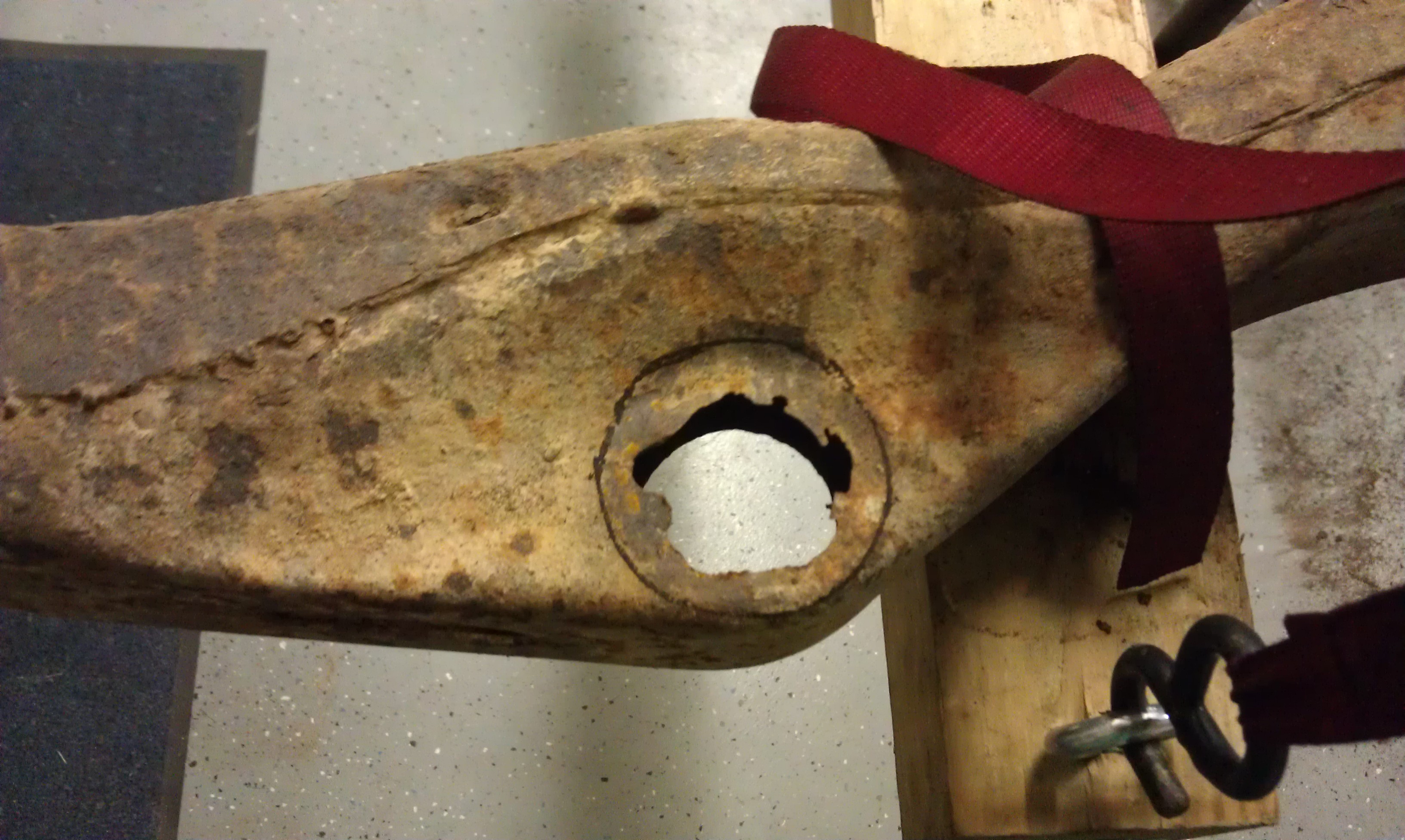

Thanks for the replies guys. As far as the frame mounts go, mine look similar to this one. You cannot really discern where the edges of the old hole were. Is a best guess good enough? From what I understand of the mount assembly, there is at least a little bit of play so being an 1/8" or two off shouldn't matter?

our washers are the size of the body mount, so if it rots all the way out, you can place the washer on the edge of the frame and it will be centered. Also, if you can happen to find just one side that has a circular reference, you can center the washer with that area and get the washer centered. You have 1/2" play
