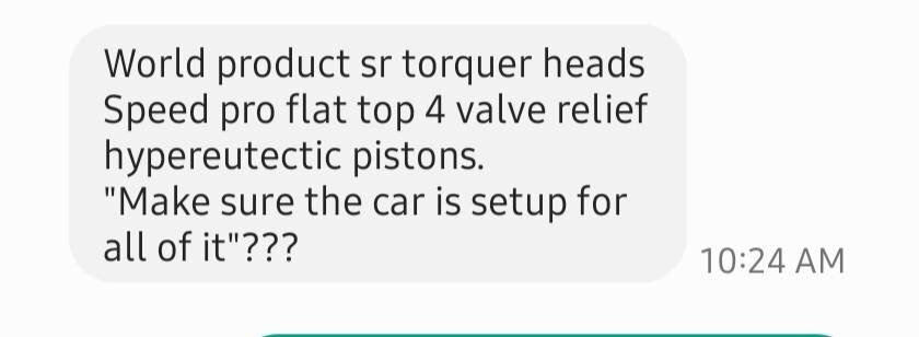

@ scoti here is the information on the heads, that make sense. It's running like no take off power at all. Pretty much it is toy so it doesn't come out alot. It has the stock gears in it right now. I'm gonna start putting premium in it.

World Product S/R Torquer's are basic aftermarket replacement iron heads available for the 350ci range sbc with 67 & 76cc chambers. The 'Torquer' version appears to have the larger 2.02 intake size & the regular S/R version is just that (stock replacement 1.94" intake valve head). Based on the description of the pistons as flat-top w/4-valve relief, the compression would likely be better vs a standard smog era 350. The current cam is fine in this instance (not too much & not too little).
A quick google search educated me on the heads.....
Start w/the gears.
