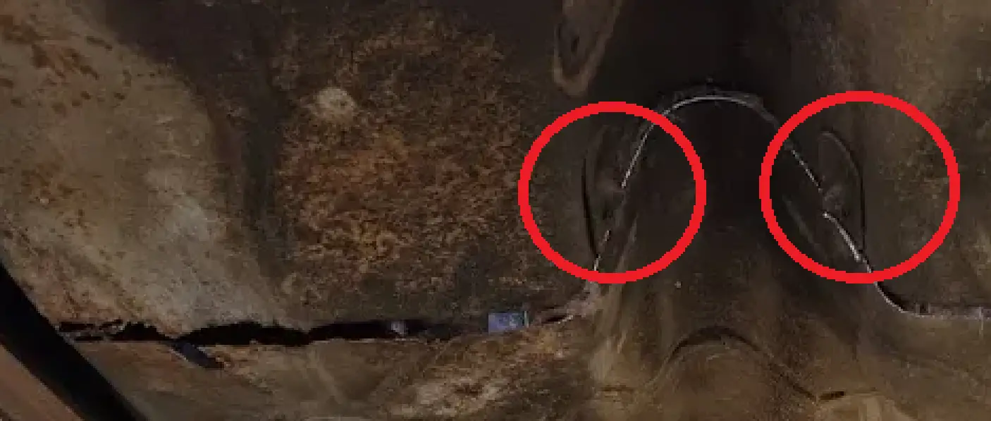

They're part way up the side of the trans/driveshaft tunnel. From the pic 86LK posted, here they are circled in red.
which reminds me... the line you see from left-to-right is where we cut thru the floor to remove the front half of the cab (it's not rust-thru) with a torch, leaving some of the rear floorpan but just behind where the seatbelts would bolt down
