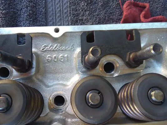

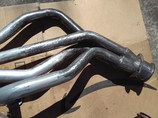

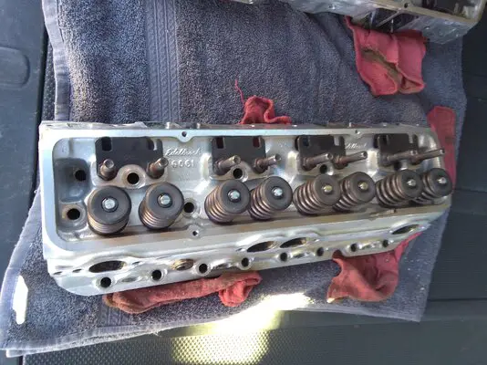

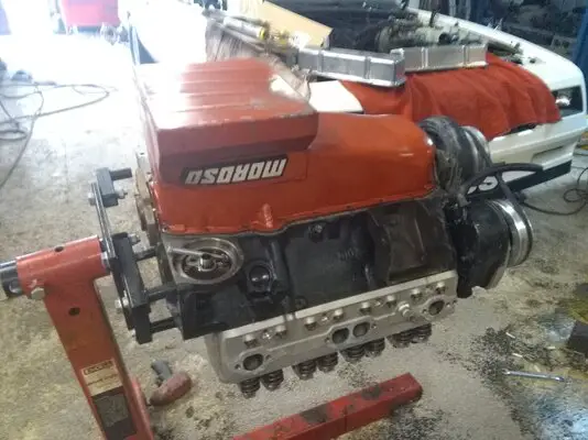

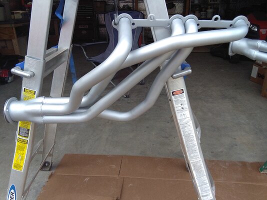

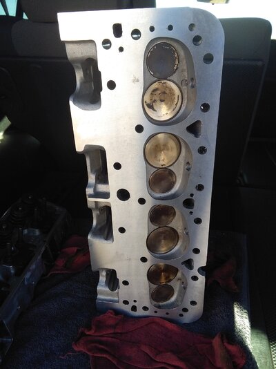

Finally got to work on the SS. The head gasket was shot. It was leaking into the exhaust ports. It looks as though it was seeping for awhile before it failed. There is some corrosion but no damage. It cleaned right up. I took the precaution of having the heads checked. The pressure check was good. They were milled just to make sure they were true. Haven't taken the bottom half apart yet. The headers appear to have been custom made and at one point were chrome. The chrome was gone a long time ago so I sanded, cleaned and painted them aluminum. Tomorrow, hopefully, I'll finish tearing it down. I've got an 010 block, 1.5 rockers and ARP bolts and rods. Trading the TCI 3600 converter for a 2600. I'll know more about it tomorrow.

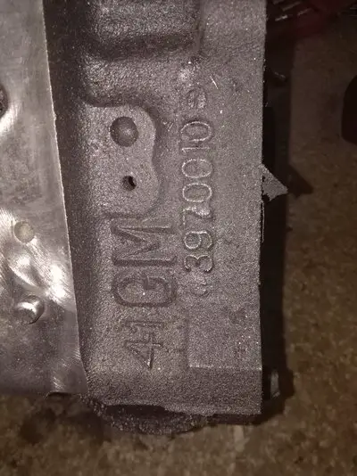

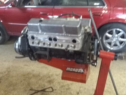

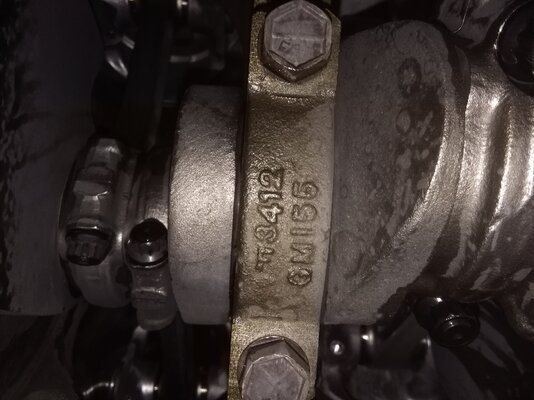

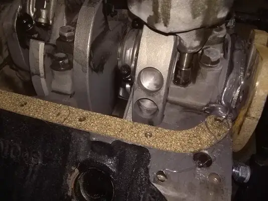

Started putting it back together. Everything tight and clean. Just like it should be. I screwed up though. Didn't get the casting number off of the rods or the crank. I have searched for the 3412 GM155 but cannot find it anywhere. Does anyone recognize those numbers? Can you tell the rod type/size from that?
