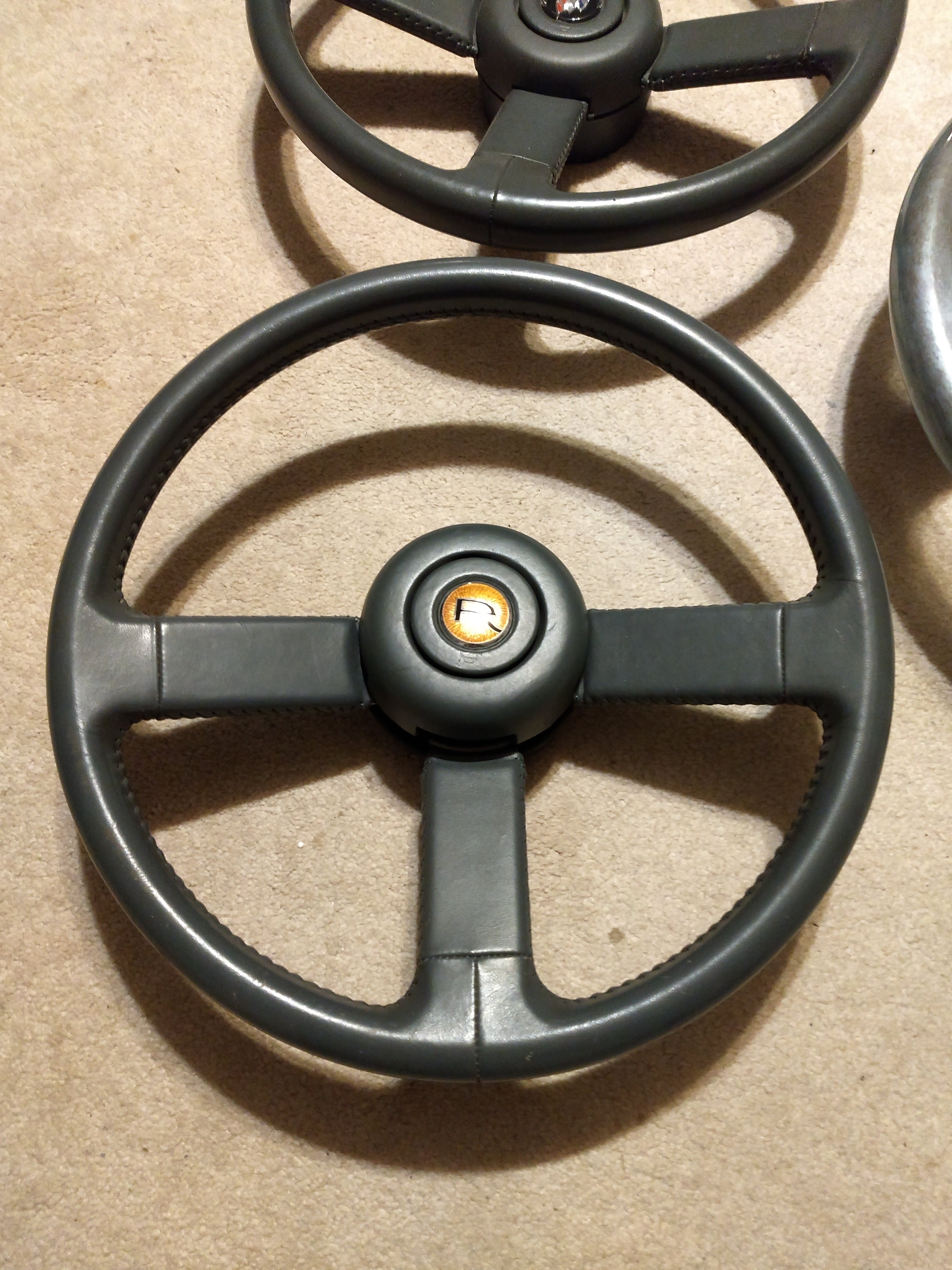

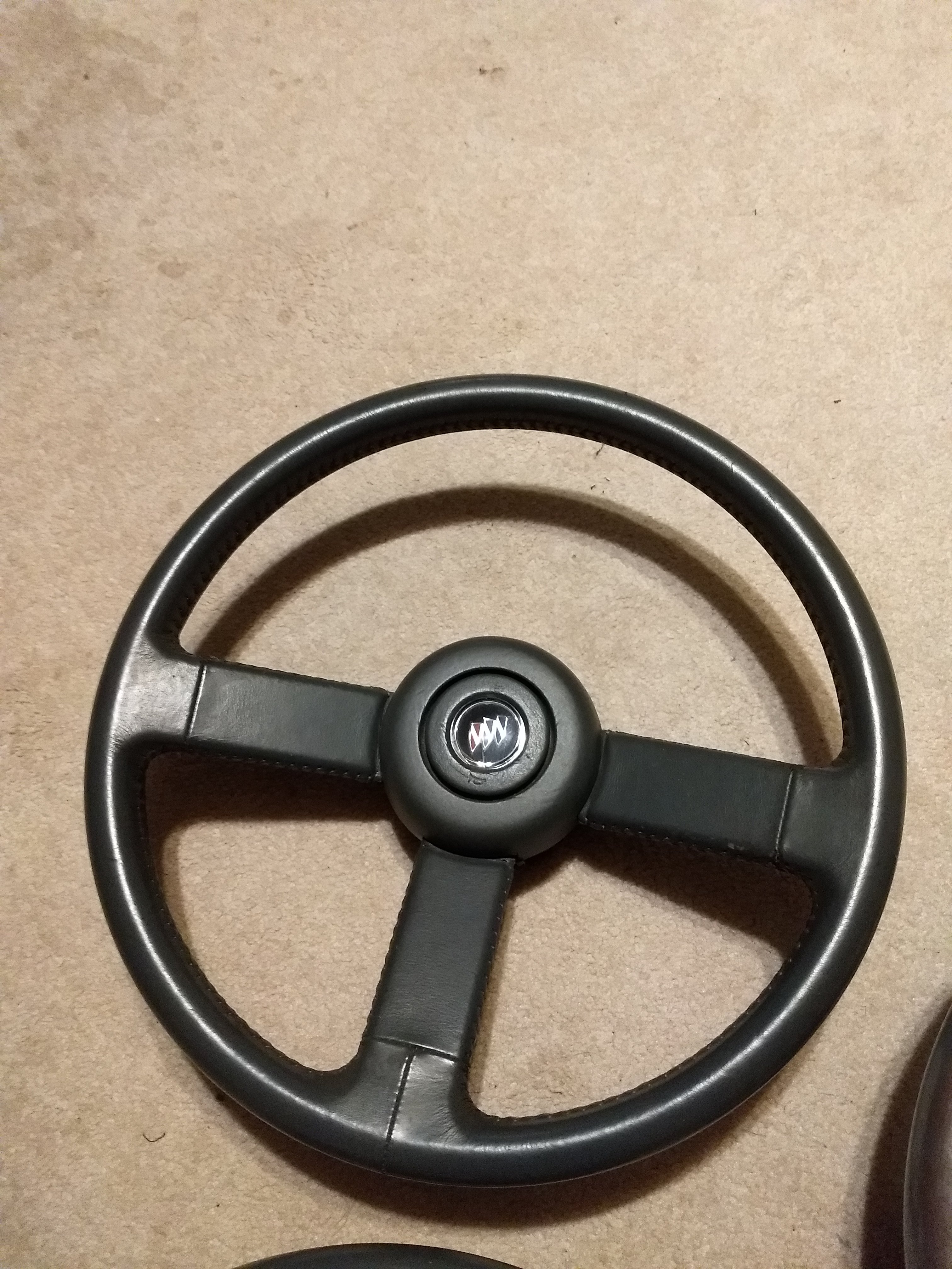

The 87 GN I purchased has an aftermarket steering wheel which I definitely do not like.
Would you guys go back with a stock steering wheel, or are there others you would consider? I like some of the other Grant steering wheels, but I am thinking maybe I should preserve the stock interior look. However I will be likely going aftermarket with the front seats for more lateral support.
Current wheel:

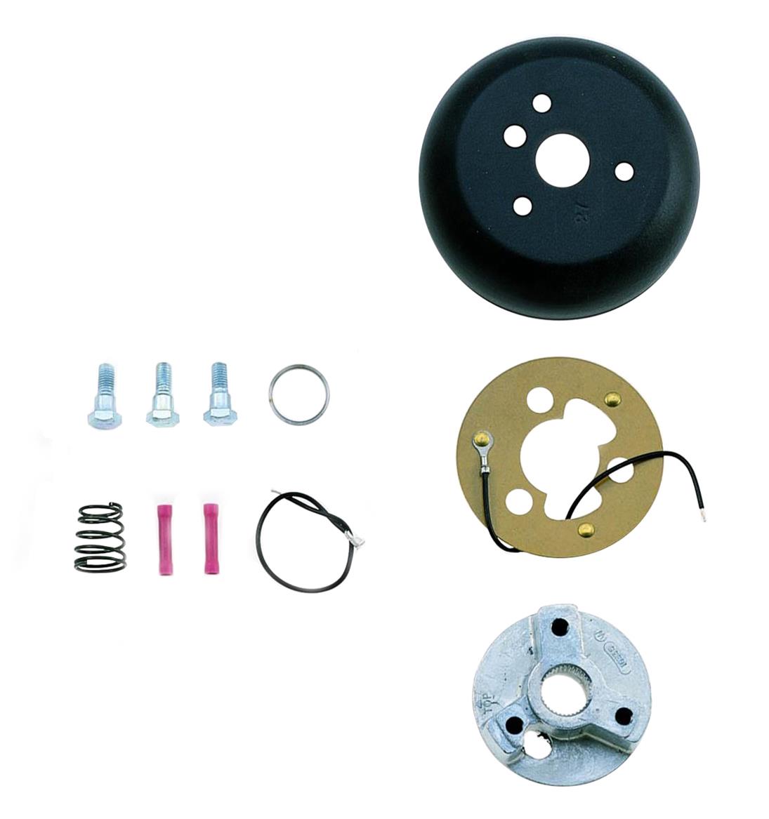

With your current steering wheel this kit should already be installed.

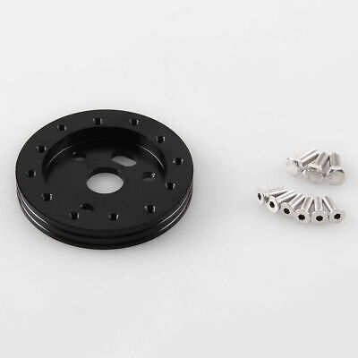

I used a 1/2" 3 bolt to 5 bolt adapter to mount the Grant Signature steering wheel that bolts to your current adapter, if you stay with a 3 bolt design like the 4 spoke you posted then it is a direct swap.
I bought something like this off Ebay the taller the adapter the closer the steering wheel is to you.

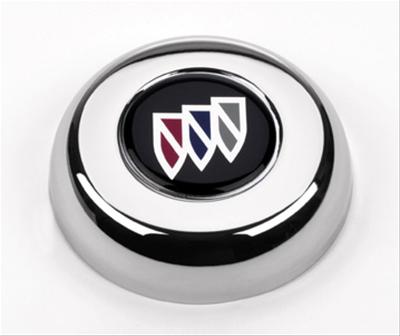

This horn button is a direct fit for the Signature style wheels
The Challenger style wheel you posted would use this for a tri shield horn.
