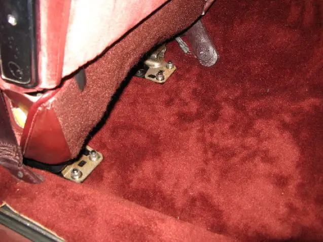

If you need more leg room like ssn696 stated you can make adapter plates to move the seat rearward which is what I did in my Regal.

View attachment 248052View attachment 248053
