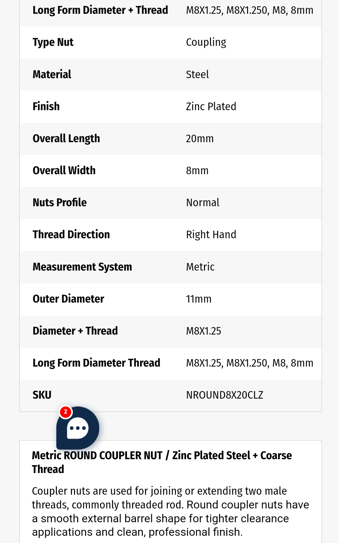

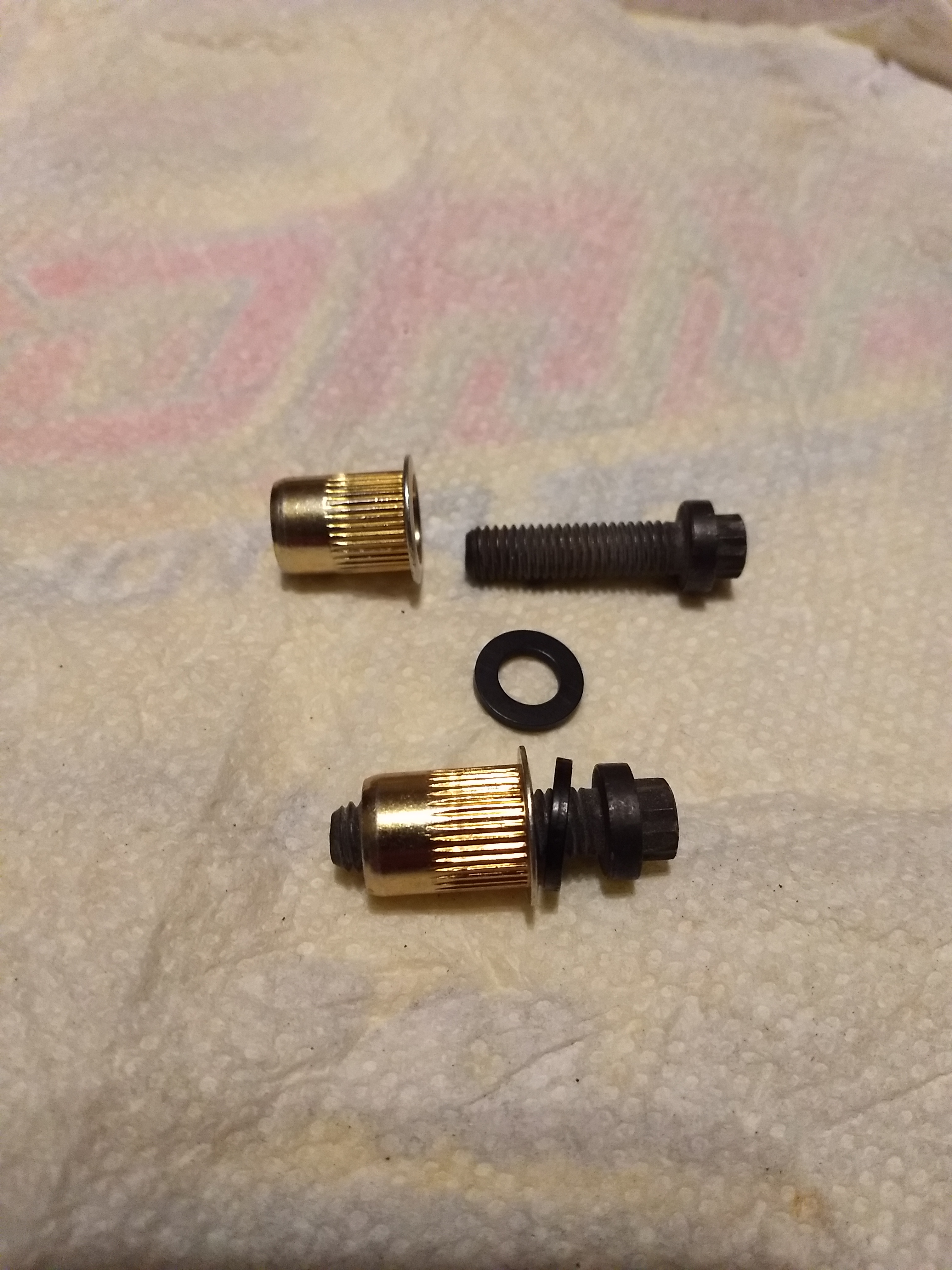

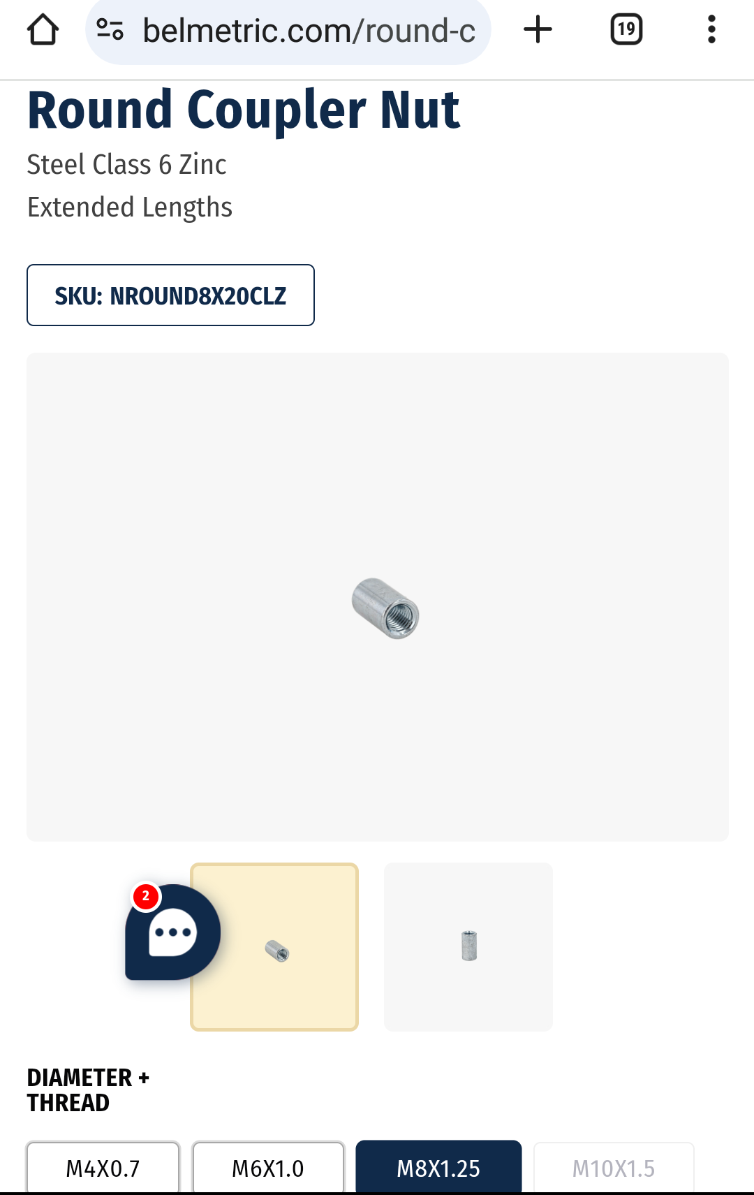

It might be perfectly fine to just slip them in and call it good, I'm certainly no expert. I'm just a little put off by the thought of a suspension part that big being used as a glorified washer for a 450# spring, and I prefer to make fasteners a one-handed ordeal whenever possible. Weld that sucker in, but drill the bolt holes out bigger and weld in threaded inserts like Coupler Nuts first. Or use Rivnuts if possible. Then you eliminate the extra long bolts as well as the need to mess with nuts on top of the C.A.. You could just weld regular/ flange nuts on top of the plate but I believe you'd prefer the shortest bolt possible. Grinding some nuts to be round, slipping them in and welding is also an option I guess.
Riv-Nut & M8 bolt:
The knurling (which collapses) on these particular ones is 3/8" tall which is enough for the 3/16" plate on my Speedway arms but may not be enough to get through a factory arm as well as a 1/4" plate.
Coupler Nut:
Riv-Nut & M8 bolt:
Coupler Nut:
