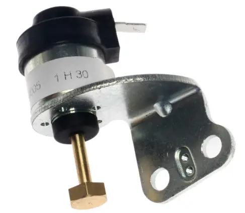

If idle speed was already set properly via the curb idle stop screw, then it shouldn't be involved unless the a/c compressor is in use. Some cars (I don't know which ones, but I know later Chevys used it) also use the ECM via a solenoid to energize the solenoid under certain deceleration events. The rubber boot is just to keep dirt, water, and junk out of the solenoid. Which could lead to the exact condition you're experiencing. Rough movement or stuck plunger is not good. Setting the idle when the a/c compressor is on is accomplished when the solenoid plunger extends and gives it a tad more throttle, you take a wrench (7/16" I think?) and turn it in or out to adjust the loaded a/c compressor idle speed. Then, when the compressor is off, the solenoid disengages. Then the idle speed screw on the body of the carb takes over it's normal duties.
Check the operation by turning ignition key on and placing the HVAC controls to either Max, Normal or Defrost. It should send 12V to the solenoid and see if it energizes. If it doesn't, check to see if it's getting 12V by checking the 12V input on the wire going to the solenoid with a voltmeter. If it's not getting a 12V signal, you need to investigate the circuit at that point as to why.
If you need a new solenoid, you could try GM p/n 17068272. If you can find one.
ES85 or ES110 from Standard Motor Products is your best bet for a new one. It isn't GM, but it should work. GM ones are hard to find, and when you do, they're usually 100 bucks or more.
ES85
ES110
Rockauto.com has it for $62.99. With the 5% rockauto discount code, you could get it shipped to you for around $70. Or search for a good used one somewhere.

Thank you for the information!
Here’s the thing about the A/C, when I got the car nearly five years ago, the a/c system wasn’t working—no compressor, no fan blower, nothing turned on when the lever was moved. It’s been one of my lesser to-do projects on the car.
