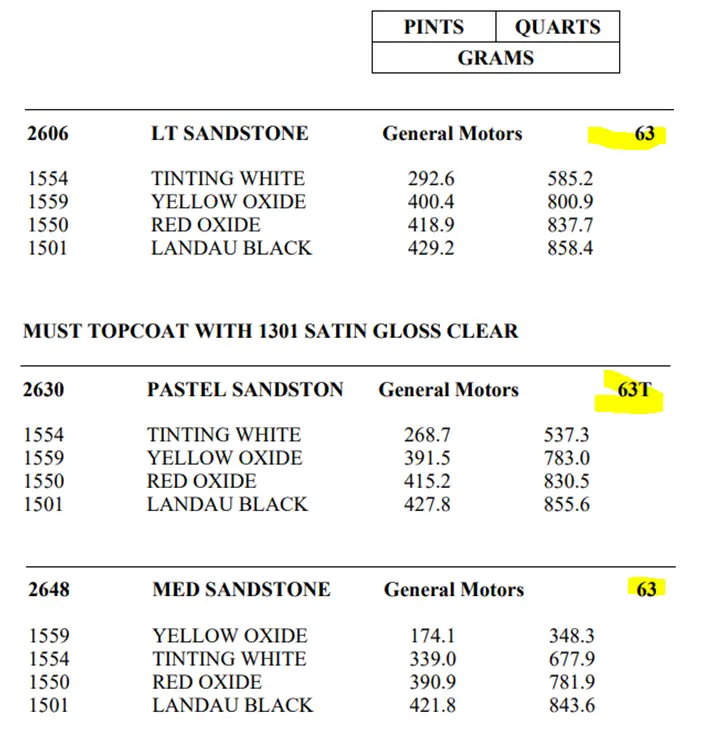

Crikey. With your help I think I have it figured out. See attached PDF, follow the bouncing ball:
GM Trim #63D5 = Dark Beige 'appointments' (dash, etc.).
PPG #63 'appointments' color name = Dark Doeskin, codes 24908, 24927.
For some reason the color chip is numbered 64 instead of 63, but name & codes match (Dark Doeskin, 24908, 24927).
SEM GM code 63, name Dark Doeskin, SEM code 2621.
So I could ask for a custom mix, or take a chance on 2621. All I need to paint is a horn pad & I just don't want to spend a ton of money to do it.

As long as you remember regardless of how good of a match there will always be a slight variance in color, I'd order a pint of the 2621 & go. As for the SEM listing has it as 63 instead of 64, they might of been going with the primary color's code since it would of came with that darker color per GM's policy for '81 dash colors. Don't for get to order all needed cleaners & prep material too so everything sticks & last.
