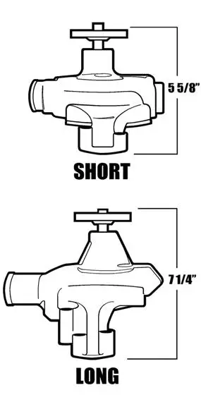

At the risk of showing my SBC-illiteracy, a stock 267 should inherently be the same as about any other old-school SBC configuration in general. However, I am not aware of all the different snout lengths, etc., on SBC pumps. Oldsmobile (my go to) mainly used 2 different snout lengths and getting the wrong one would definitely be a PITA if you didn't double check. I think Corvettes had a shorty, but can't recall. I've heard Chevy guys talk about long pumps but I don't pay much attention, so I might just be talking out of my azz.
You've got a very valid point about long vs short. It should be known the part numbers I provided are for Long water pumps.
It's harder than it used to be, but always buy "new" water pumps whenever possible. Pay once, cry once. I know that's a big ask with 50 year-old junk nowadays, but if you can get new, do that. Just a general recommendation. SBC water pumps are easy to rebuild, but usually much tougher to get GOOD rebuild kits anymore (from what I heard), plus you likely need at least a press to do it. With a press and good rebuild kit, that's one way of saving a "concours restoration" original equipment pump. However, with a stock engine of no consequence, swapping them out is usually much more time/cost-efficient.
SBCs are also mainly just two sizes, long pumps and short pumps. Stock 305s in G bodies use long pumps. There are also standard and reverse rotation pumps for SBCs, usually the reverse pumps are used with the later serpentine belt setups.

There is the "original" short pump used up to '68 on most, Vettes to '82. Next is the 1st long used from '69 to about '76 with the 2nd from then untill everything started to use the reverse flow with the serpentine set up. The difference with the 1st & 2nd long pump has a slight change caused by the change with the upper alternator bracket change. So any SBC from a 262 to the 400 uses the same pump. Like anything else, there could be a variance on the inner parts based on cooling needs with OE new but most current new & reman ones might just be the same inner parts. Pretty much they are all the same but always be carefull there might be some odd ball variance due to a special application but a general replacement part shouldn't matter.

You have A/C if I remember correctly. So it should be a long nose pump. Best thing I personally can recommend is checking the reviews at your normally used parts store. They should provide new and re-man’ed if something goes wrong or is wrong with it you can walk in for a replacement right away.

Based on your information I would assume your engine came with a long water pump stock but it's pretty easy to tell.

A long water pump in its natural habitat. Does the space between the engine block and pump look the same as yours?
