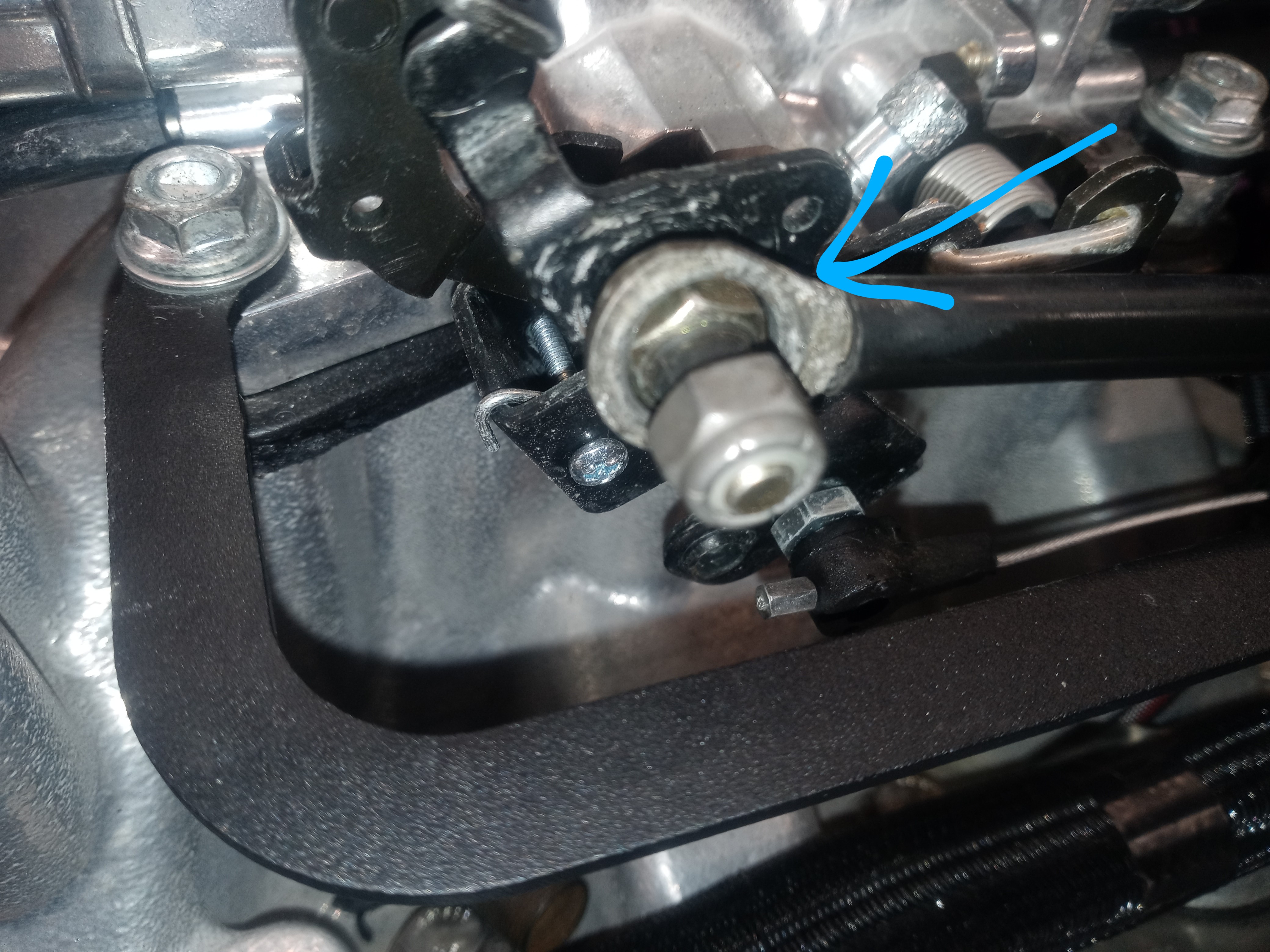

Looking for a replacement throttle cable bushing...OEM aftermarket or HELP brand...what has someone ordered and used to replace? TIA

If you're using a G-body OEM Cutlass throttle cable, you had to buy the entire cable if your bushing was trashed. Unfortunately, they never sold the bushing separate.
OEM number 25504322, which is ultra-unobtanium.
There are a couple of aftermarket numbers, though, but not sure of the fit/quality. Maybe others can chime in.
https://atpautomotive.com/accelerator-cable-y-214
Pioneer shows a part number of CA-8497
Interestingly, both out of stock on rockauto.com
Probably find them elsewhere, like ebay, etc.
