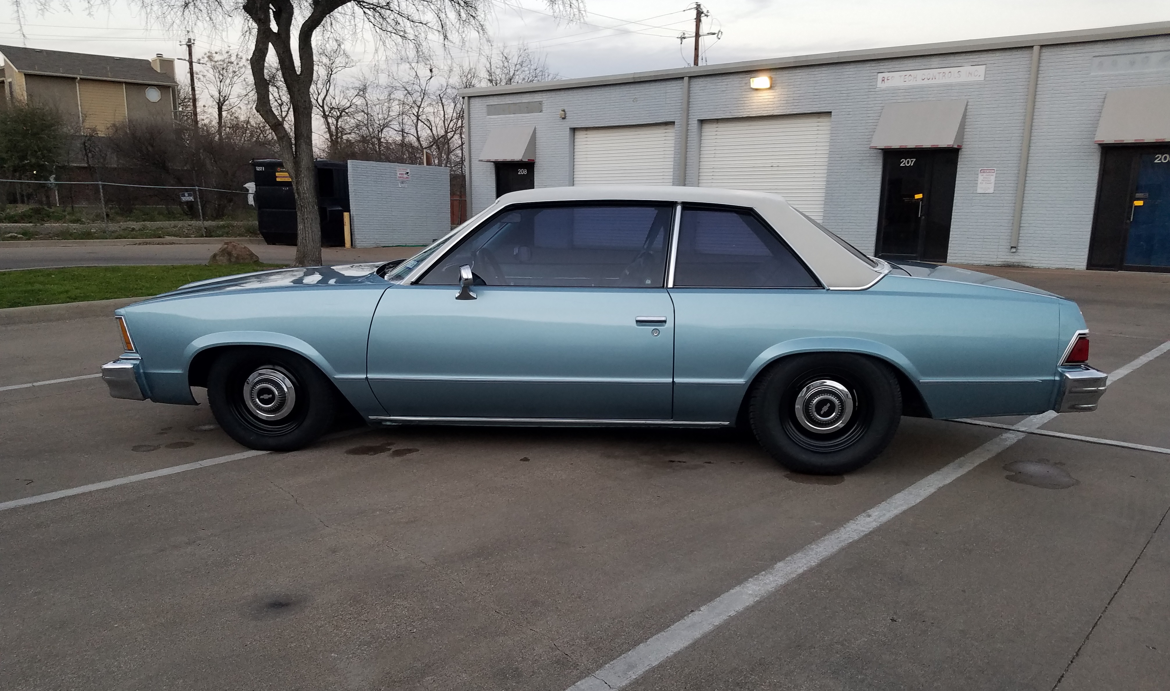

15x8; 4.25"BS, 255/60's, & at least 3" of drop. I did have to trim the lip slightly on the drivers side because as mentioned "each car varies slightly so depending on how the welders/assemblers did and how centered the rear is under the chassis". Fronts are different/smaller size.
Previous cars/El Caminos done w/similar rear set-ups didn't require trimming.View attachment 142793
