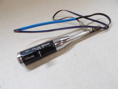

Got cruise or no? Not everyone knows what options you have on your car.
Cruise lever takes a 25031054.

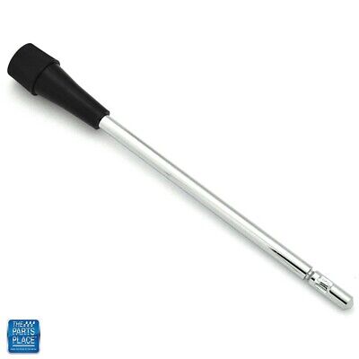

I think this is one:
If no cruise, you take 22510114. Good luck. These are like one year only deals.
If the wand is broke, you'll find a hard time getting a non-cruise one specifically for Cutlass.
I THINK they make a repro for Chevy which may fit, but I don't know. You be the judge. GM # is 467302.
