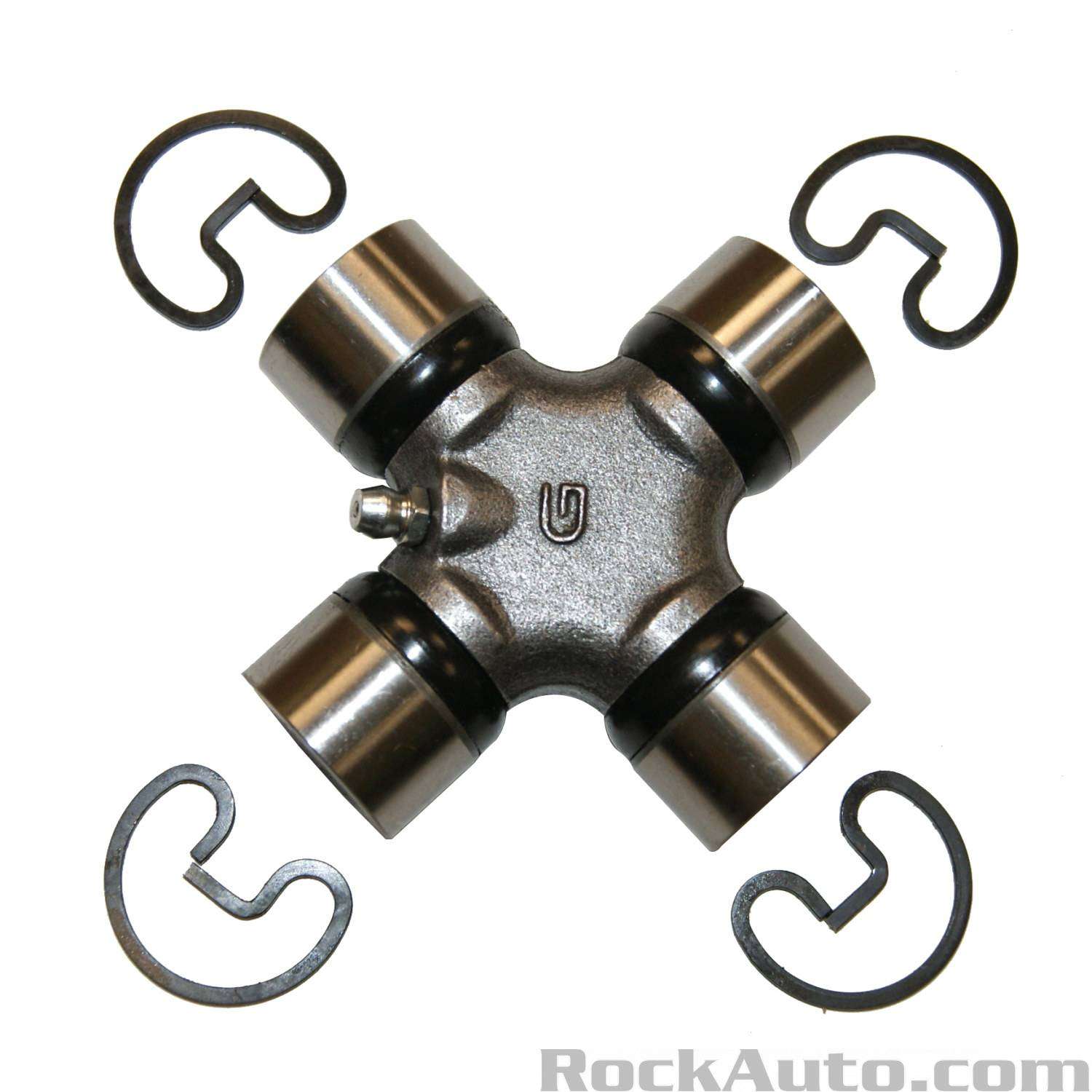

Typical GM there are two vendors for the G drive shafts Saginaw and Dana. If it is a Saginaw it uses u joints with the clips on the inside.

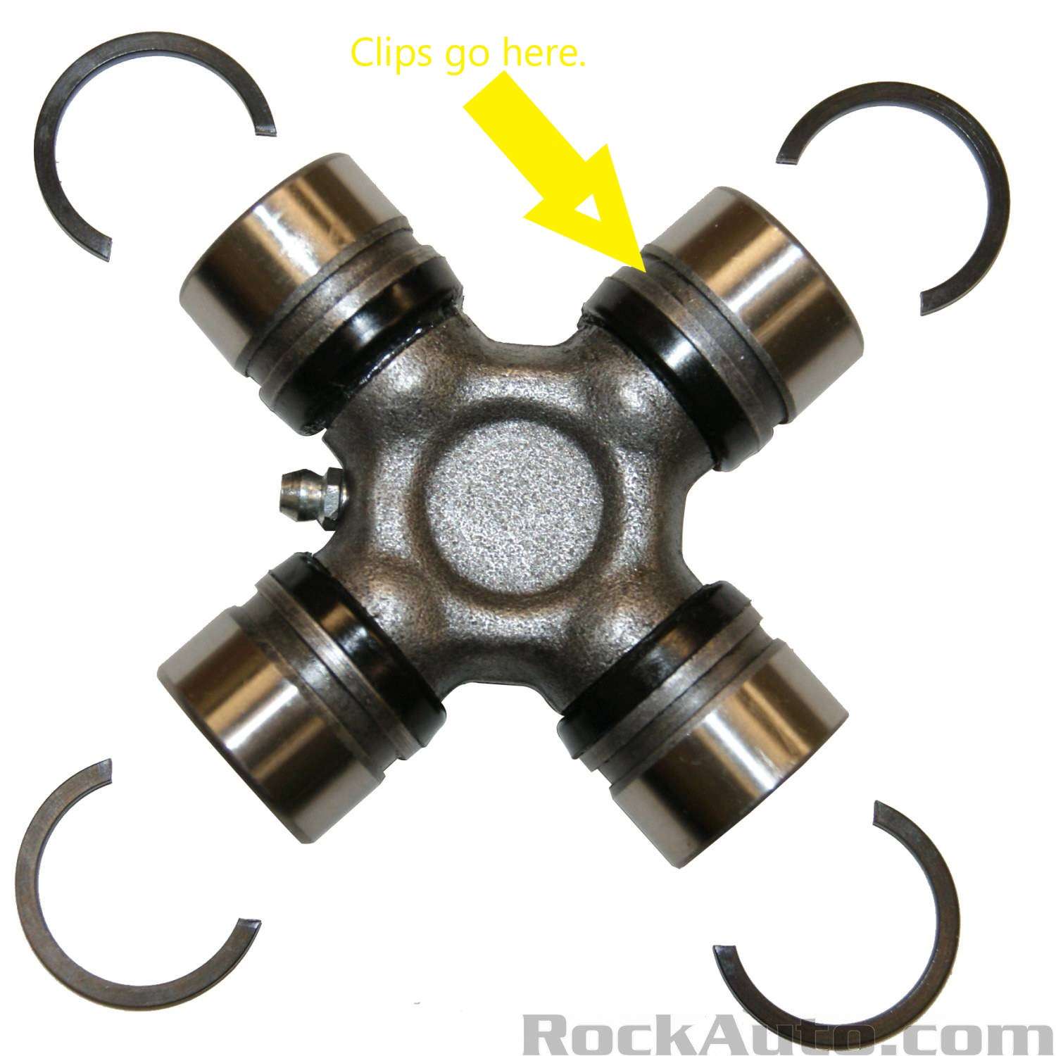

Dana the clips go in grooves on the yoke and driveshaft.
